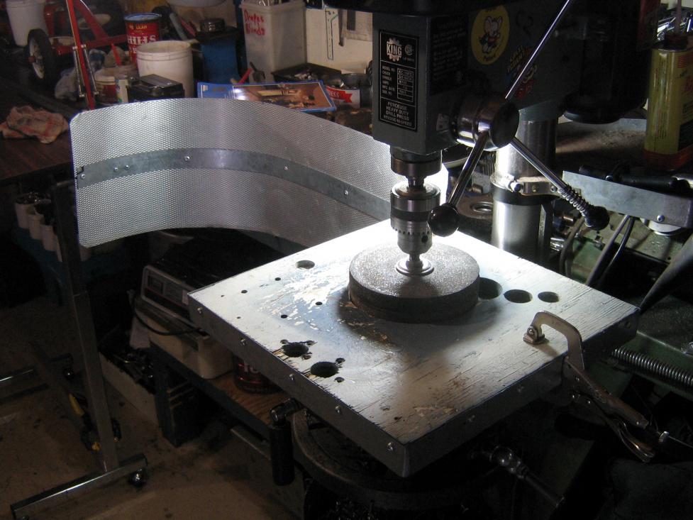

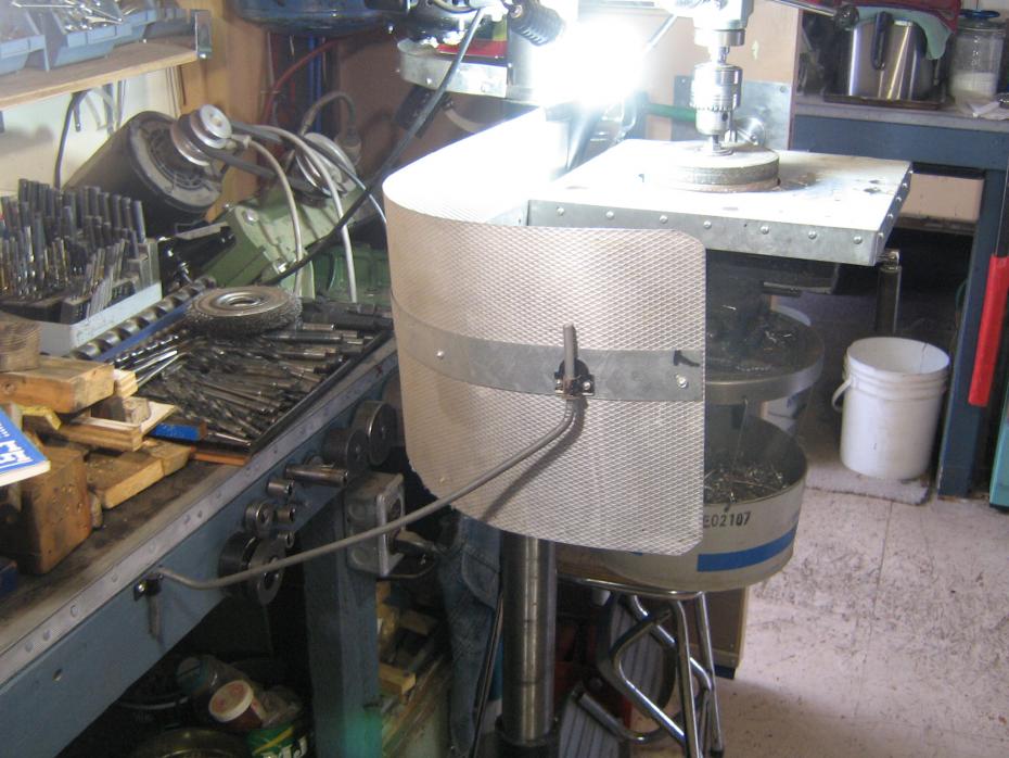

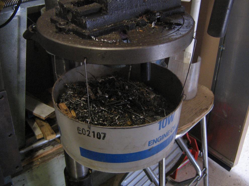

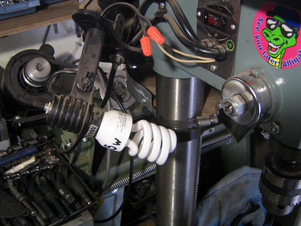

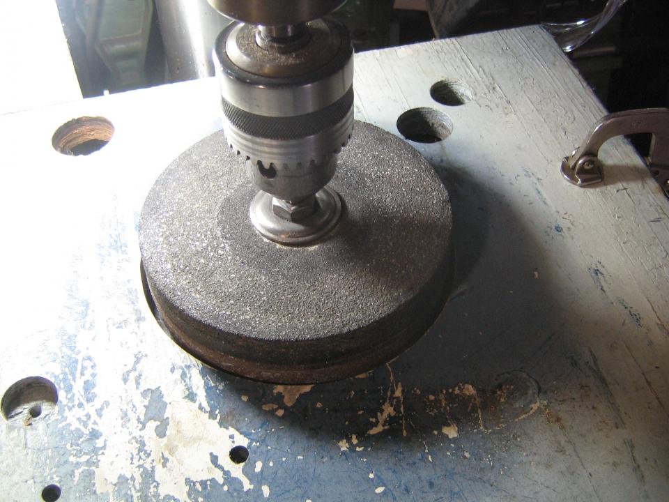

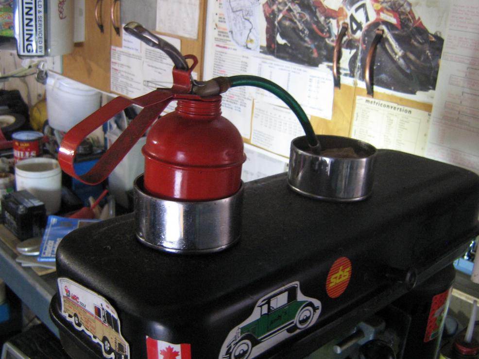

    A few add on things I've attached to my drill press, a shallow steel cup screwed to the top lid holds the oil can in place, a light placed close to the workpiece was once a cheap plastic clamp on light that broke. a drill shavings catch pan made from a 5 gallon bucket hangs below the cross slide vise, a grinding/polishing table made from 3/4" plywood measures 14" x 14" and has a hole to accept a 6" disc, the curved aluminum piece is a spark shield.
