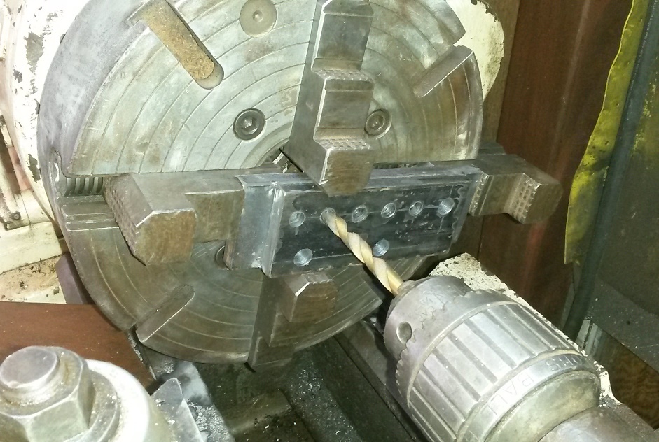

    With my mill down I needed to drill the last hole in a fixture I am making Since the hole was already 2/3rds completed I decided to just chuck the parts up in my lathe using the 4 jaw

    What? No pedestal drill?

    I have a 3/4" floor standing drill press 1 1/2 Hp with an 18x18" table 4" column. Perfectly fine for drilling most things but I never trust those baby drill presses for making fixtures. If I had either the Cleereman layout drill or the Lealand Gifford 6 head drill under power I would use 1 of them, but these small floor standing drills of mine just don't have the rigidity I feel that I need Even using a lathe for this type of work is hardly ideal

    I have used tool holders on my tool post as a vice many times this also affords me a limited amount of vertical adjustment as well or clamped a larger part to the tool post itself with a good "C clamp
    they are great for finishing out an 80% lower if you don't have a mill or other suitable ridged machine to spin the spinny tool as you called it
