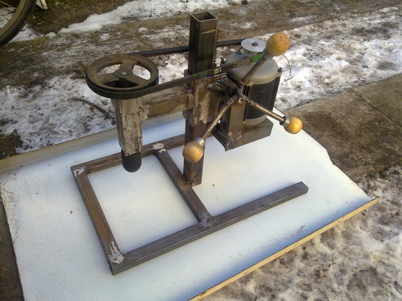

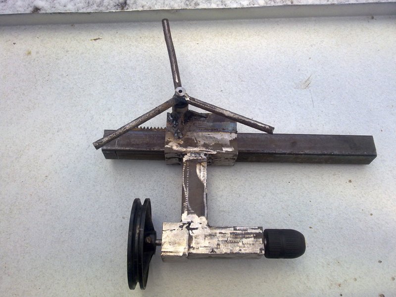

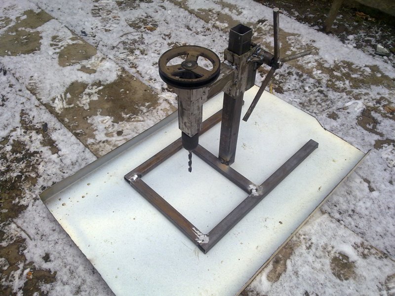

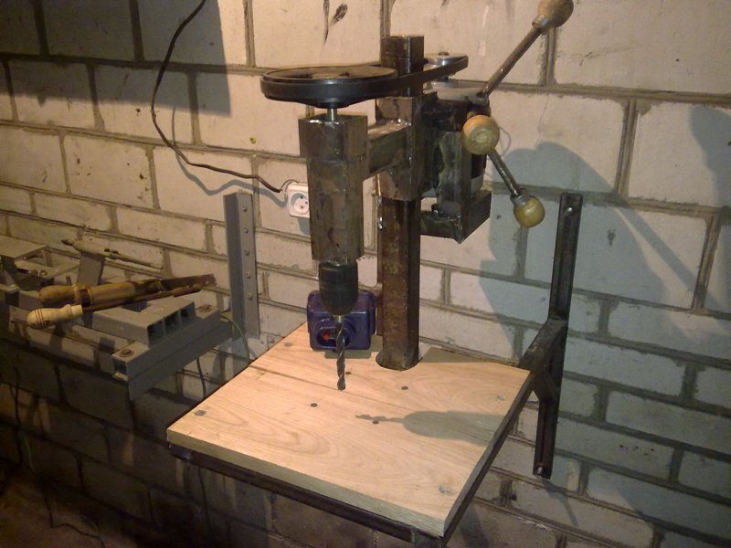

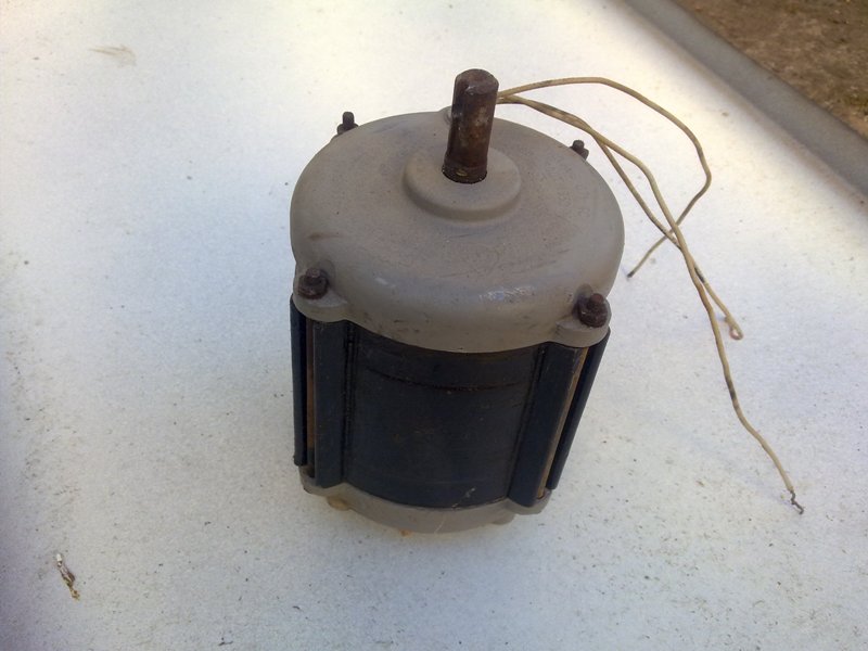

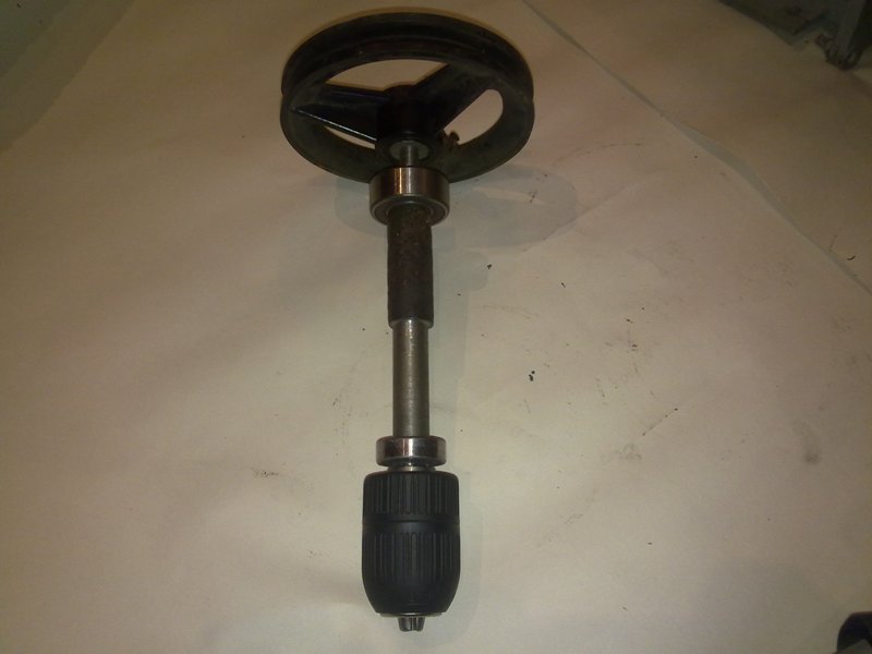

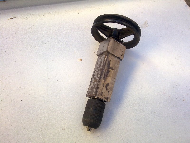

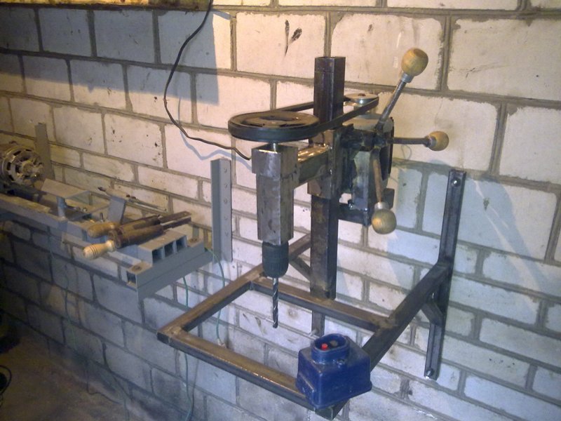

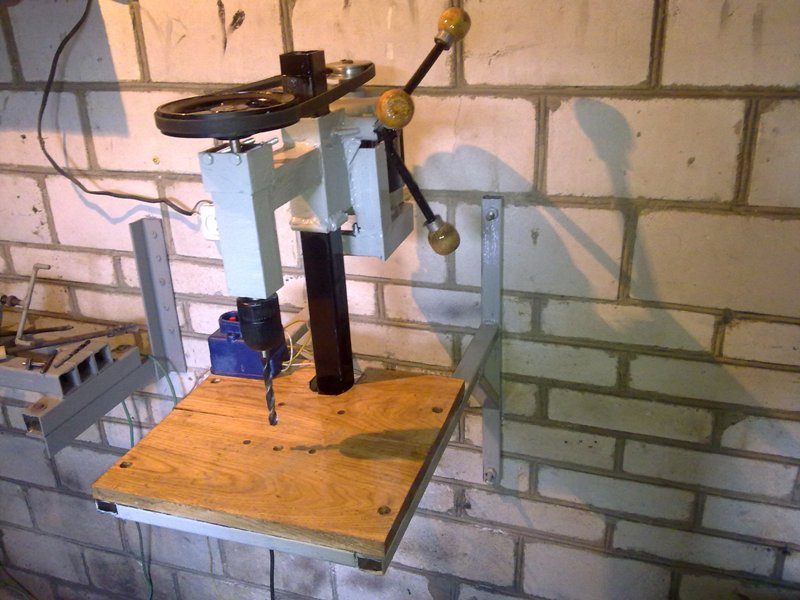

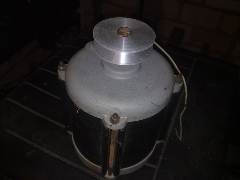

    Hi. My homemade drilling machine. The motor of the washing machine 180 watts.
    Drilling machine-00112013566.jpg Drilling machine-03122013577.jpg Drilling machine-03122013578.jpg Drilling machine-03122013579.jpg Drilling machine-03122013580.jpg
    Download plans for drilling and drill presses.

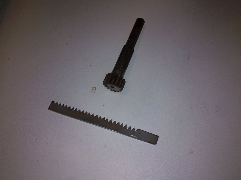

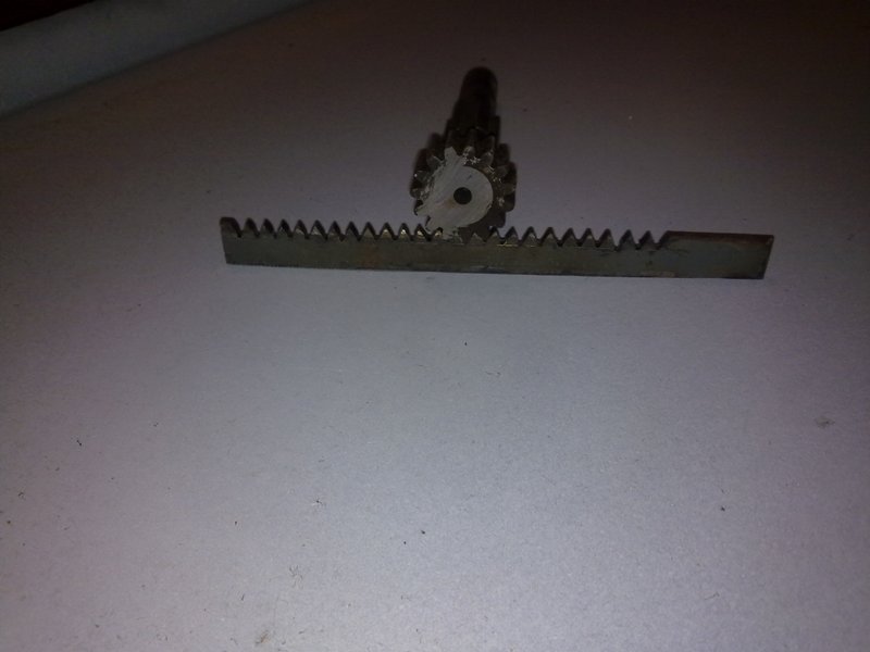

    Rails with teeth produced by this tool
    Drilling machine-05122013581.jpg Drilling machine-05122013582.jpg Drilling machine-phiolent-master-mshu1-23-230_enl_enl.jpg

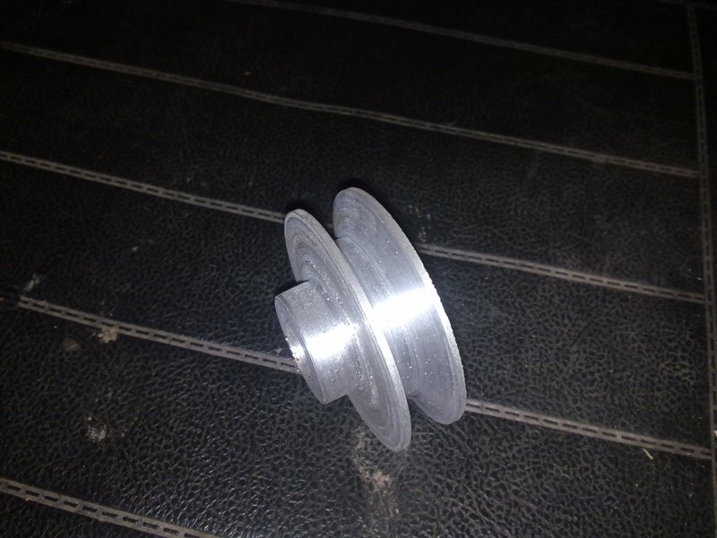

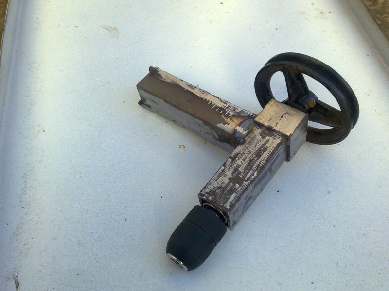

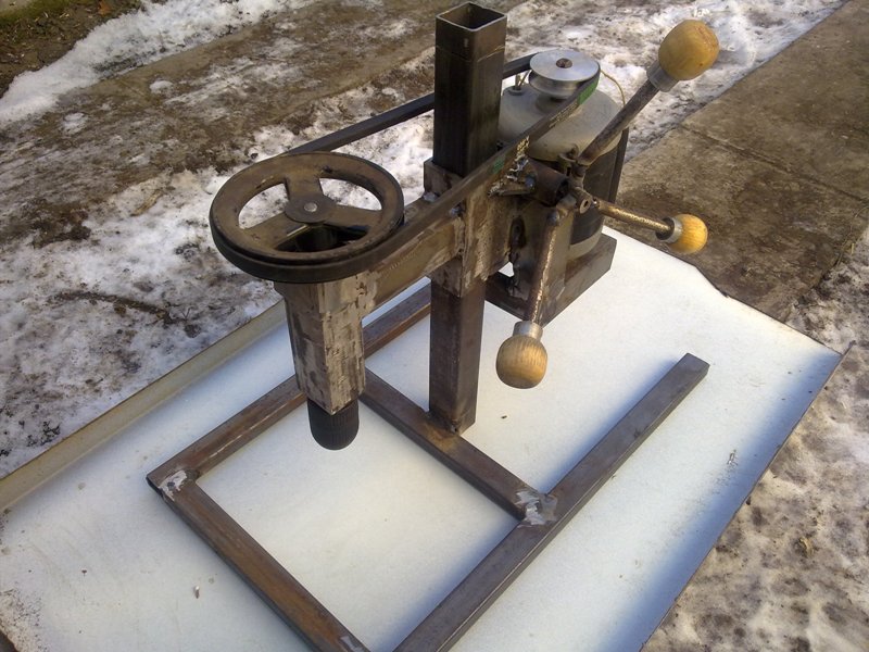

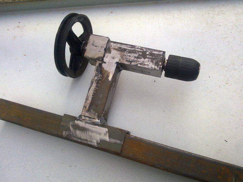

    Drilling machine-06122013584.jpg Drilling machine-06122013585.jpg Drilling machine-12122013594.jpg Drilling machine-12122013595.jpg Drilling machine-14122013596.jpg Drilling machine-14122013597.jpg Drilling machine-20122013610.jpg Drilling machine-23122013621.jpg Drilling machine-24122013622.jpg

    How well does your gear rail work? Did you make the spur gear as well? That is pretty good work with a grinder!

    That is super work. I like the design, simple but elegant.

    Great idea, and doing away with the need for a quill too.
    Only thing I would do different is to add a second cross brace behind the upright but I may be over engineering again. I just don't like relying on things welded at only one side, but that comes from being a retired class one welder, people were always trying to break welds to show us up.
    Love the build though. Hmm no quill. I might have to build one with a really massive chuck and motor just for the sake of it now. Just got to find that old Jacobs 1" chuck now, can't be far, I saw it in my shed about 20 years ago!! lol
