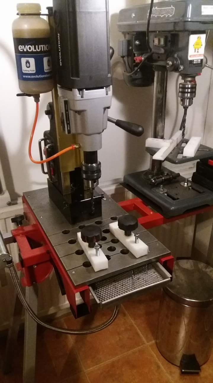

    Hi
    Wanted to get more space to my workbench.
    So i placed my drills to my old miter saw stand.
    "Drill station" / mount for the mag drill.-fb_img_1508217086949.jpg
    Drawer under the mag drill collects drilling fluid and debris.

    A beautiful idea anyone can use here is that simple crude "L" shaped block that Tuomas uses as a drill and tap guide for vertical positioning. My sound wasn't working so I am left a little mystified over the saw and blade used for cutting that heavy hot rolled steel plate.

    Quote Originally Posted by Ed Weldon View Post
    You didn't lose anything when missed the voice, i don't talk in my videos. Saw is this: https://www.amazon.com/Evolution-230.../dp/B002UTPCZM
    Cheaper option is to use 7 1/4" steel blade : https://www.amazon.com/Evolution-Pow.../dp/B002M9D2PM
    In this rage 185b model. It comes with multiuse blade that cuts steel too, but multiblade is little slower when cutting steel. But, it also cuts wood and plastics. Works specially nicely with alumine.
    https://www.amazon.com/Evolution-Rag.../dp/B01N640SBJ
    Note that, evolution saws uses slower 3200rpm speed than regular saws.

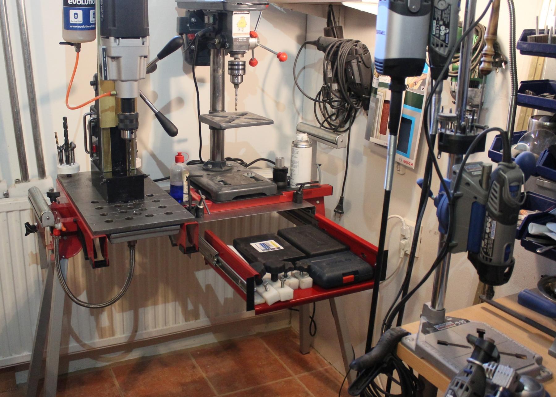

    Continued with this:
    "Drill station" / mount for the mag drill.-1.jpg
    Made a drawer where to keep clamping gears and stuff. No front- or back plate to keep it easier to clean.
    Made from left over sheet metals. 2mm mild steel, 1,5mm acid proof steel (upper part) 8mm flat bar.
    Bends made with my diy brake and riveted with steel pop-rivets.
