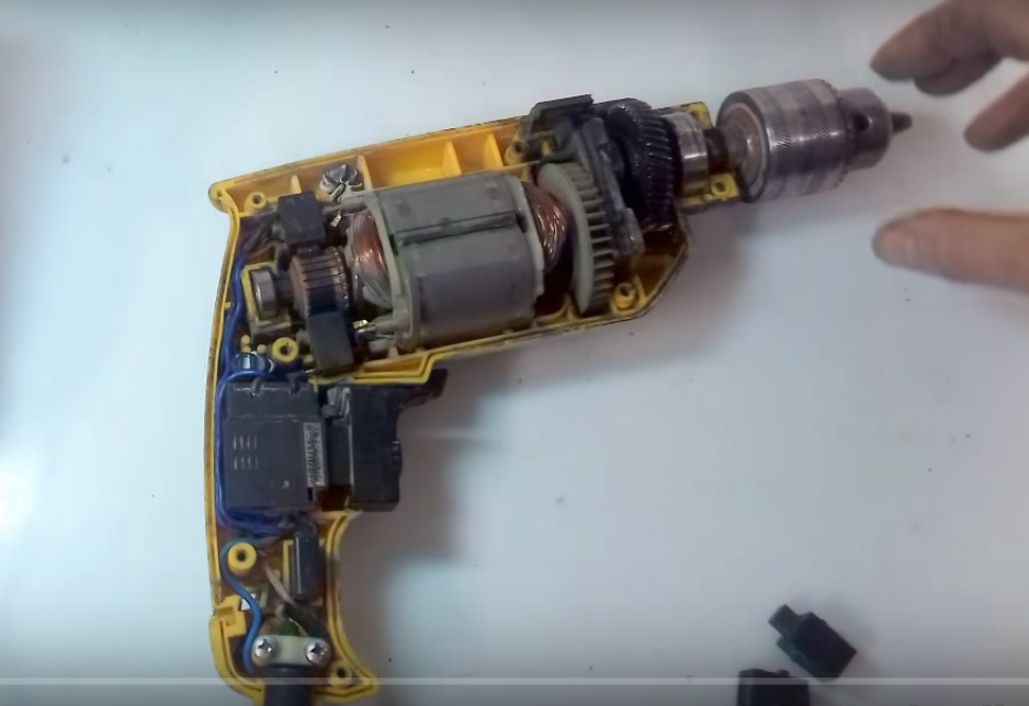

    DRILL REPAIR AND MAINTENANCE

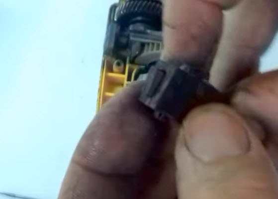

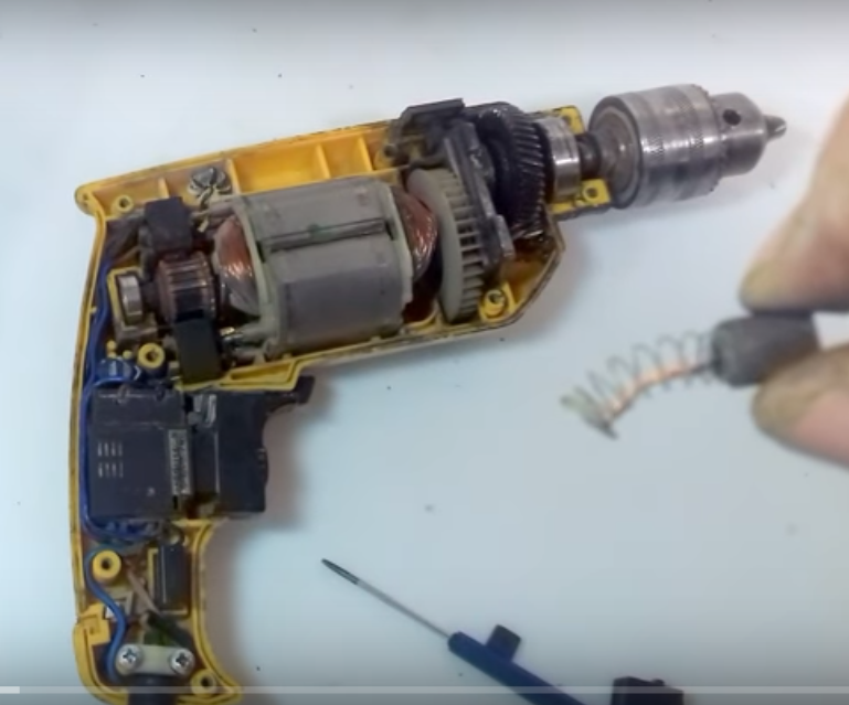

    In this video you can watch a repair of a cheap drill. If the damage is at the cable or at the brushes we can easily fix it very cheap. We can find new brushes very easy. Usually we can find a pair of them inside the drill box when we buy it .
    If there is a cable cut , we fix it. Sometimes when we use the drill very often at the hammer position we find damage in the end of the coils. We can join it again very easy.
    If the damage is inside the armature or in the stator coils and the drill is cheap we drop it. We do also the same if the damage is inside the trigger.
    If the drill is expensive we can order the destroyed part and replace it.
    Thanks for watching.
