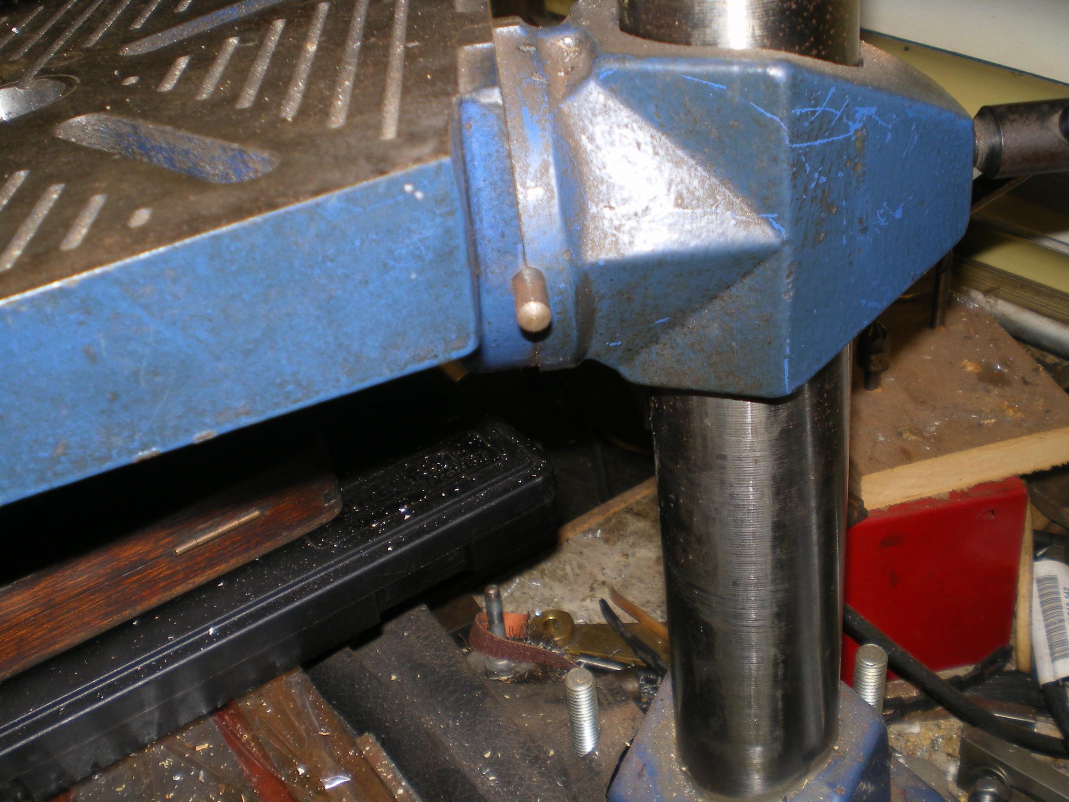

    Having gone to a lot of trouble tramming your drill table as I once did, If you do need at some point to tilt the table to save having to repeat the process you my be interested in my fix.
    It is simply a 6mm dowel in a drilled and reamed hole on the centre line of the tilt joint, it has worked well for me and saved a lot of time.
