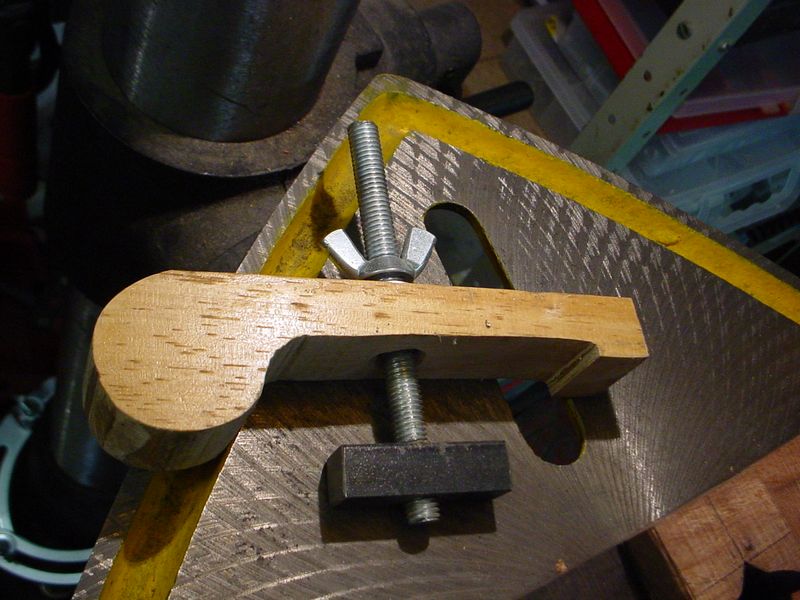

    Here are a couple of easy to make but very efficient quick release clamps for the drill press table :
    To remove them quickly, you just have to loosen the wing nut, then give a 1/4 turn to the rectangular nuts and they can be pulled out through the table groove.
    Cheers !

    Yes, it does look like a versatile design. Thank you for the idea.
