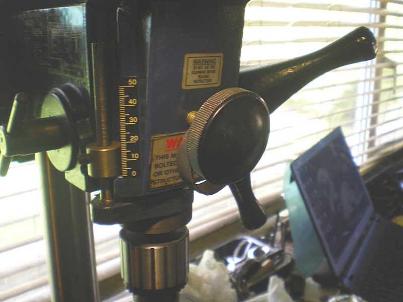

    Hi bricolage
    I had a similar problem with my inherited Record bench drill (a lot of budget drills have this defect). I have drilled and tapped the head for a brass padded bolt to put drag on the quill to take up the play when needed, it also serves as a lock. It is a bit of a bodge fix but it works and could be refined to a spring loaded device, but at least it makes a worn machine more usable.
    I hope this helps you in making those beautiful miniature chairs.

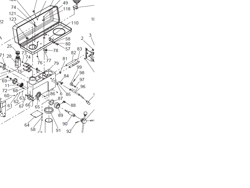

    Bricolage, I know your not looking at replacing your existing DP, but if you were, Harbor Freight has a 20 inch DP that has a slit cast iron head stock, with 3 adjusting bolts to take the slop out of the quill movement. Price is $580.
    Cap screws 66 and 67 in the above snap shot from the owners manual from their web site shows this adjustment.
    I've owned this model for more then 25 years. I've also replaced the junk drill chucks with keyless that have less then .0015 runout. It has a MT3 taper. The only issue I have is the slight bit of slop in the quill rack/pinion, but all drill presses I've used have this problem.
