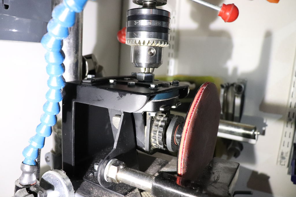

    Here is couple pictures.
    If you watched the video.. you might wonder why there was that plate stripe bolted to the casing?
    Its for holding the rubber flap that keeps dust away from the bearing.

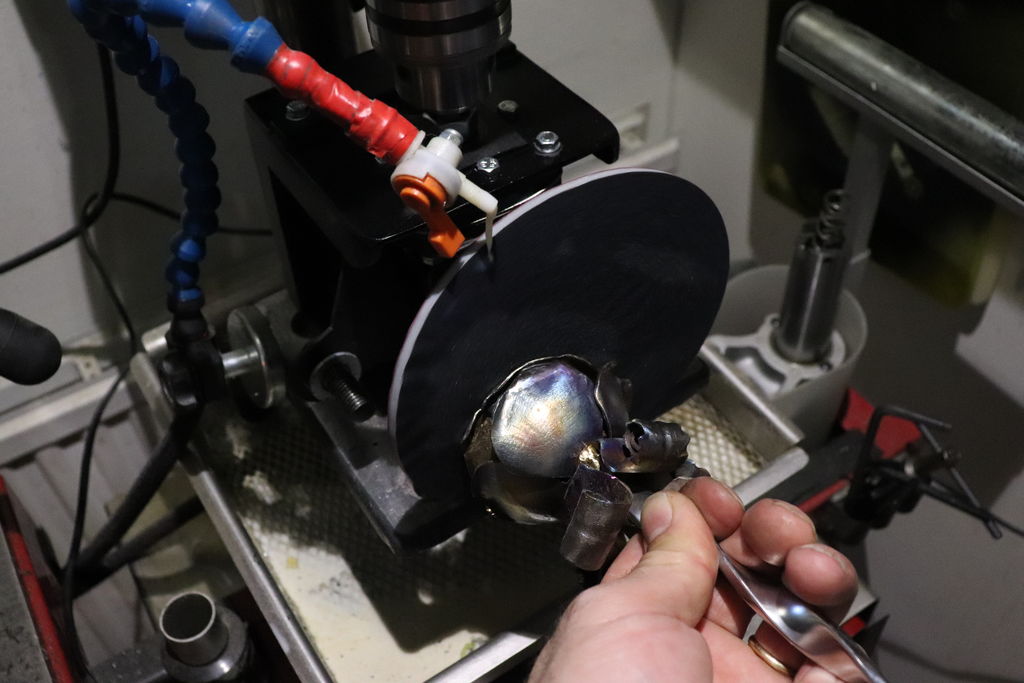

    And here is where i use it mostly..
    I can use my cutting fluid system for wet sanding too.
    I had no suitable machine for this purpose before. Now i do.
    Too high rpm ruins sanding pads and throws water everywhere..
    Low rpm needs bigger torque, this gives it.
    I can use this with rpm 50-600 with my drill press ( drill press spins 250-2700rpm). Its suitable for accurate and precise working. Imo.

    I did some wet sanding today, and it really seems to be usefull.
    Also polishing plate edges steel and acryl is much easier now. Straight, shiny edges. I like. �� Also wire brushing is much better now. Bench grinder spins little too fast. I am very satisfied.
