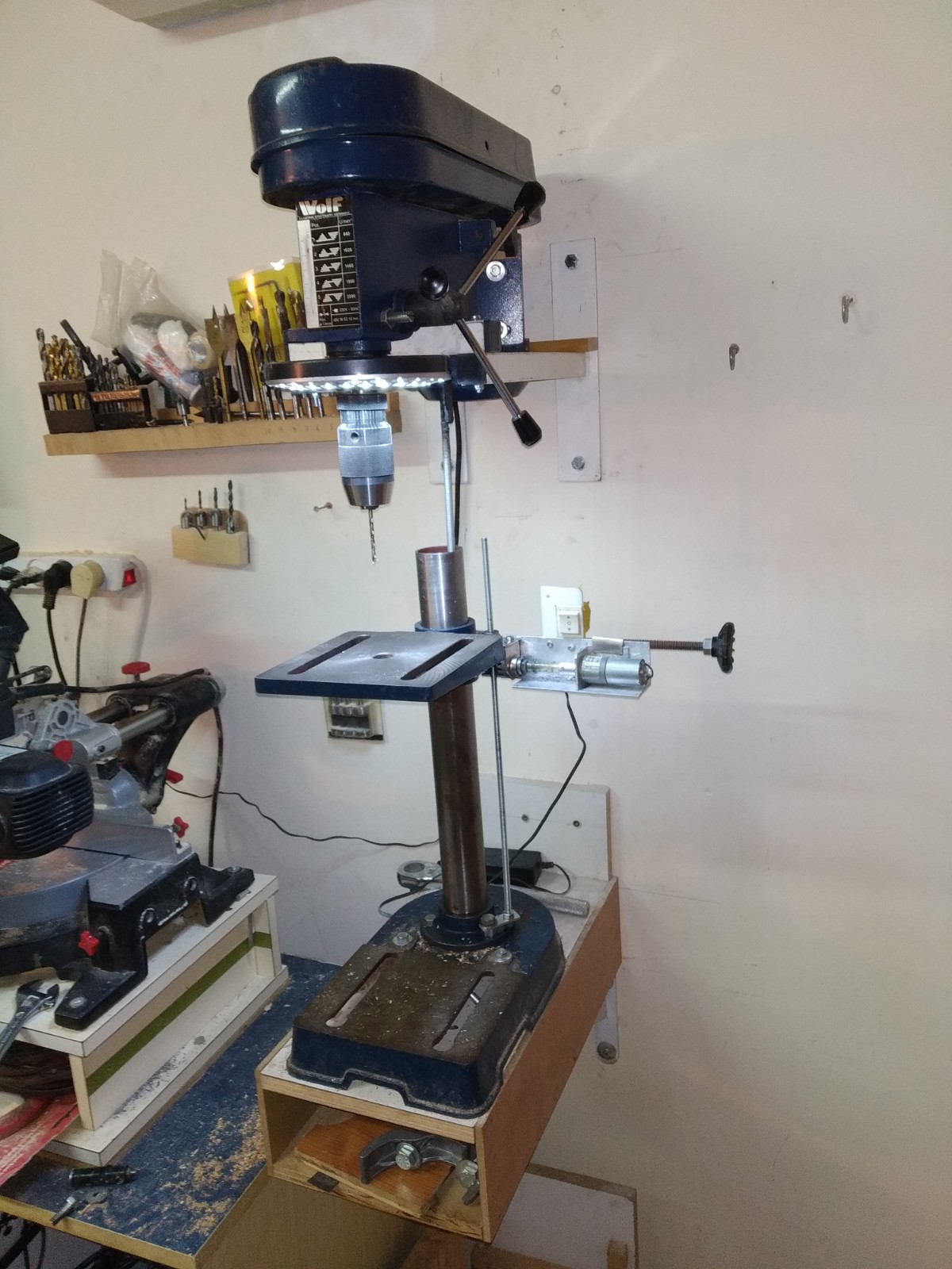

    Using a table drill-press can be annoying when dealing with fairly long pieces, longer than the limited space found between the bit and the drill-press table.
    I could not find a longer tube with the exact diameter of the one which came with the machine (unless you buy in China some tons, produced especially for you…)

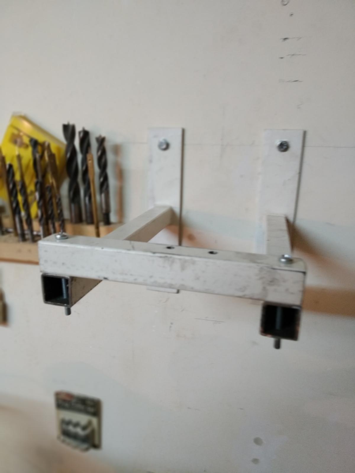

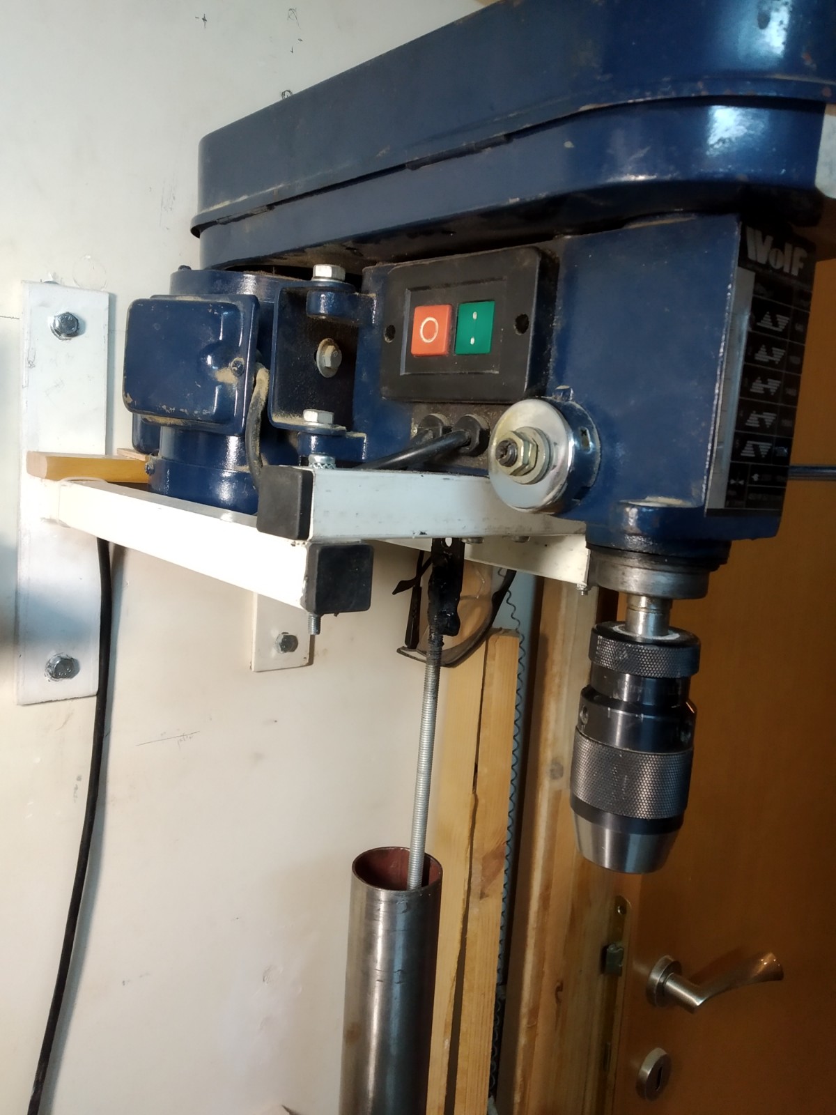

    So, this is what I did: from a drying rack for laundry – or was it a bathroom-sink support? – I salvaged two T-shaped metal frames, and hung them to the wall, above the drill-press. Then I detached the "head" containing the motor and the pulleys and fixed it to the frames, thus gaining valuable 28 cm! A threaded rod connects the base to the top and prevents distortion while drilling and pressing down the bit.
    Drill-press improvement: when every centimeter counts-.jpgDrill-press improvement: when every centimeter counts-.jpgDrill-press improvement: when every centimeter counts-.jpg
    I then re-installed the table-lift previously made, shown here

    some good ideas there,,, but removing the headstock from the shaft is not one of them,,,drill presses can be very dangerous ,,,,dont do anything that makes it more dangerous... they do make and sell plenty of floor mount drill presses online,, please get one,,,,and thanks for not making a 22 minute vid..
