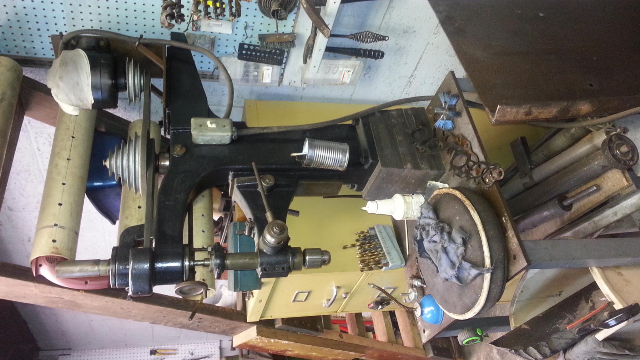

    With the tube I used a 2in black plumbing pipe scrap and ground the casting out to fit. I wanted a little more height and strength. Maybe that might be useful to you or maybe the models are too different. Those radial head drills are really neat and useful, it makes me wonder if the right combination of plumbing fitting might turn a hf model into one
    here is what I want to adapt your idea to. not much original parts are left on it no badges. there are some bearings on it from 1904. just need to pick up some new calipers or batteries as both cost almost the same

    Nice old Iron Jere, a beauty. Thanks so much for sharing you pic!
    I thought about black pipe, easy to find but the size of mine is 2.56 (65mm probably) and black 2" sch. 40 would require bushings both ends, 2.5" turned down on the ends would only leave about .090 left at the ends, but .200wall would be awesome...to use pipe I think it would need Sch. 80 which would be a hunk...but solid! @¿@ Interesting thought on making a radial from one but the cast head would be cumbersome and limit rotation...with a heck of a clamp! Did think of filling it with concrete but longer would be nice. Don't feel confident to grind out the head and base...straight. I'll keep looking till something strikes me...thanks for the thoughts.
    As for your beauty, it looks to me you could anchor a plate on the front pinch clamp bolts maybe and use either my hose clamp idea or what ever you can whittle out for the spindle. How much throw does it have? Also is that a fine adjust wheel on the front of the spindle?...if so that is Sweet!! Love the slider cast on to the base...serious solid. Amazing bearings still running for 111 years, how many revs have they spun in that time...Awesome! Coupons, Coupons, Coupons...the HFT way! ~¿@
