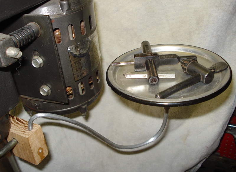

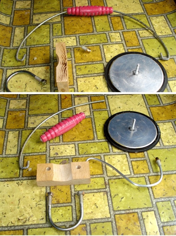

    This accessory tray was made by reusing a coffee maker warming plate and a bucket handle. A scrap wood is attached to the drill press column with a U-bolt and supports the tray.
    It is useful to place the chuck key or those accessories of the drill press being used, like drill bits, countersink bits, cutting fluid, layout tools, etc. The tray swings out of the way, but keeps tools within reach. This way, no matter how crowded the workbench is, you always have a place to put these accessories, and most important, you always know where to find them.

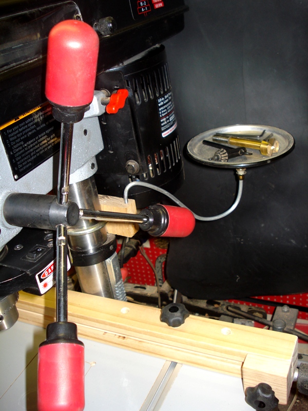

    There are commercial trays (https://www.google.com.mx/search?q=d...Hb-5D1IQsAQIIQ), but they can be made in the workshop.
    By the way, that tray was made in May-2014, and although the old drill press was changed, the tray is still in use.
