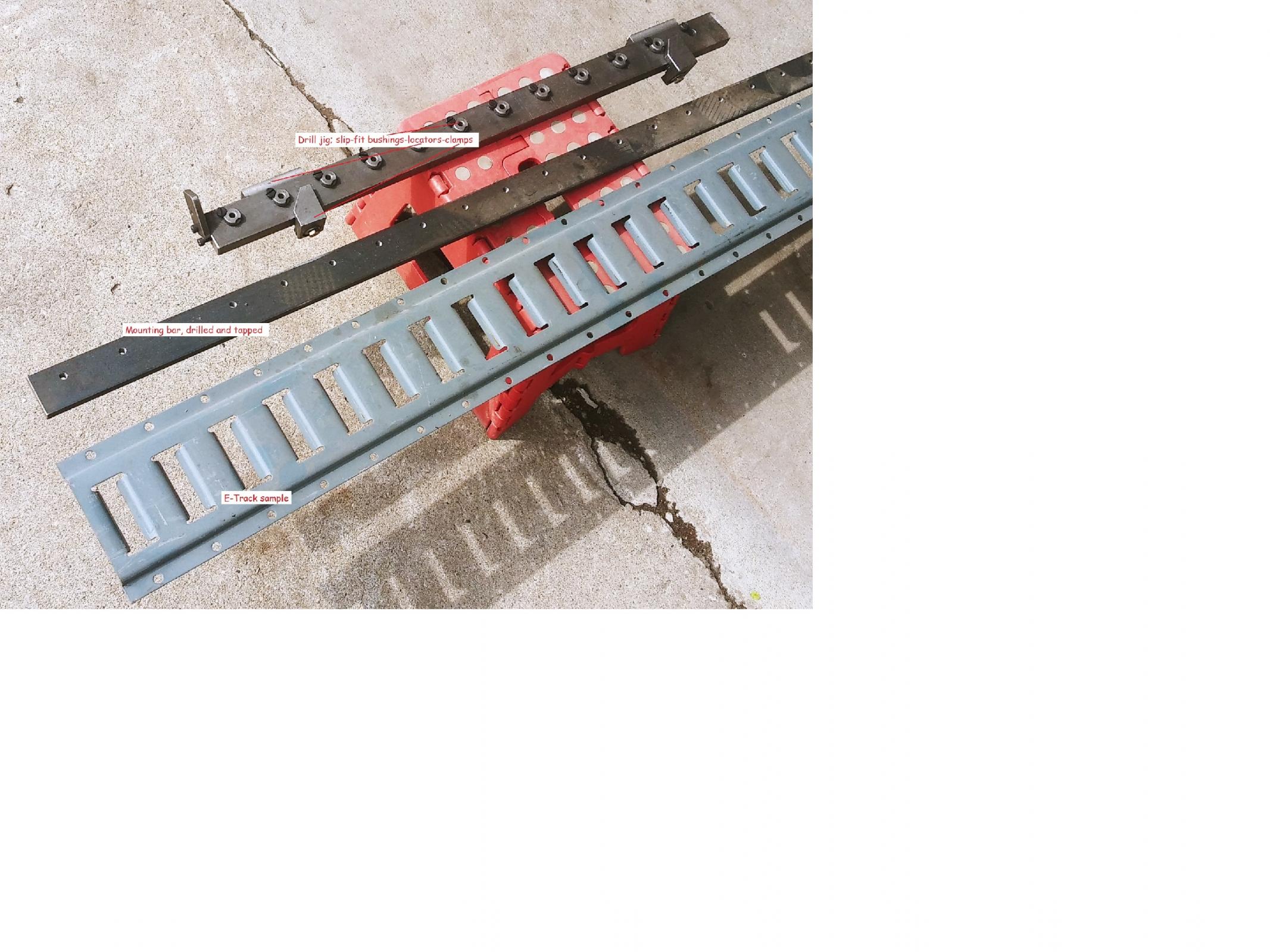

    • Finally became aware of E-Track. These are 4" wide strips, with punched rectangular slots for attaching tie-downs, spaced on 2" intervals. They are attached by welding, or screwed to insides of box trucks. Typical mount is horizontal on those walls, but nothing says deck mounting wouldn't work.

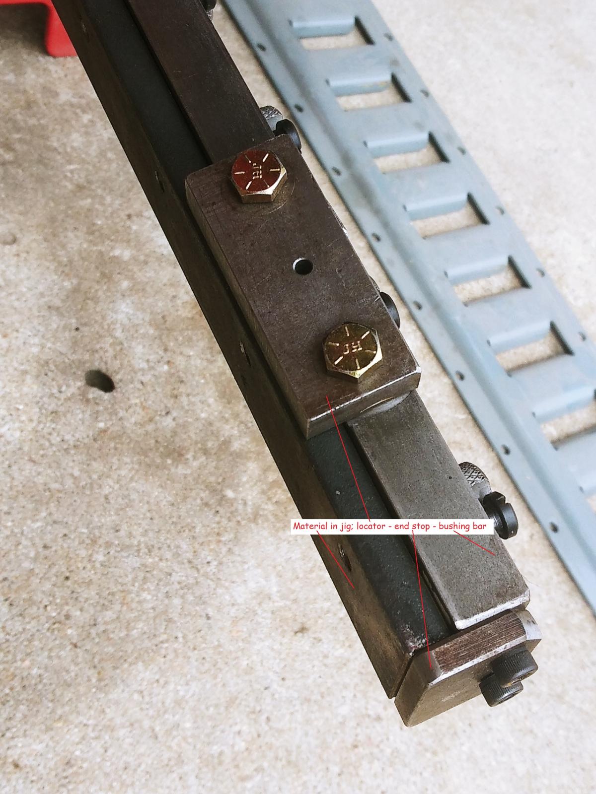

    • In this case, preference is bolt on. The strips are 10' long, 1/4" holes spaced 2" centers in both edges, trailer didn't have any material 4" wide thick enough for good thread engagement. My solution welds two strips [four total] 3/8" x 1-1/2" hot-rolled; one to upper angle iron, other correct distance below. That 3/8" matches 1:5 diameters of 1/4-20 engagement; with 1/2" long screws through lock washer and material.
    • All well and good? Yup, once I solved drilling 240 correctly spaced #7 holes, chamfering each side, then efficient tapping of 240 locations.
    • Go ahead, say it; ALRIGHT ALREADY, or FINALLY! Your choice........

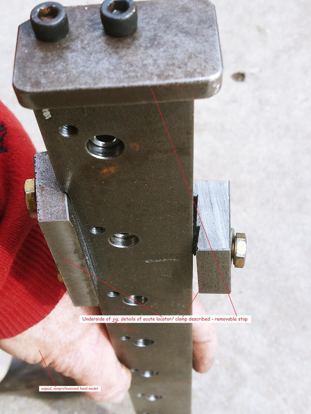

    • I bored this cold rolled bar on 2" centers, same distance from edge as E-Track. Two areas were milled-drilled-tapped acute angle as clamp pads. There isn't a right vs left issue, not even a true upper vs lower. So, only one jig required, running through holes, not blind.
    • Why? Hot roll bar has convex edges, not a reliable clamp surface. Using protractor, demonstrated angle to grip beyond (under) high point at lower corner. \( Opposite those pads, at same angle are clamps themselves )/ Who knew punctuation could stand in as drawing details?
    • Now, in use. One end mounts a swiveling stop, locating initial of 12 holes. Upon finishing 12th spot, loosened clamps and stop, slid jig along material and located 12th hole to 1st bushing with #7 drill shank, re-tighten clamps and proceed drilling next 11 holes until end of bar.
    • Took 40 minutes each, clearing table, setting up stock rollers, mounting drill bit, lowering head minimizing space to material, brushing cutting oil, drilling holes. Chamfer and tap ops were guided by a rail clamped on table, registering main centerline. Counter sink or point of tap did the rest.
