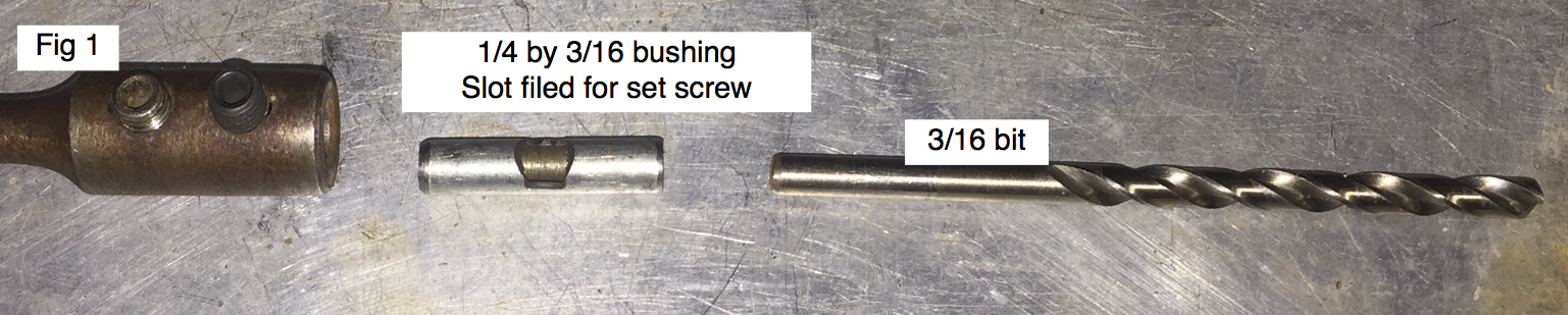

    I had two 12” extensions that accept 1/4” shank bits. Typically spade bits and used for roughing residential electrical wiring.
    I found some 10-32 button head machine screws in my screw drawer that require 3/16 hole. Fig 1 shows the small adapter bushing I made to hold the 3/16 bit in the 1/4” extension.

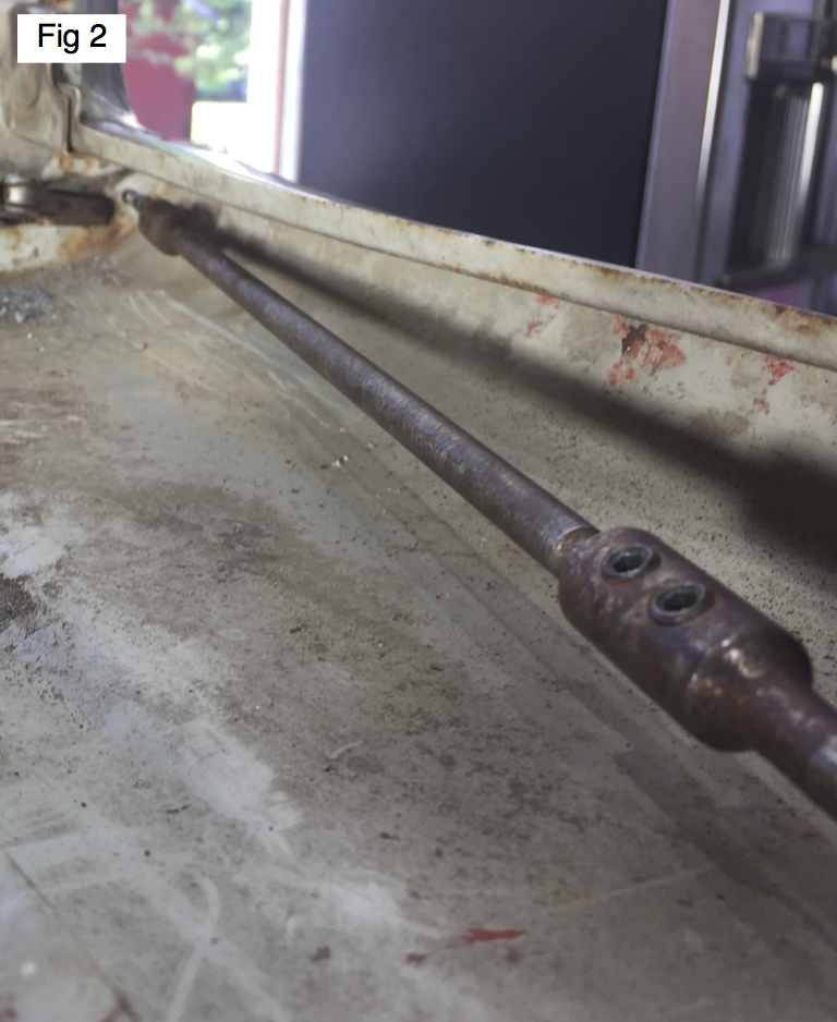

    Fig 2 shows the tight space I needed to work in. It took two extensions to get the drill in to a good spot

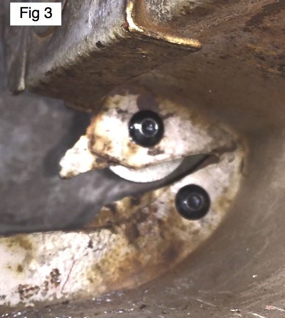

    In Fig 3 the screws are installed. I discovered after drilling the first hole, my old hand was not able to get into that space to put the screws in or to work a wrench.

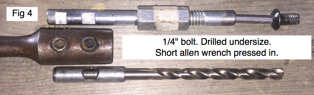

    The adapter I made to hold the screws for installation, is shown in fig 4, along with the drill and adapter bushing
    It is amazing how much those two small screws tightened up the panels.
