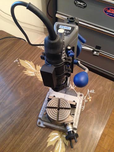

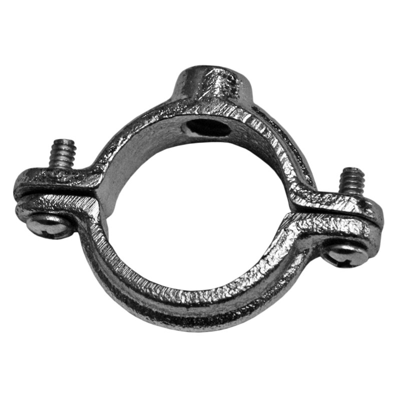

    I made a Dremel Tool bracket using two 1 1/2"metal pipe hangers from Lowes that fit the OD of the Dremel perfectly. In the center of the "ring" or hanger, there is a boss for a 3/8" 16 NC screw. I choosed a piece of CRS 3/4" thick by 1 1/4" wide to fit my lathe tool post. To drill the holes for the screws in the lathe's center line, I attached the block in one the four tool locations and by using a MT5 dead center in my lathe spindle I scribed a line in the bar to locate the two Allen flat head attaching bolts countersunk level with the bar. The rings

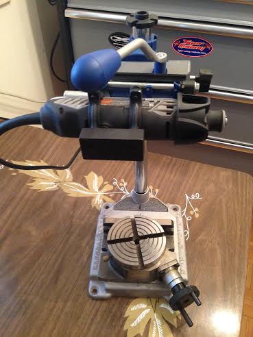

    The finished bracket attached to the Dremel Station horizontal as in the lathe and vertical for other uses.

    I placed the rings as far apart as possible in areas not affecting switches and also without ribs in the tool body.
    The round head original screws used in the rings were replaced by Allen socket screws tightened firm but not excessively due to the plastic body of the Dremel. The assembly is very solid and without movement or vibration as other brackets using a metal or aluminum block with a threaded hole at the end holding the Dremel by the end only, which is rather weak given the massive overhang at the rear of the tool.
    The Dremel held in the lathe thus, is useful not only for grinding OD/IDs but also to drill radial 1/8" holes in a centered work piece in the lathe chuck for those people who have an indexing plate in the back of the spindle. Such holes can later be transferred safely to a mill or drill press and enlarged as required.
    All that's needed, is a pin gauge to locate the first hole in a rotary table and then move over to the rest for perfectly centered and aligned locations.
    The bracket as designed, allows installation in the Dremel station or lathe without dismantlig.
    For appearance's sake the bracket assembly was sprayed flat black.
