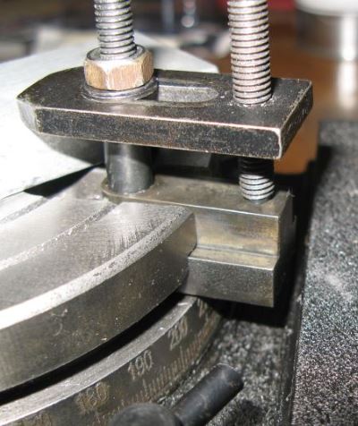

    I was forever needing to clamp a part right where the coolant return tray was on my old radial drill I used to have so I made some of these "T" nuts then instead of cutting all of them into individual nuts I kept this one as a double

    Yep, these extensions work. I do this on rotary tables, tilt tables and so on.
    A good way to add stops outside the normal surface envelope too. Use caution though people, you'll generate a lot of leverage outside the t-slot; they can break. If you make these, fit them closely, so when under tension they contact a decent amount of the underside of t-slot to counteract tendency to tilt. A set screw in the inboard tapped hole helps too.

    Tool maker is correct caution is required when clamping outside the realm of the devices parameters.
    in my case my drill press had its "T" slots milled all the way tp the rim of the table the double "T" nuts were long enough to reach both the rim and the main part of the table even with this I took care not to over tighten my clamps. MY philosophy was more clamps at lower torque on each was by far better than trying to squeeze b y with fewer clamps by over stressing them.

    I use it quite a bit for clamping odd shaped parts with 2 hole down clamps. I could always just use 2 T nuts but this one is just handy and then there are the odd times when I need the clamp to be in the positioned outside of the slots that is when I too use a blunt nosed grub screw to secure the t nut in the slot and the clamp bolt in the other hole. Instead of over tightening things down I add more clamps. IT works especially well when having to edge clamp the nut can be secured then the lateral clamping force put much less strain on the table slots

    You might like these long T-nuts that I made for the rotary table
