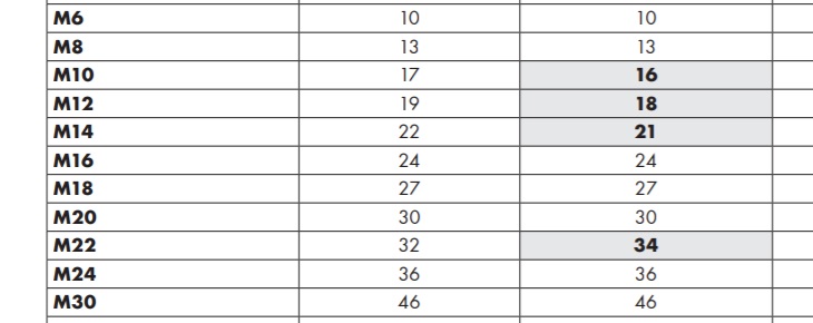

    PS: Not being rude above, I often find myself NOT using the one I thought I wanted when stumbling
    upon this inconsistency in the Metric World - The 2 standards of ISO and DIN at M10, 12, 14 & 22:

    That chart is why people need the so called no skip socket or wrench sets. I believe Japan throws one more odd wrench into the line up. It is really frustrating as you end up needing a large collection of wrenches for that one odd nut.
