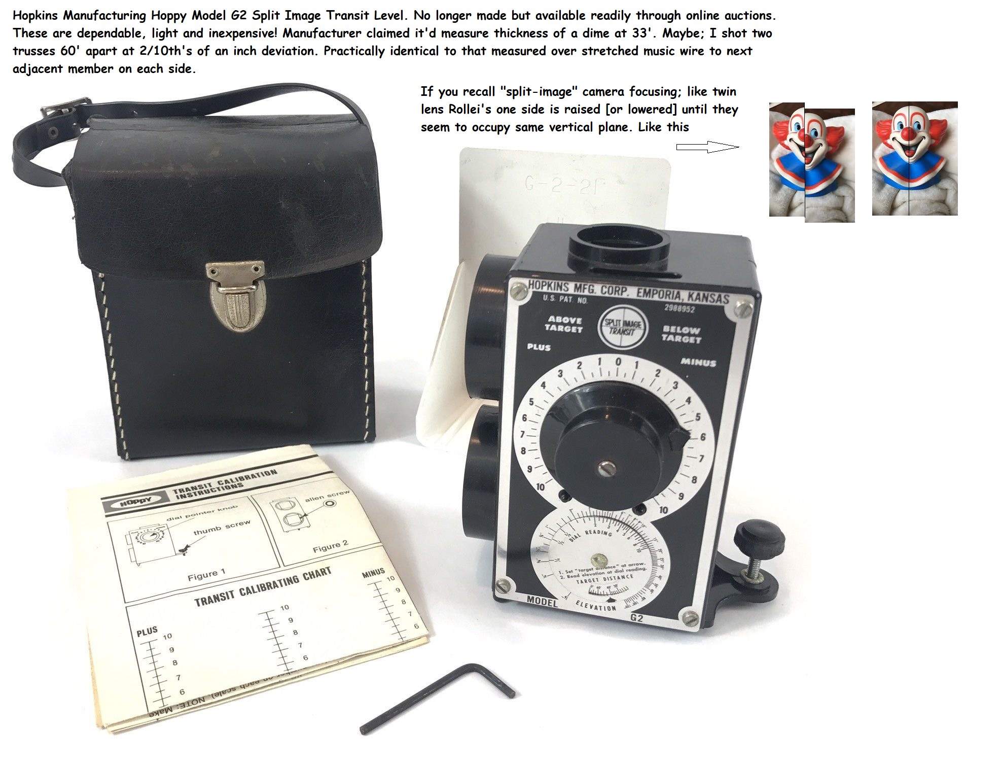

    Realizing you have an instrument already, here are my other go-to devices.
    Hand Level [aka Locke Hand Level] been around over a hundred years; newer ones look different but work identically. Great for landscape and rough leveling of forms etc. I posted it and staff, sort of built into a range rod, sometime back...http://www.homemadetools.net/forum/s...ne-sight-43371
    Split-Image Transit.
    Here's Wikipedia on transits, and various forms they've evolved into.
    https://en.wikipedia.org/wiki/Level_(instrument)
    Like you Papa Smurf, I've a legitimate surveyor's outfit; analog, old school, whatever someone might call it. It's a pleasure to use, even though I only level and drop points at short distances. Way better than working over obstructions for same information. While not machine leveling, I have set infeed tables and such hardware leading to a machine.
