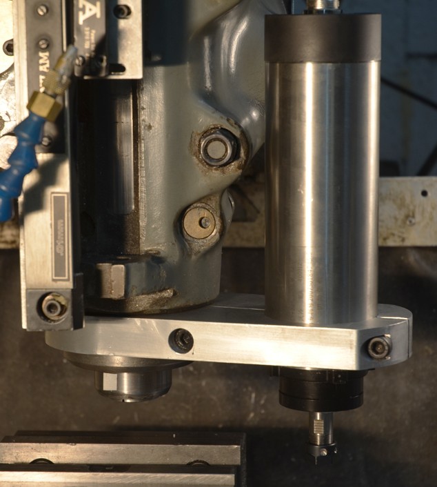

    For some time I have needed a surface grinder and have been thinking about attaching the same grinding head to my mill. My Bridgeport was fitted from new with an early Anilam CNC system which I have ungraded to PC control. The CNC would allow for automatic X and Y traverse and Z depth of cut adjustment. I had put this job off because I thought that I had more pressing jobs and I thought that it would take more time than I wanted to spend on it.

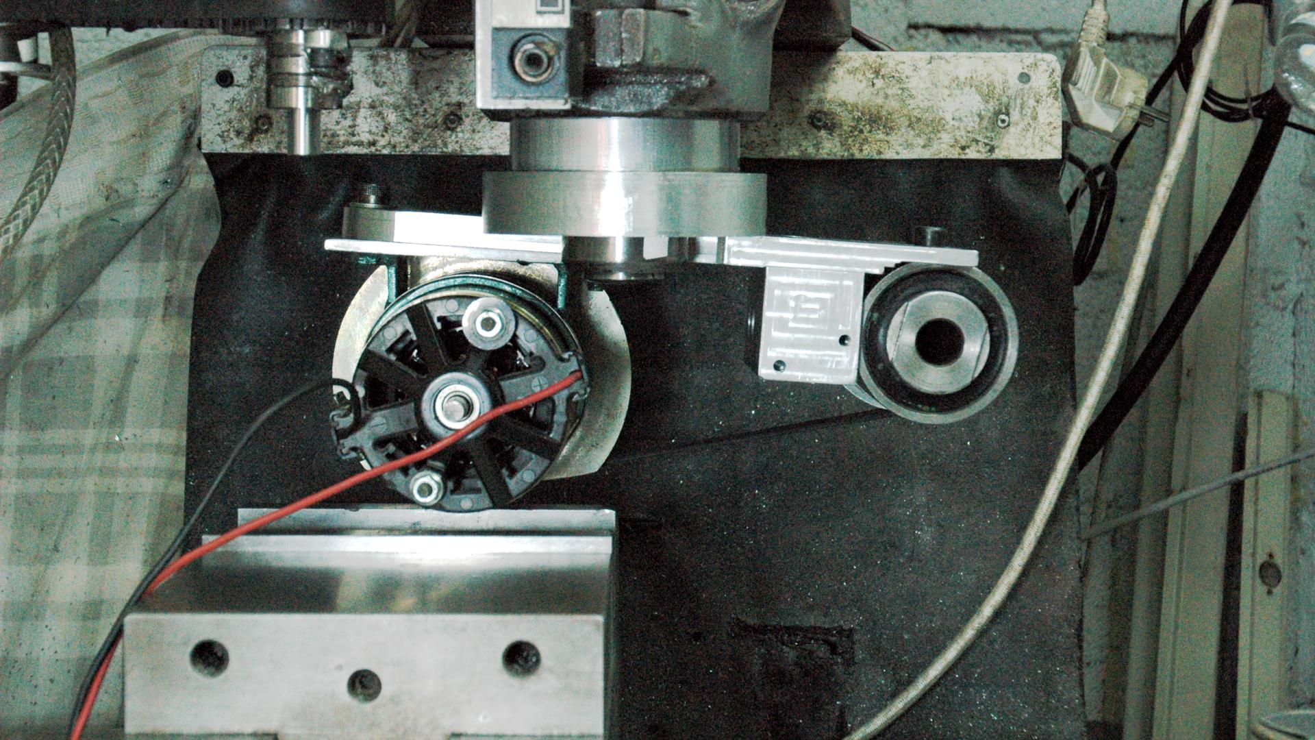

    Attaching a grinder to a mill for this purpose is not a new idea in this forum, but others I have seen have fixed the grinder to the frame structure of the mill. I wanted to attach it to the quill for depth control.
    I realised that I would need to make a clamp around the quill but I had already made a couple to hold a high speed air spindle and later an electric spindle. Looking at those I saw that if I turned the grinding head upside down I could bolt it to the electric spindle clamp. Drill 4 mounting holes in the clamp and drill and tap 4 holes in the grinding head base plate. That didn't seem like it would take too long, a reasonable price to remove an item from my todo list.
    Attachment 22941 Attachment 22942
    High speed spindle clamp.
    Attachment 22943
    Showing the four bolts holding the grinding head to the quill clamp. 1. is countersunk to avoid fouling the quill housing, 2. is a close fit for repeatable location, 3 & 4 are in oversize holes to allow some movement to permit the clamp to close up on the quill without resistance. 3 & 4 are tightened after the clamp. The asymmetric bolt pattern was to fit in with the bracket clamping bolt and other obstacles.
    Luckily, I realised that if I mounted the base plate horizontally then the motor would be lower than the wheel surface, which would prevent the grinding of long work pieces. A solution would be to angle the base plate down at the wheel end by 3.5 deg. So I milled an angled surface on the quill clamp. The clamp is substantial enough so that the holes and milled surface have next to no effect on strength nor stiffness. It would have been easy to have overlooked this problem and it was pure luck that made me check.
    Attachment 22944 Attachment 22945
    On the left, milling the clamp for the 3.5 deg angle. On the right we can be seen how the grinder base tilts downward at the wheel end.
    A couple of hours later and I did my first test grind and was very pleased with the finish, I did it dry but will try mist in future. I used a cheap bench grinder wheel, because it is the only one that I have with a 1.25" hole in it to fit my mandrels. I can fit wheels between 5.5" and 6.5", larger will foul the clamp and less leaves the motor lower, which only matters for long work pieces. I have a CBN 6" wheel that I got for cam grinding, that is narrower and would need more passes but it will be interesting to see the finish.

    The two "spindles" have separate functions. One is the spindle for the grinding wheel. That came with taper roller bearings which have no place in such devices. Spindle heat expansion will loosen the bearings. So I have converted it to 2 back to back angular contact at the wheel end and a simple ball race at the pulley end which cam float axially. This is the best way to hold the wheel securely and allow for the differential expansion twit spindle and housing.
    The other is the motor. This is a permanent magnet DC motor off an exercise treadmill. Max. RPM of these motors is typically 5000/5500. The quoted power of mine is 2hp. Although I live in Spain with 220 v electrics, this motor is 110 v because I got in when I lived in the US for 3 years. I have a large 220/110 v transformer and I have wired my workshop for both 220 and 110 v electrics.
    Quote Originally Posted by petertha View Post
    Can you comment on yours? Does the all-in-one motor/spindle run quite accurate? What kind of rpm/watts is it? How are the bearings & how long can you run? I've seen some China cnc router ones but after about 500-700 watts they seem to have water cooling & many are VFD,
    I use these treadmill motors in various devices. They come with cooling fans and are designed for continuous running. However for what I suspect are obvious reasons, I have removed the fan from the motor on the grinder and when loaded it does warm up. So far I haven't reached the point where I considered it too hot to continue without a cool down break. Maybe that will happen when used as a surface grinder?
    I finish machine the pulleys after fitting them to the shafts to maximise accuracy.
    Today I am making some additional modifications to the motor to make it more suited to duty on a grinder and I will make a separate post when those are complete. I'll change bearings, stiffen the bearing housing, seal the motor better, change from the poly-V belt to a flat belt.
    The Chinese router spindles are high speed only. With a VFD you can physically run them at slow speed but you will soon need to buy a replacement if you do. They quote a minimum speed and you should NEVER run them below that because the fan won't shift enough air. The VFDs sold with those spindles as a kit will probably come with the VFD set for an appropriate minimum speed so the only danger is if you want to use the VFD on other slower motors and reprogram them. You can get either full air cooled versions or air/water cooling (usually referred to just as water cooled). Even the water cooled ones have a "do not run below" speed. So these high speed devices are not suitable for use with large wheels such as used for external grinding. For routing, milling with small tools and internal grinding with small mounted wheels these spindles work well and the ones in my experience have a good bearing setup. I have heard that some come with poor quality bearings but it is cheap enough to replace them with quality bearings. Mine have given no problems. here are some pix of my high speed spindle, also as fitted in a lathe and mill.
