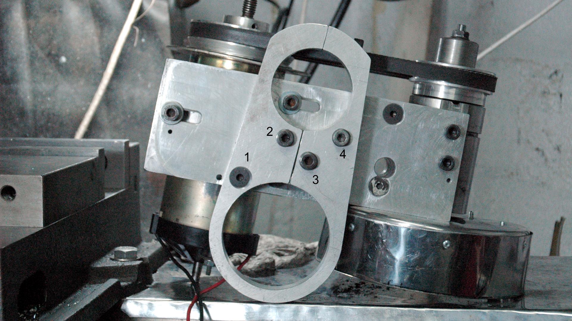

    For some time I have needed a surface grinder and have been thinking about attaching the same grinding head to my mill. My Bridgeport was fitted from new with an early Anilam CNC system which I have ungraded to PC control. The CNC would allow for automatic X and Y traverse and Z depth of cut adjustment. I had put this job off because I thought that I had more pressing jobs and I thought that it would take more time than I wanted to spend on it.
    Attaching a grinder to a mill for this purpose is not a new idea in this forum, but others I have seen have fixed the grinder to the frame structure of the mill. I wanted to attach it to the quill for depth control.
    I realised that I would need to make a clamp around the quill but I had already made a couple to hold a high speed air spindle and later an electric spindle. Looking at those I saw that if I turned the grinding head upside down I could bolt it to the electric spindle clamp. Drill 4 mounting holes in the clamp and drill and tap 4 holes in the grinding head base plate. That didn't seem like it would take too long, a reasonable price to remove an item from my todo list.
    High speed spindle clamp.
    Showing the four bolts holding the grinding head to the quill clamp. 1. is countersunk to avoid fouling the quill housing, 2. is a close fit for repeatable location, 3 & 4 are in oversize holes to allow some movement to permit the clamp to close up on the quill without resistance. 3 & 4 are tightened after the clamp. The asymmetric bolt pattern was to fit in with the bracket clamping bolt and other obstacles.
    Luckily, I realised that if I mounted the base plate horizontally then the motor would be lower than the wheel surface, which would prevent the grinding of long work pieces. A solution would be to angle the base plate down at the wheel end by 3.5 deg. So I milled an angled surface on the quill clamp. The clamp is substantial enough so that the holes and milled surface have next to no effect on strength nor stiffness. It would have been easy to have overlooked this problem and it was pure luck that made me check.

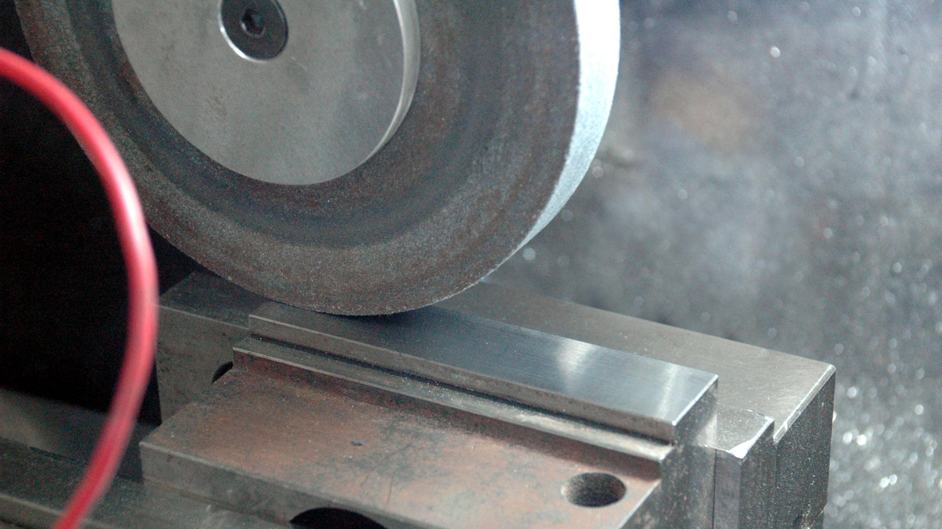

    A couple of hours later and I did my first test grind and was very pleased with the finish, I did it dry but will try mist in future. I used a cheap bench grinder wheel, because it is the only one that I have with a 1.25" hole in it to fit my mandrels. I can fit wheels between 5.5" and 6.5", larger will foul the clamp and less leaves the motor lower, which only matters for long work pieces. I have a CBN 6" wheel that I got for cam grinding, that is narrower and would need more passes but it will be interesting to see the finish.
    DIY surface grinder-grinder-01.jpg DIY surface grinder-grinder-02.jpg DIY surface grinder-grinder-03.jpg
    A couple views of the grinder before it had a wheel cover and after doing the first test grind on a piece of hardened steel. I was very pleased with the results.

    Tony, what a great idea to get more out of your cutter grinder head.
    If it is any help we used to do all our tool steel form grinding dry as our optical dividing heads would not tolerate coolant, the wheels were white oxide 80 grit for hard steel and they held up well without generating too much heat, the CBN wheels were always used with coolant. I like the magnet swarf catching idea.

    I must get some proper surface grinding wheels, the one that I used is just a bench grinding wheel. IIRC you have a lot of grinding experience so I'd appreciate any advice on wheels etc. I do not have much grinding experience at all.
    I have so far only used CBN wheels for HSS tool sharpening, and as the actual cutting time and depth of cut are both minimal i have had no heat problems doing it dry.
    I think that the magnet idea is the most important thing that anyone could gain from my post. Especially when grinding on a mill or lathe where the ways are not properly protected against grinding swarf. I wish that I had thought of it ages ago.
