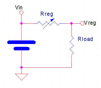

    I have watched your video and I have a number of problems with it.
    Oh, where to begin...
    Your classification of regulators is reasonable, but the two groups - linear and switching are because they are very different in function, performance, and most importantly, efficiency. I didn't get the sense that you understood those differences.
    Linear regulators are, as you describe, a voltage divider with a variably controlled resistance that regulates the output voltage. What is the variable resistance? Generally it is a transistor which is NOT controlled by some cartoon character. These regulators have fairly simple analog circuits and just because you can't explain how it works (here is how it works - it is a transistor that is controlled so that the transistor acts as a variable resistance and that control is a feedback loop from a voltage divider), you should not invent a cartoon function. This stuff is real science and engineering!!! If you can't explain it properly, don't use nonsense to wave your hands.
    So, now that we know a linear regulator is a voltage divider, we can now understand why it is inefficient - there can be lots of power used in a voltage divider. Why - because a voltage divider is resistance and power for a resistor is resistance times current and the current is the current used by the curcuit being supplied power by the voltage regulator.
    Here is the simple circuit for the regulator:
    DIY something with electronics need some knowledge on the topic-voltagedivider.jpg
    So - if want the regulator to supply 1A to Rload (that is the circuit we are powering) the regulator gets to disipate P=I*R = 1A * Rreg and the circuit disipates it's power of 1A * Rload. But wait - we have not said what Rreg is! Ah, true, but we know that the venerable 78xx series regulator (we will use the 7805 as an example) - can deliver the 1A we want and Vin will need to be at least 7.3v for a stable 5v Vreg. Now that we know Vin and Vreg we know the voltage across Rreg (2.3v minimum).

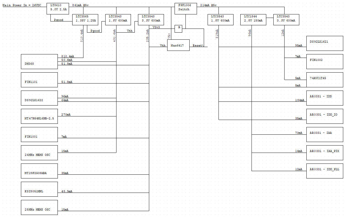

    A switching regulator can be, if designed correctly, 90+% efficient, sometimes over 95% efficient. No, I don't expect this video to go into that, but dismissing switching supplies as being "noisy" is absolute nonsense. Yes, that fake 555 switcher is nonsense and you labled it so, but just because you make an awful circuit, that doesn't mean all are awful. Irresponsible!!!
    Here is a power diagram from a camera system I designed from 8 years ago (last thing I worked on before I retired).
    DIY something with electronics need some knowledge on the topic-voltagedistribution.jpg
    It's kind of small to read, so click the image to expand. This is for a single camera module which consists of a processor board which compresses 2048x1536 video at 15fps and a separate camera board with the imager. The sytem captured panoramic video imagery with up to groups of 8 cameras per panoramic module. Very efficient switching supplies, 24v in to the module goes to 5v and then becomes 1.35v, 1.8v, and 3.3v for the processor and 1.8v, 2.8v, and 3.3v for the imager. This would not be possible at all with linear regulation.
    In summary - Linear regulation - fine for low power consumption, fine for reference voltages (such as needed by an Analog to Digital converter (AtoD or AD)). Switching regulation - needed for higher power consumption, sometimes is troublesome when not enough load.

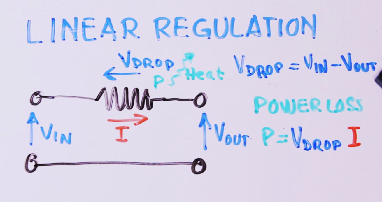

    @BuffaloJohn ...well, I'm baffled. Why did you repeat what I've already said in the video?
    Your comment makes me worry wondering whether I have troubles in communicating messages, that would void the very reason of making videos.
    At minute 7:57 I exactly address the problem of efficiency with linear regulators and why switching come.
    DIY something with electronics need some knowledge on the topic-power-losses.png
    Now let's talk about the "fictious cartoon character" (that indeed was a tribute to the Maxwell's daemon, BTW). Here it is a transcript of what I've said (emphasis added):
    Now let's talk about that little daemon capable of adjusting the resistors.
    We can build that "daemon controlled variable resistor" using a transistor that not only is able to change the resistance between its collector-emitter junctions, but also amplify the small voltage that develop between its base-emitter junction.
    Using a "cartoon character" was an expedient to convey the concept to people that have not much knowledge in electronics.
