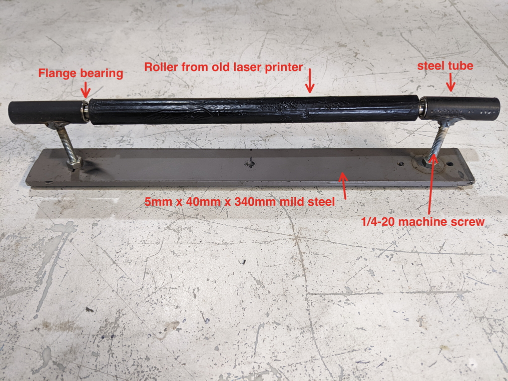

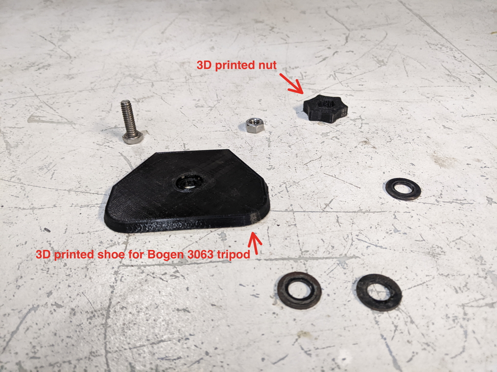

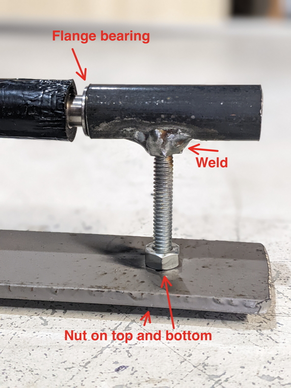

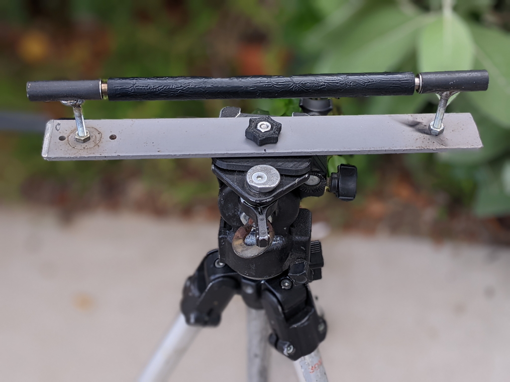

    Photos should be self-explanatory. 3D printed quick-release tripod shoe/plate is for a Bogen 3063 tripod. Plate and finger nut were found on Thingiverse.
    DIY roller stand attachment for photo/video tripod-rollerstand1.jpg
    DIY roller stand attachment for photo/video tripod-rollerstand2.jpg
    DIY roller stand attachment for photo/video tripod-rollerstand3.jpg
    DIY roller stand attachment for photo/video tripod-rollerstand4.jpg
