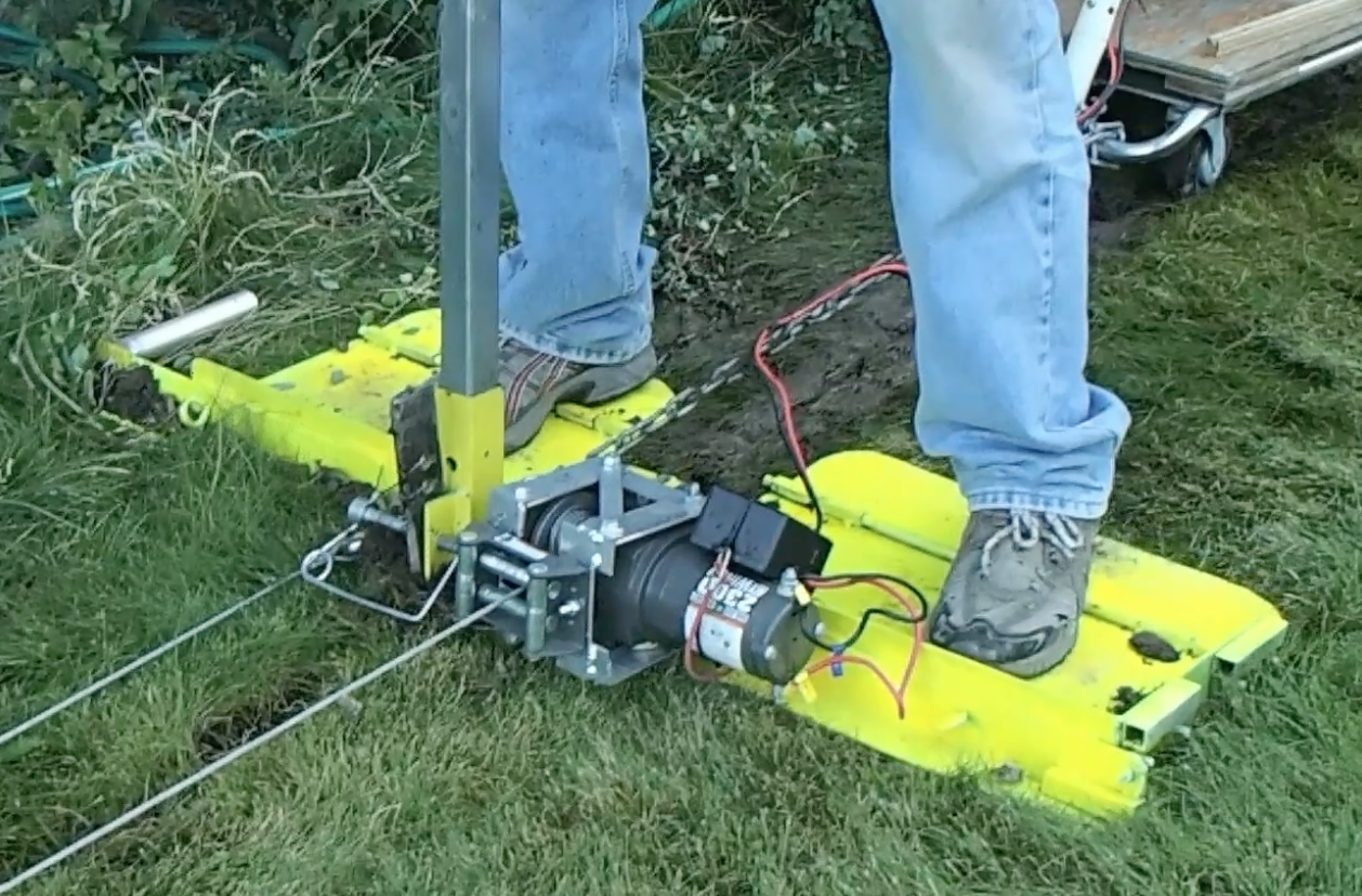

    For too many years I have been considering adding additional sprinklers to the underground irrigation system that came with the property. Since I, really, hate to move dirt by digging, I have not been very eager to accomplish the task. Then, one day last summer, I was shopping for metal at a local welding shop, and spotted a large piece in the discard barrel. I knew, immediately, what I could turn it into, as I had been waiting for decades for it to show up. So, I took it home, and with a few modifications, it transformed into a useful tool. I, first, set the knife to depth (8" to 12"), and cut to depth. Then, I return to the start, and pull in the pipe. I steer the sled by weight transfer on the "ailerons." The long T-handle provides sufficient leverage to, easily, rip through any roots that are encountered.
    I failed to find a shapely young lass in a bikini to demo the trencher, so had to settle for the old guy... sorry!

    Gadgeteer - how does the winch handle the work load? Does the winch drive heat up for those long pulls, or does it handle it OK?

    I have checked the winch for heat, and so far, it has not heated over the expected slight warming from normal use. It is the smallest ATV winch from HF, similar to the one I used for my powercaster, a few decades ago.

    Great idea...I built a tool similar to that a few years back but pulled it with the winch on my truck. It has since been upgraded to being used on the 3pt hitch on my tractor.

    Brilliant idea. Safe bet less effort to build than trench by hand, and tool is ready to use again. The clip on wheels to cart it off, icing on the cake.
