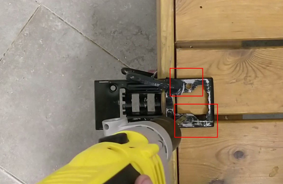

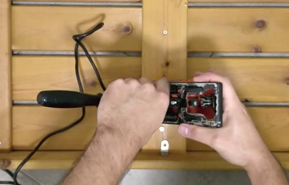

    I started with removal of the Jigsaw bottom base.
    I disassembled the screws holding it and positioned it on the bottom of the table to check the location for its conneciton.
    DIY Portable Jigsaw Table From Garden Table (Easy installation & removal)-screenshot_3.jpg
    The base already had 2 holes.

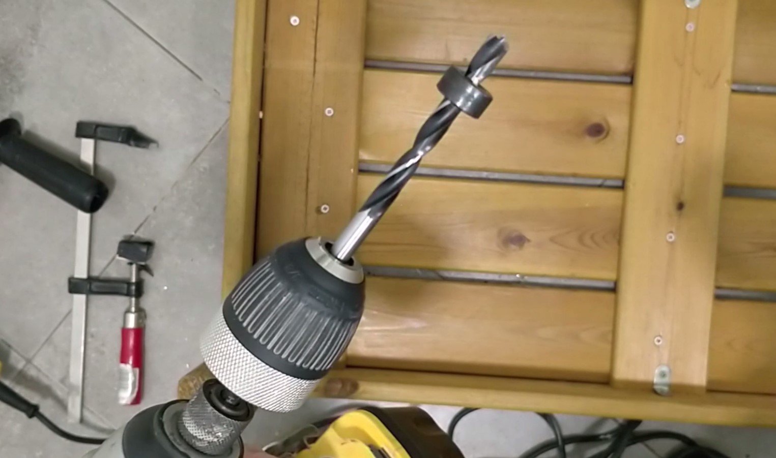

    After marking the position with a hammer, I drilled 2 additional 8mm holes using a metal drill.
    DIY Portable Jigsaw Table From Garden Table (Easy installation & removal)-screenshot_7.jpg

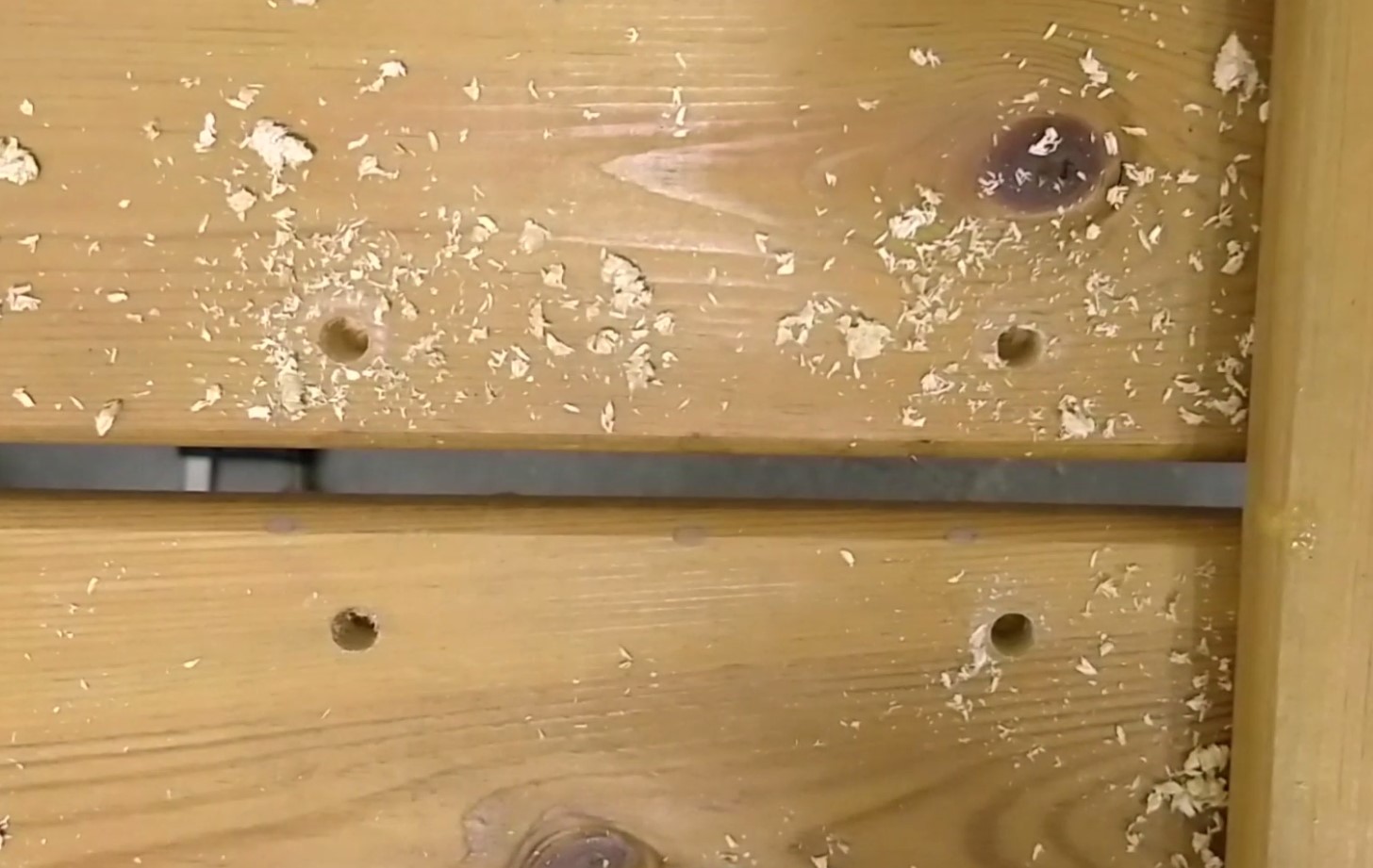

    I marked the positions of the 4 base's holes, on the table bottom and drilled with 7mm wood drill and a stopper for 14mm depth (in order avoid getting to the other side, in the 18mm wood).

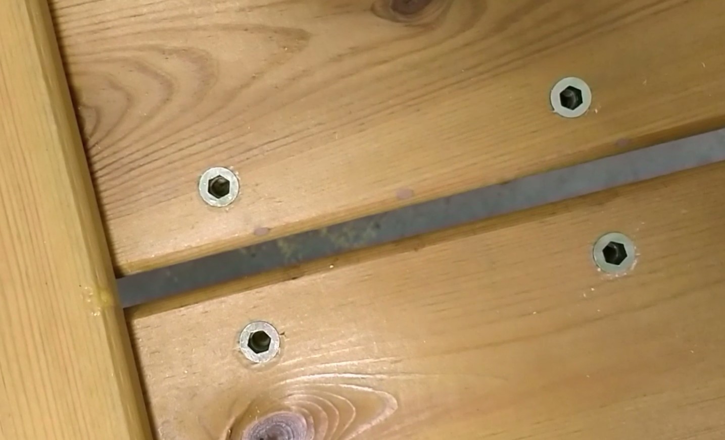

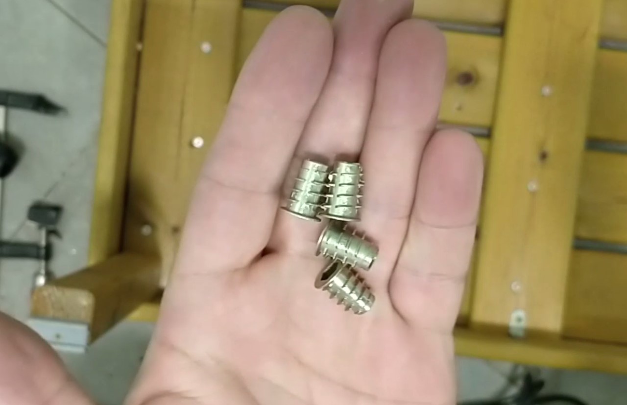

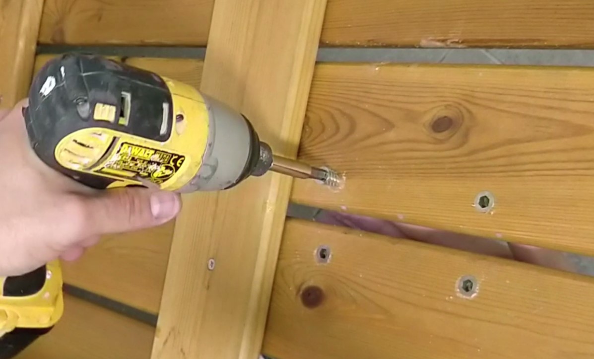

    I took 4 threaded inserts / insert nuts and matching screws and metal rings.
    These inserts, allow easy removal and re-connection of the screws and the Jigsaw to the table.
    If I would use regular wood screws directly to the wood board, it won't hold too much reconnections...
    DIY Portable Jigsaw Table From Garden Table (Easy installation & removal)-screenshot_10.jpg
    I connected the inserts into the previous step drilled holes. I did it carefully so the insert won't be passed to the other side of the table top.

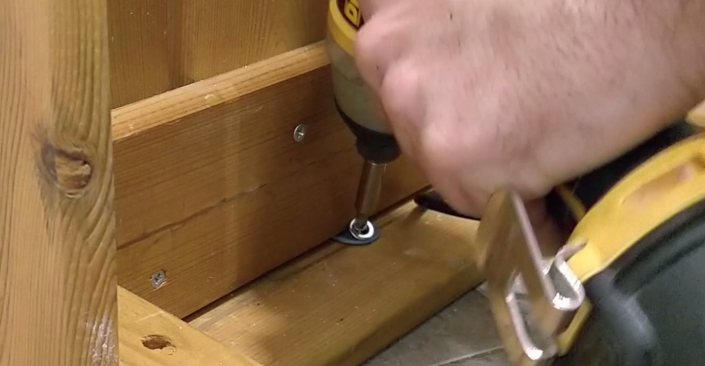

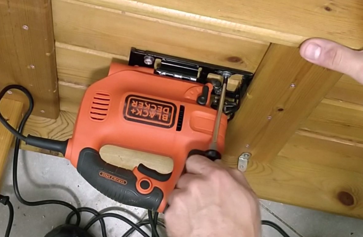

    I connected the metal base back to the Jigsaw.
    Later, I connected the Jigsaw to the table using the screws and metal rings to the inserts.
    DIY Portable Jigsaw Table From Garden Table (Easy installation & removal)-screenshot_19.jpg

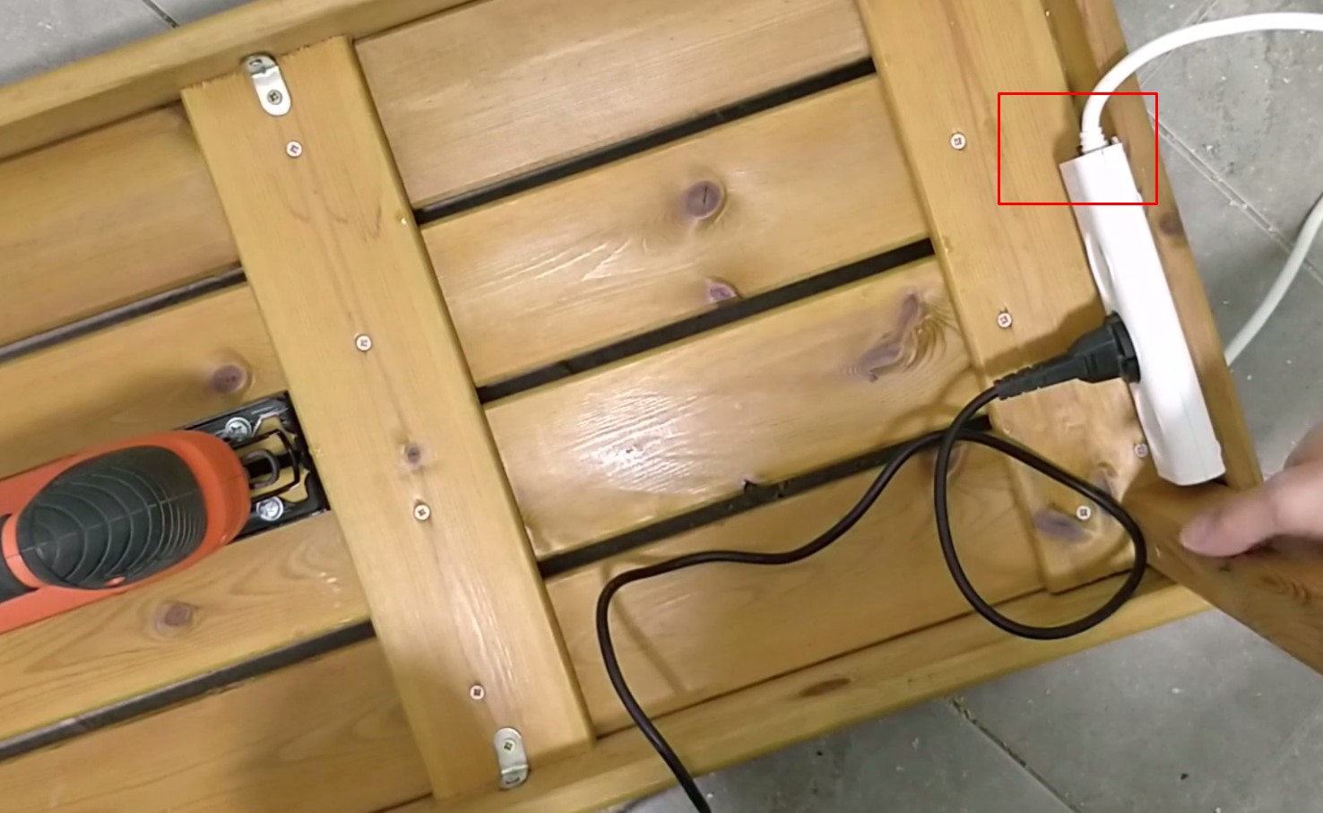

    I pressed the Jigsaw switch and locked it using the lock button, so it would work without pressing it.
    Finally I connected its power cord to an extension cord with a switch.

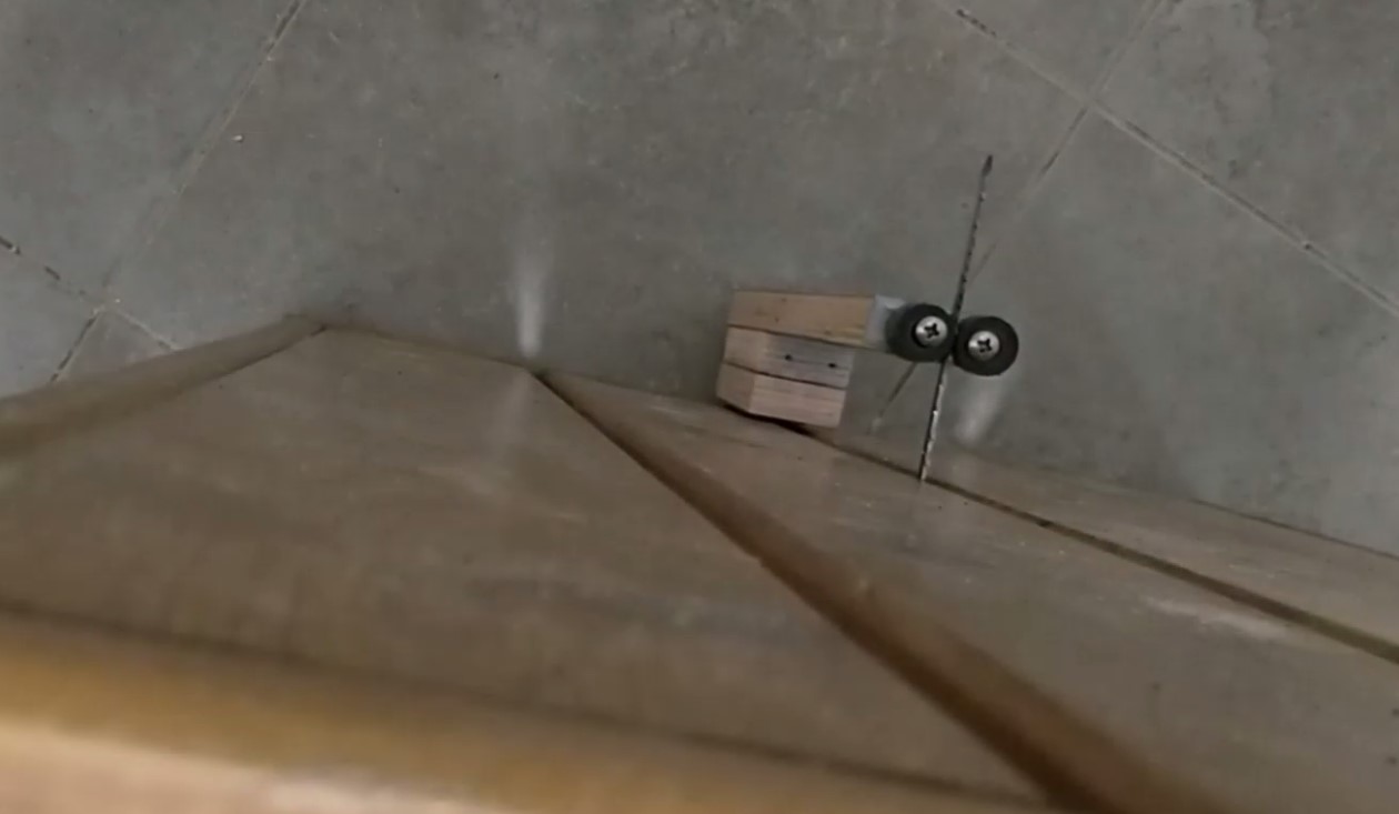

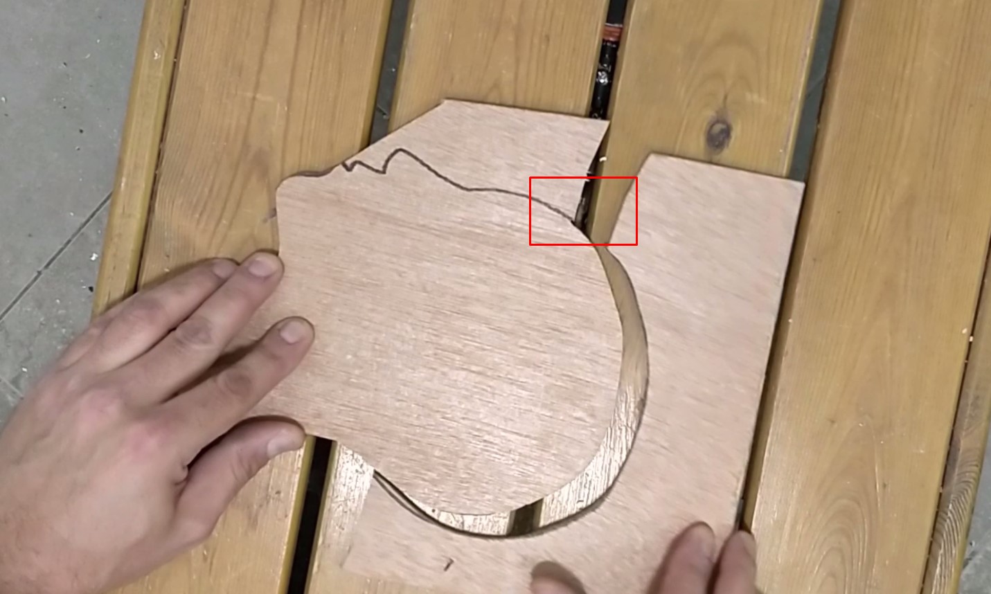

    At first, I tried to cut without a special guide for the blade.
    DIY Portable Jigsaw Table From Garden Table (Easy installation & removal)-screenshot_25.jpg
    As you can see in the video, It cut well but the only issue is that the blade moves from side to side and I decided to add additional guide for the blade, in order to stabilize it.
    In addtion, it was hard to see the blade without any mark on the table (although I could see it well from the side while cutting).

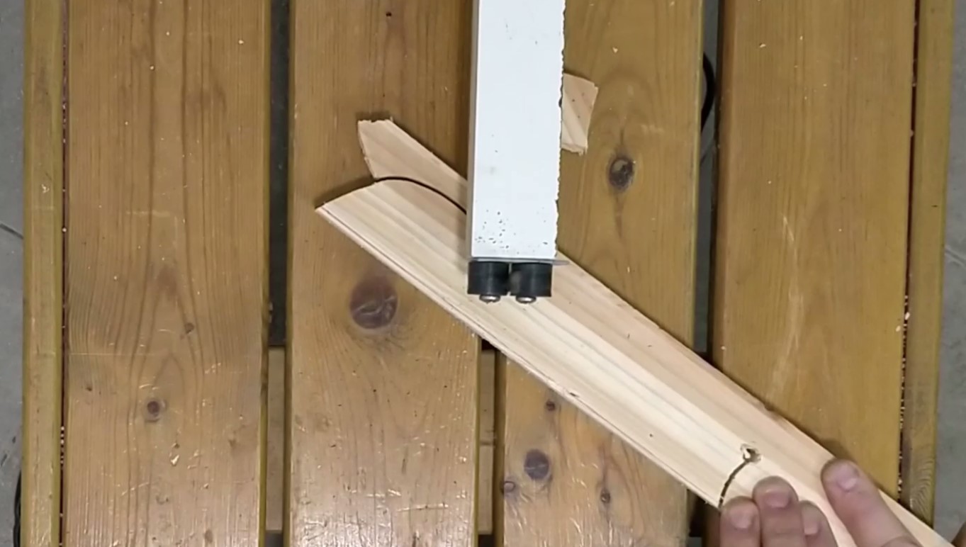

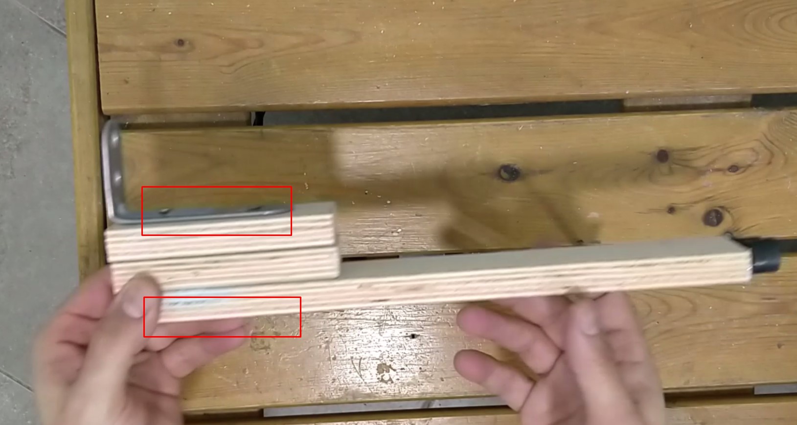

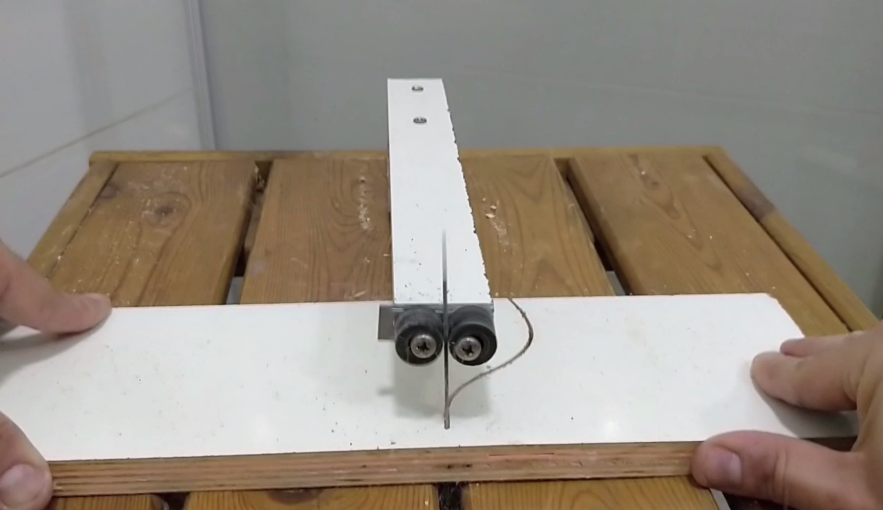

    I took the cylindrical plastic parts I had (I assume it's made of Aokolon), and connected them side by side, leaving a space for the blade.
    Usually, people are using bearings for such projects but I couldn't find ones.
    I decided to use the plastic parts although they can be worn out after some time, but I don't plan to use it intensively and I can replace it later for any other parts.
    I cut some wood pieces for making the guide holder.
    I connected the wood pieces together as you can see in the image. I made it high enough for the wood I need to cut.
    finally, I connected a metal angle at the bottom, in order to connect it to the table.
    DIY Portable Jigsaw Table From Garden Table (Easy installation & removal)-screenshot_32.jpg
    I connected it with screw below the table.
    DIY Portable Jigsaw Table From Garden Table (Easy installation & removal)-screenshot_33.jpg
    DIY Portable Jigsaw Table From Garden Table (Easy installation & removal)-screenshot_34.jpg
    On the second try with the blade guide, the blade was much more stable, as you can see in the video.
