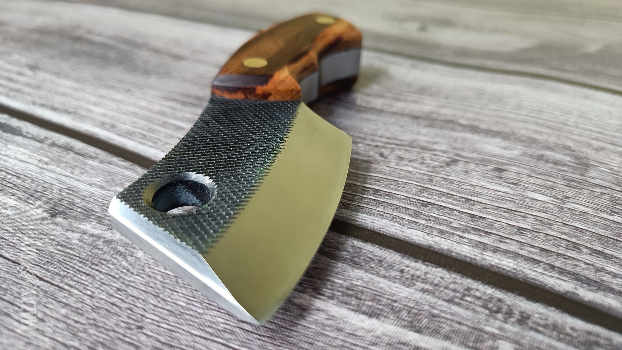

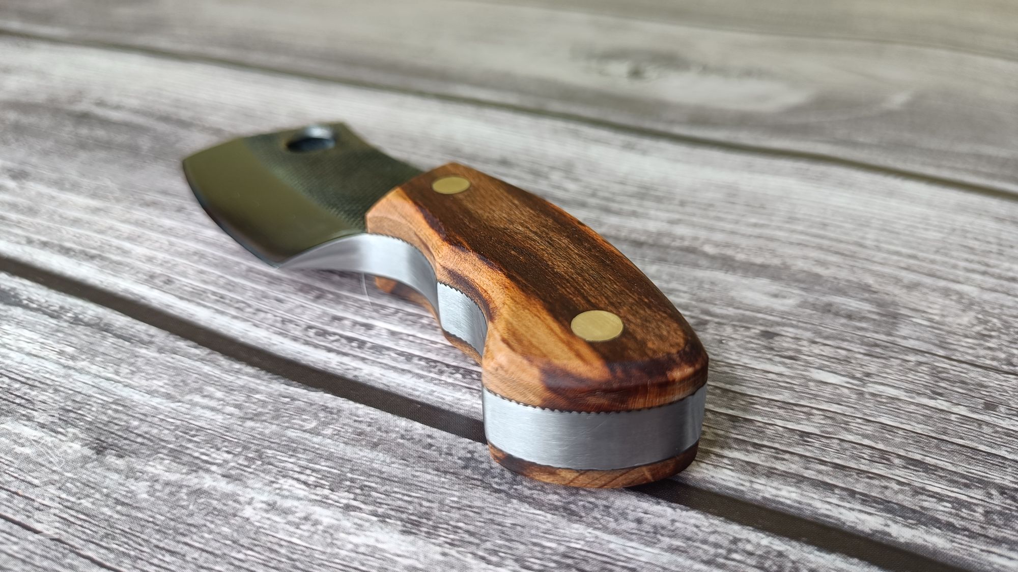

In this video, we're going to be making a Mini Cleaver knife out of an old file. This neck knife is small but mighty, perfect for those quick and dirty chores around the house.

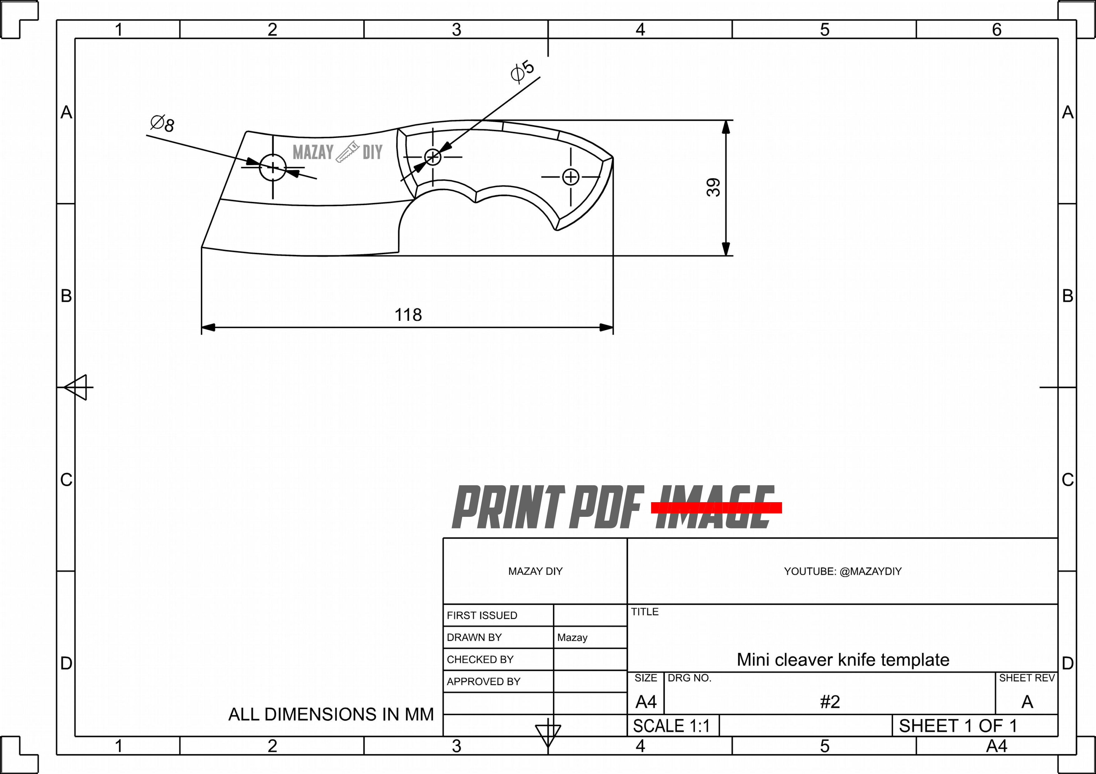

Mini Cleaver Knife PDF template
