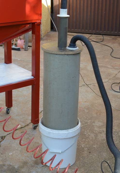

    I have problem with electrycity consume, i think keeps the sawdust out of your shop vacuum cleaner but consume low watt. Super cheap to make and saves you money. Parts are easy to find. low watt consume but still enough powerfull for suck with big dust container.I add extra wwindow and plastic bag on dust container for easy maintenance and give extra dust bag on outlet blower. portable and easy for organize.

    great job, great video. I too have made a few dust collectors although none with the Thien baffle yet. Instead of using a filter bag on the outlet I pass the exhaust through a water trap which removes any remaining dust.
