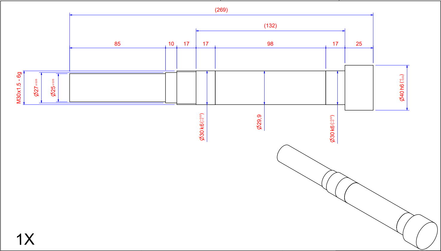

    Lightbulb Homemade Spindle for mini Lathe
    In this video I am making a new spindle for my Vintage Mini Lathe.
    Please consider subscribing in order to support me in making more and better content!
    Thanks for watching...

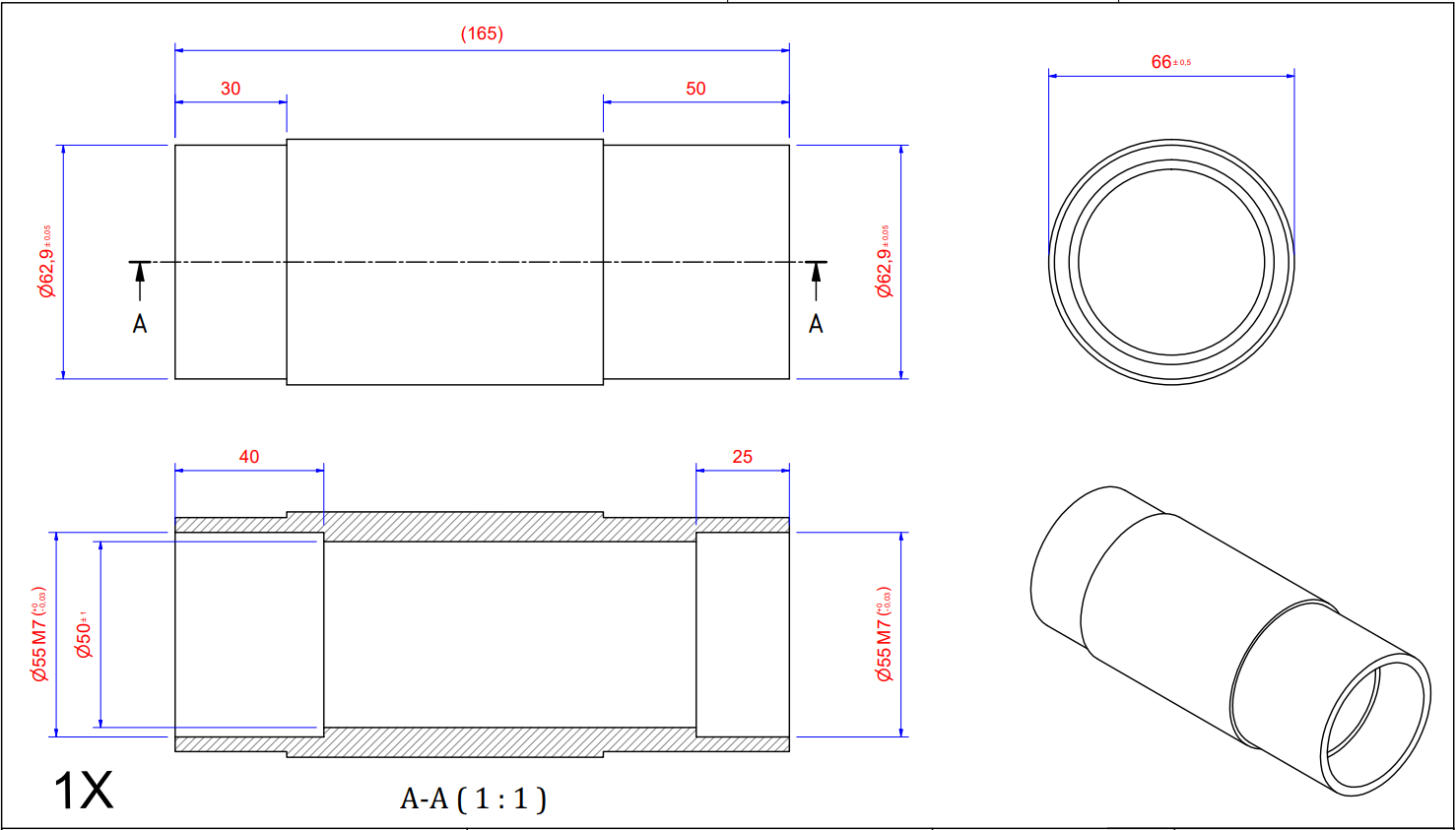

    DIY Lathe Spindle-mini-lathe-headstock-bearing-housing.pngDIY Lathe Spindle-mini-lathe-headstock-axle.pngDrawings of the axle and bearing housing, including tolerances (in Metric)
