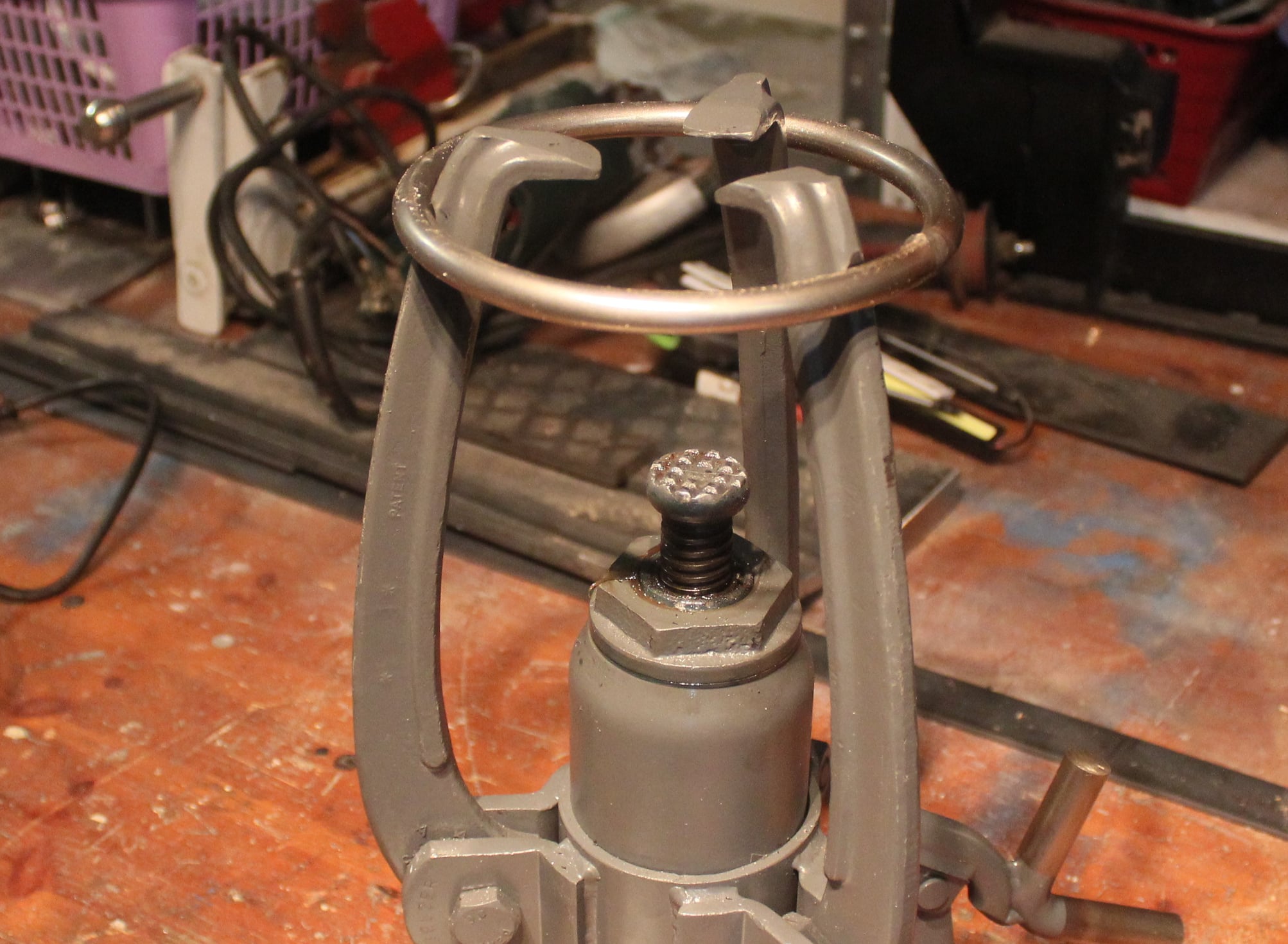

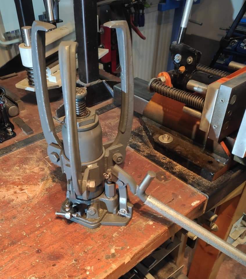

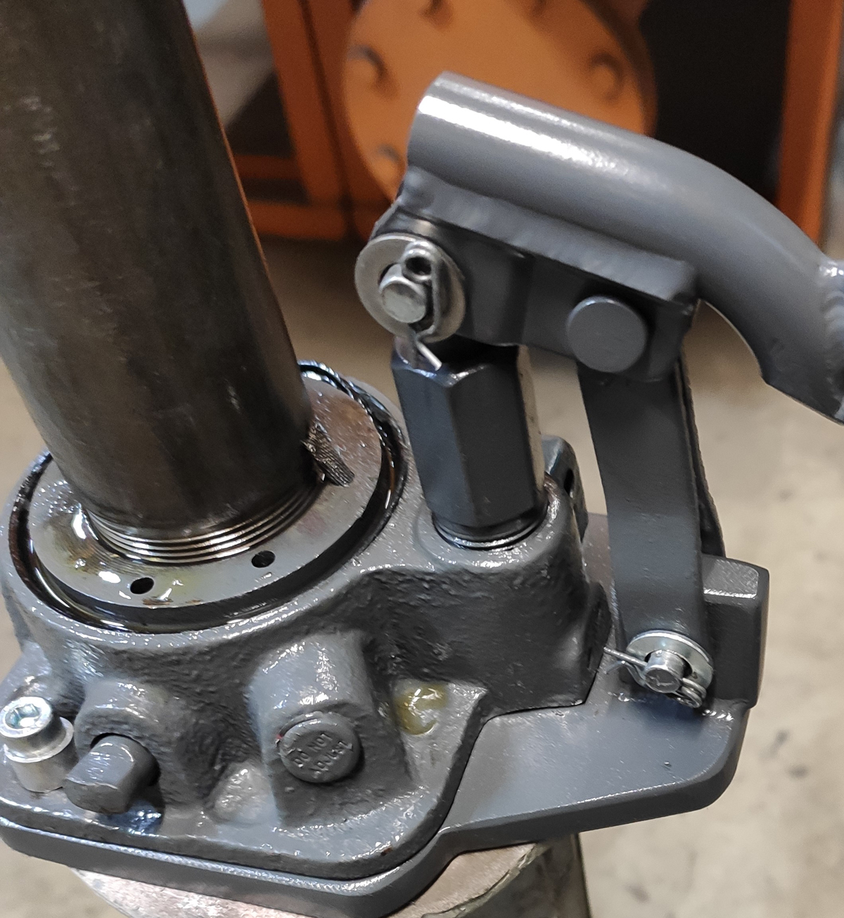

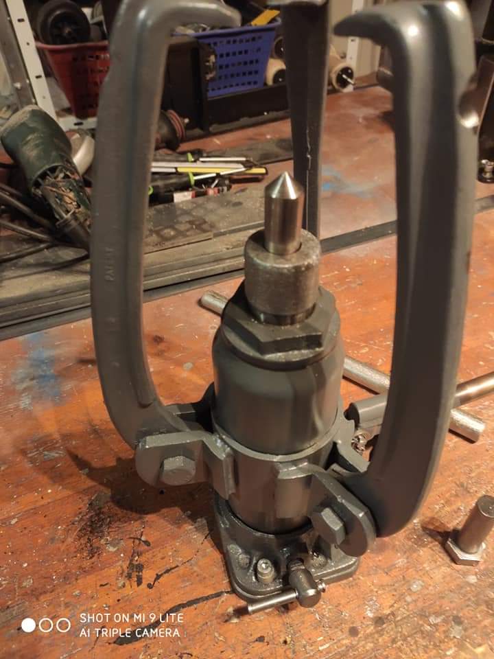

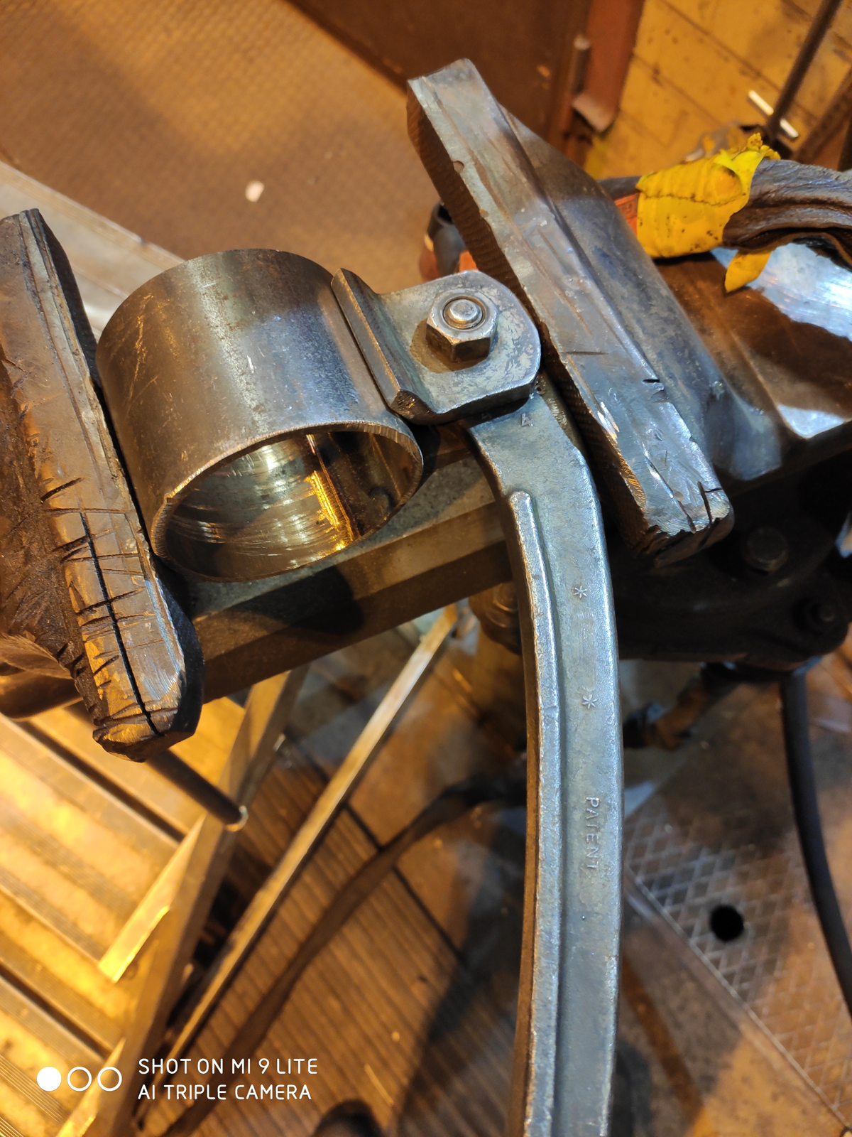

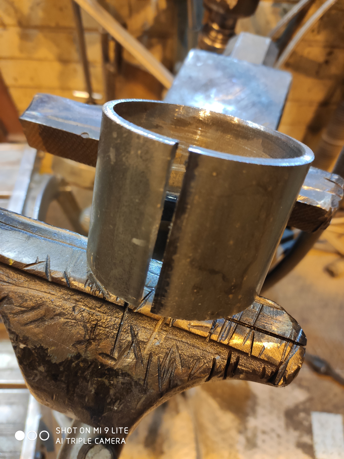

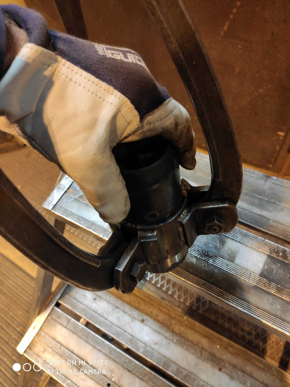

    Made my version about the diy hydraulic bearing puller.
    I have seen some videos about making one, but i wasn't convinced about the presented structures.
    So, i made my own version.

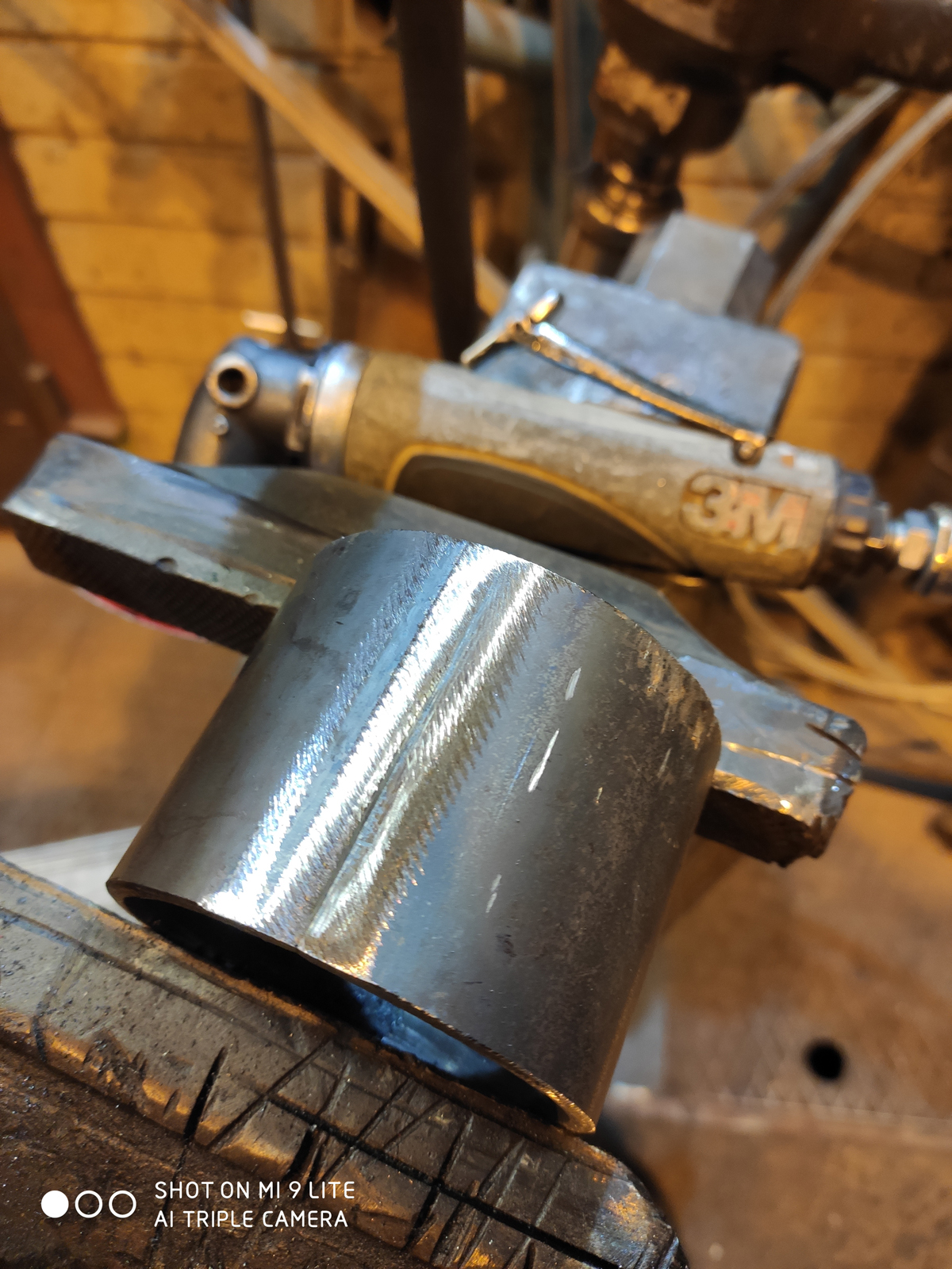

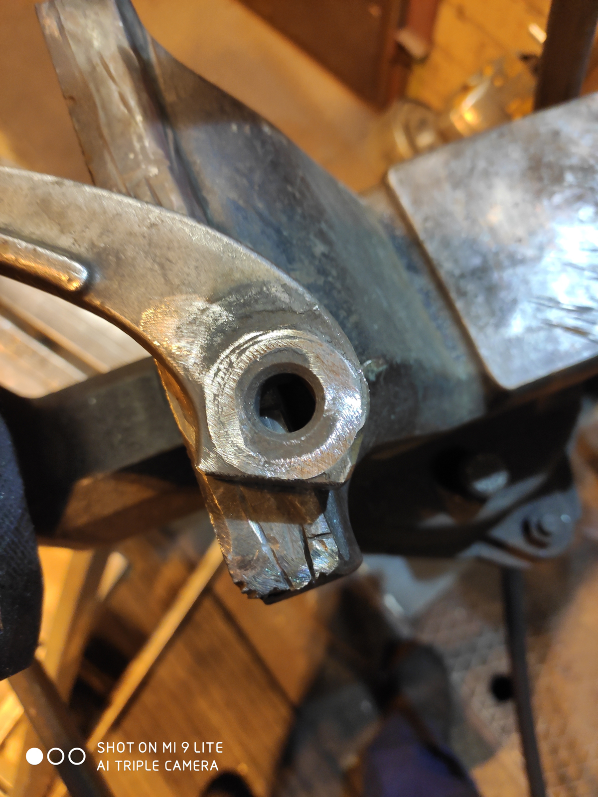

    Used 5 ton jack and forged claws taken from old broken puller. ( broken threads )
    Because wall of the jacks oil chamfer is only 2mm thick.
    Connecting claws directly to it, isn't very strong solution.
    Therefore i made a support ring around it from 5mm thick pipe.
    Claws we're connected to this stronger pipe.
    I adjusted the diameter of the pipe with suitable thickness steel plate. To get firm connection between pipes.

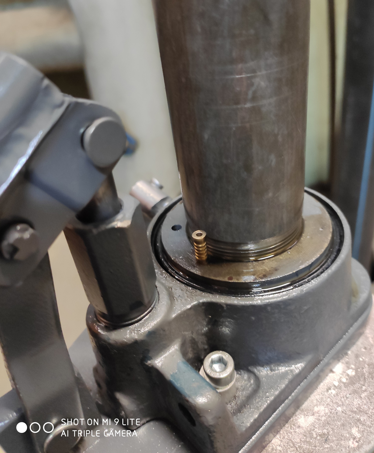

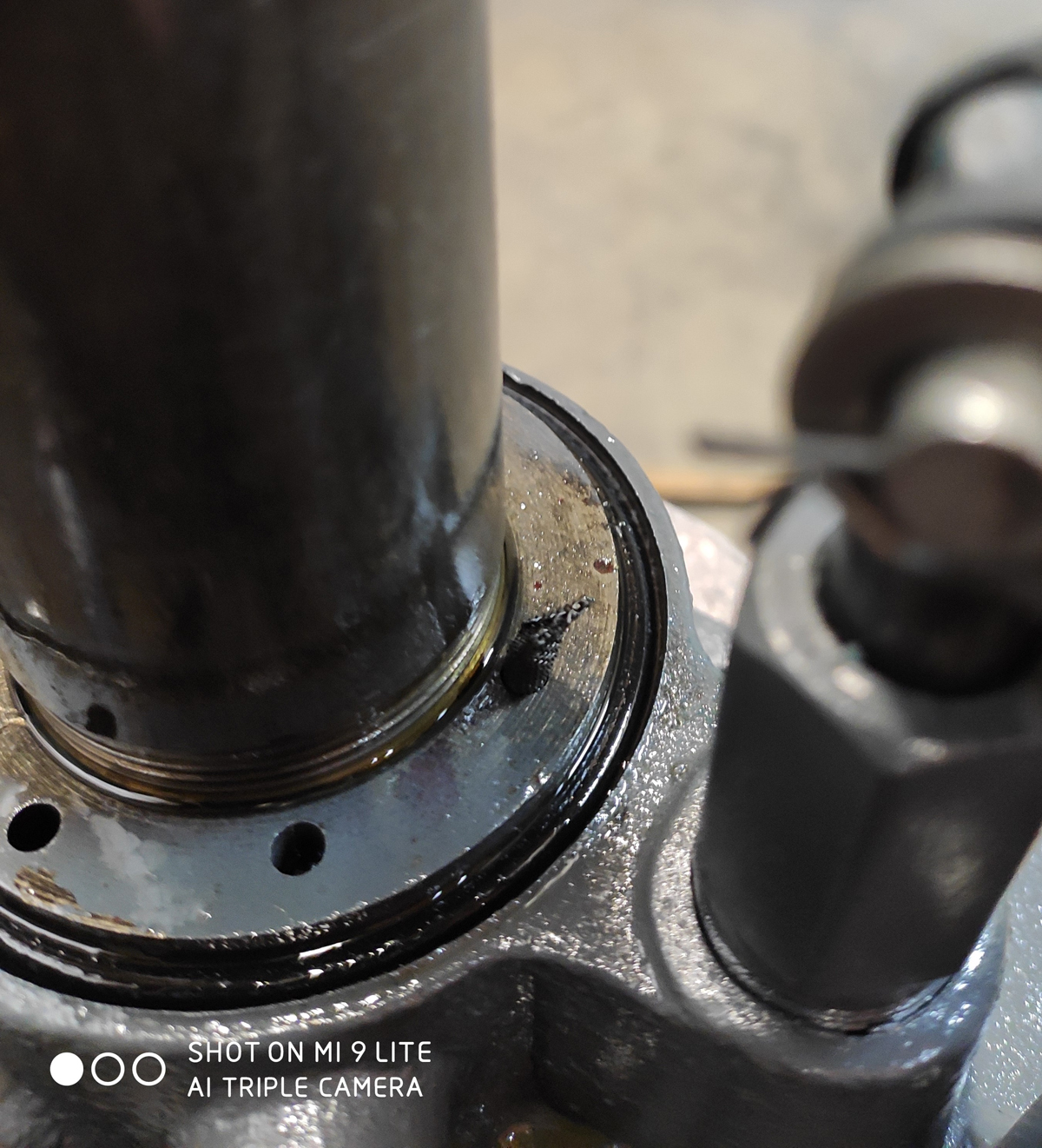

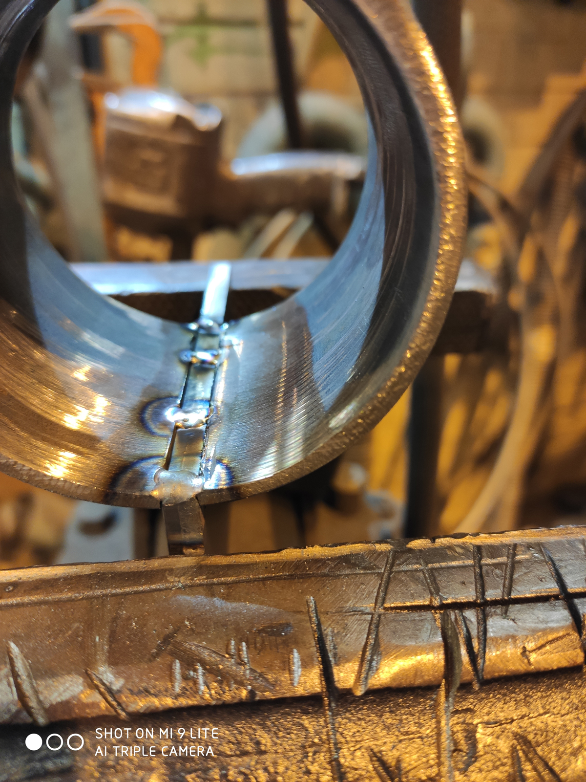

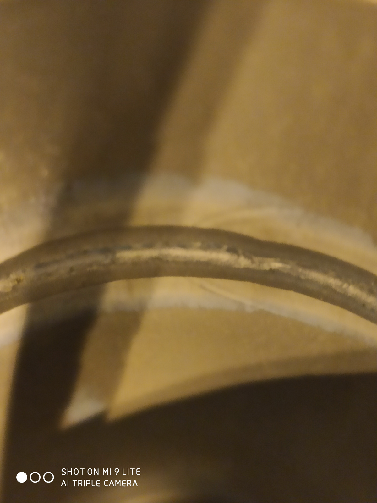

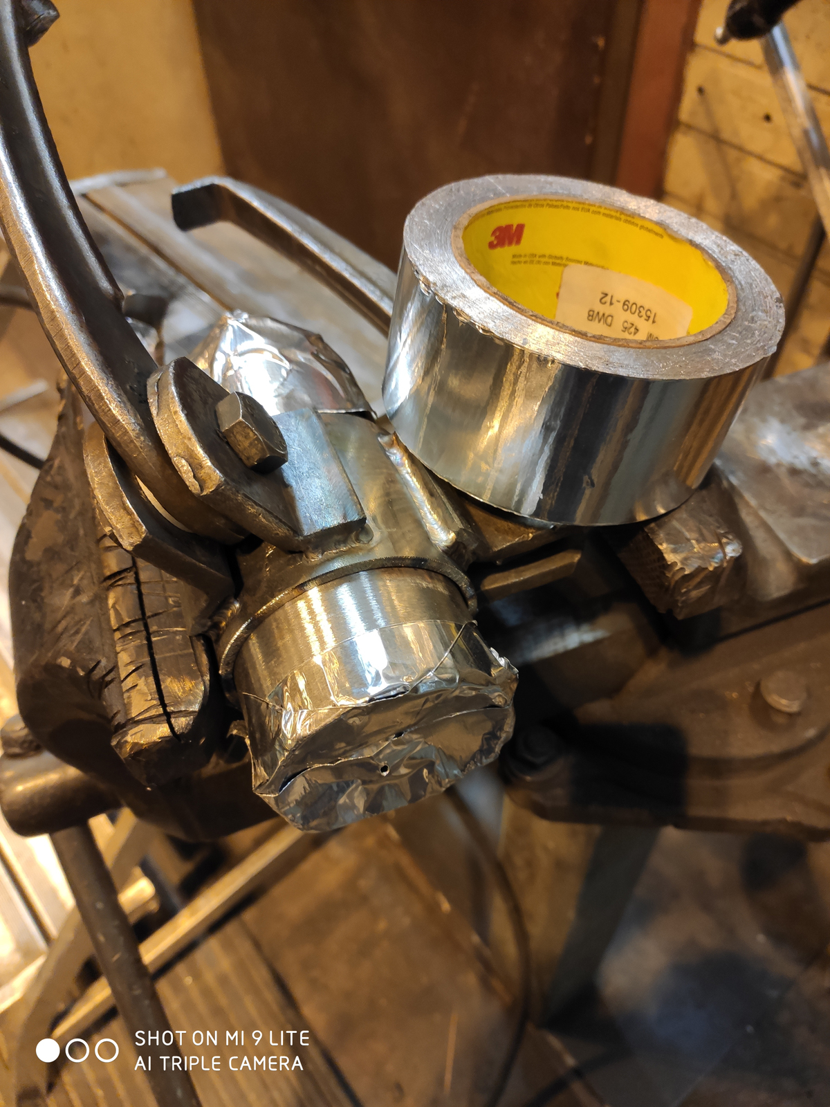

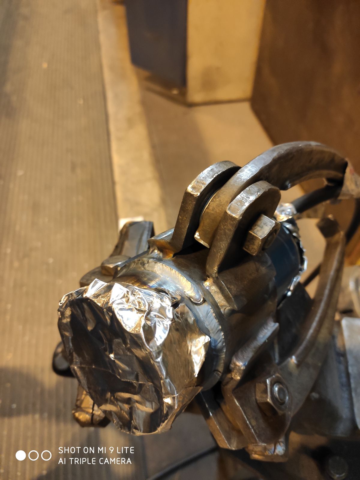

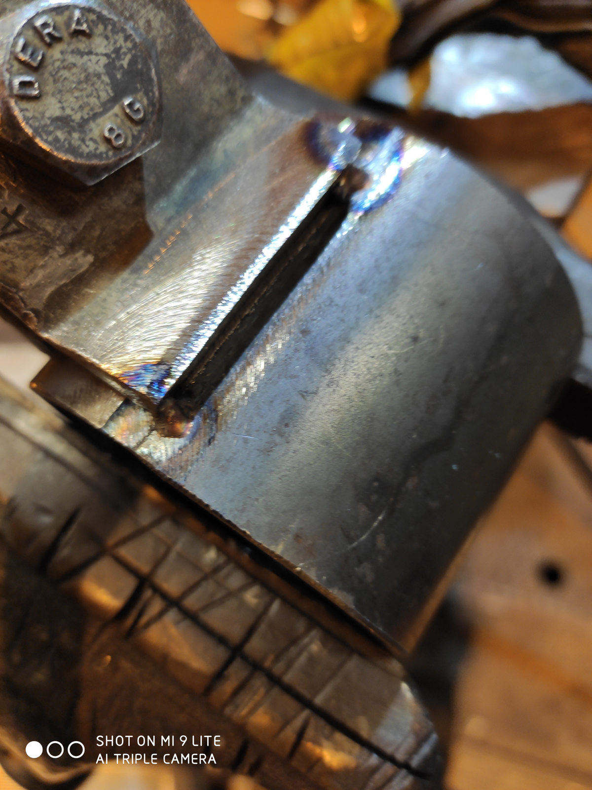

    Before welding the claw holders, i placed oil chamfer inside the support ring.
    Welding shrinks metals when welds cool down.
    After welding connection was very tight. ( Too tight to get oil chamfer inside it afterwards )
    Diy hydraulic puller / pusher-15.jpg
    Then i welded oil chamfer and support ring together, from The bottom edge. ( this sequence gives minimal distortion )
    Before welding, i filled oil chamfer with shield gas, to get pure, weld trough connection.
    Diy hydraulic puller / pusher-16.jpgDiy hydraulic puller / pusher-17.jpgDiy hydraulic puller / pusher-18.jpg

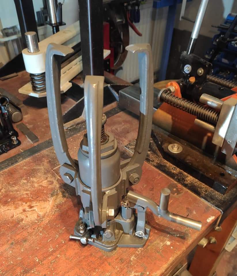

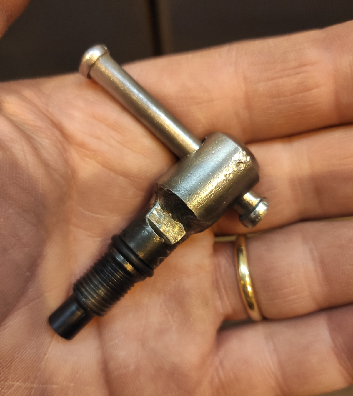

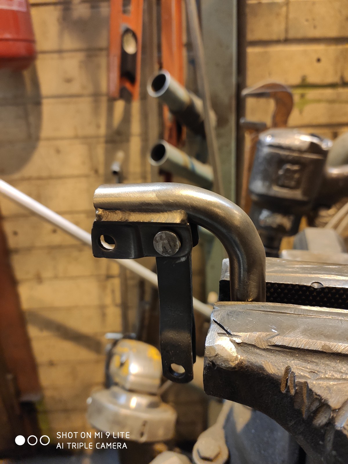

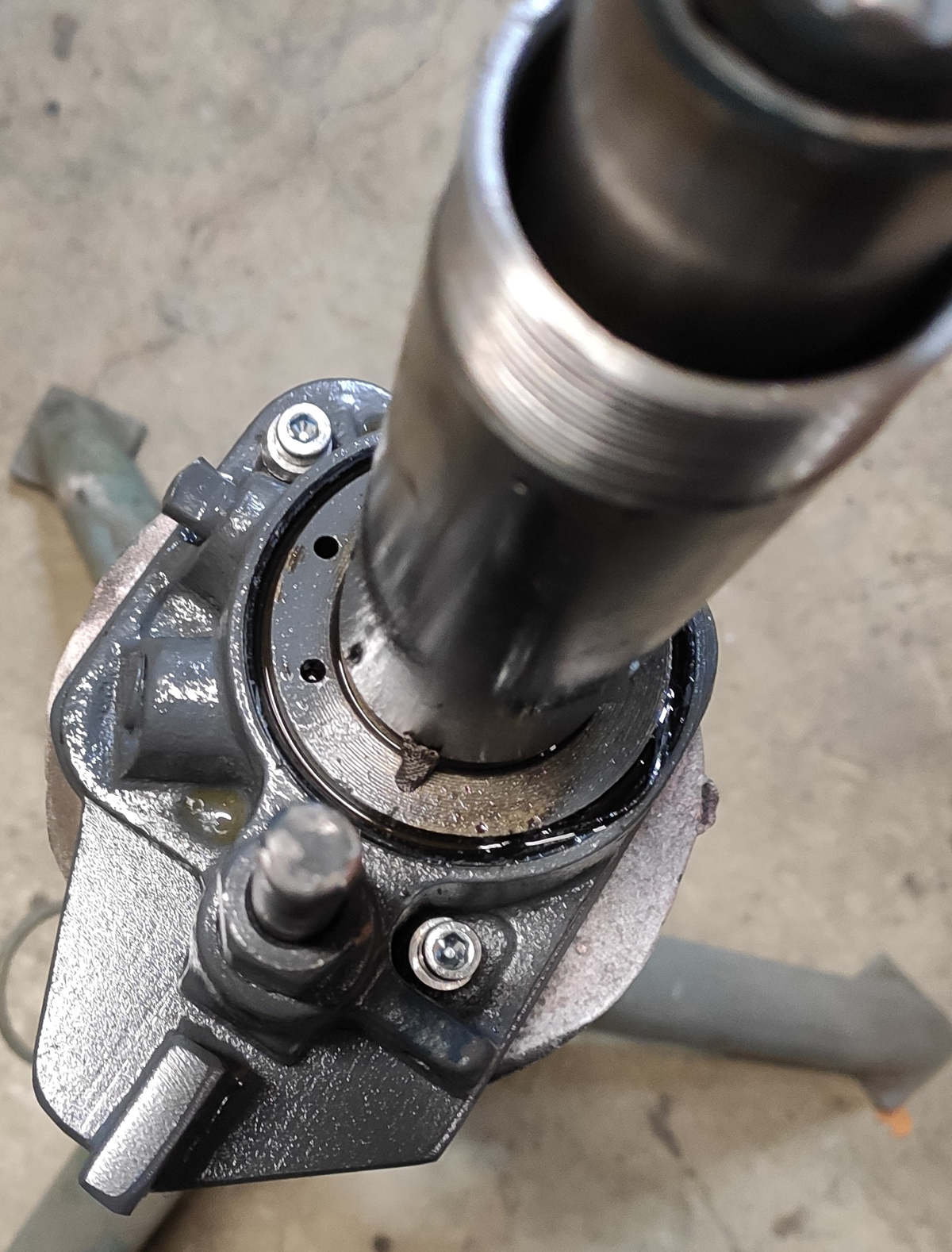

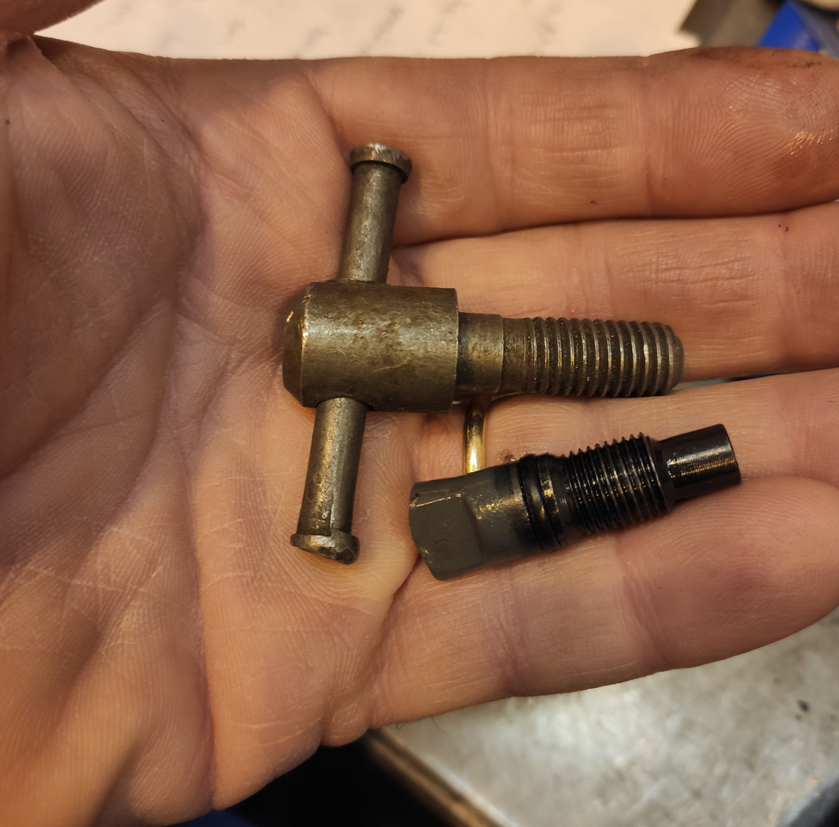

    Tilted the pump mechanism 90 degrees, and shaped handle connection for better usability.
    Diy hydraulic puller / pusher-20.jpgDiy hydraulic puller / pusher-22.jpgDiy hydraulic puller / pusher-25.jpgDiy hydraulic puller / pusher-26.jpgDiy hydraulic puller / pusher-27.jpg

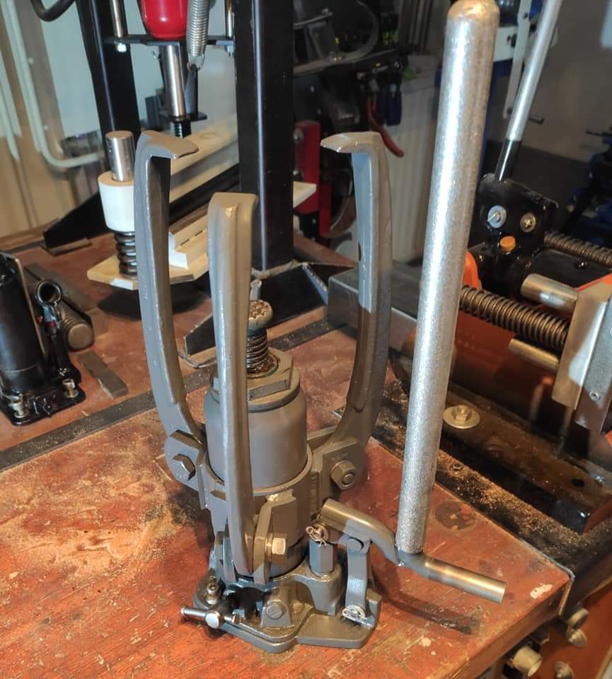

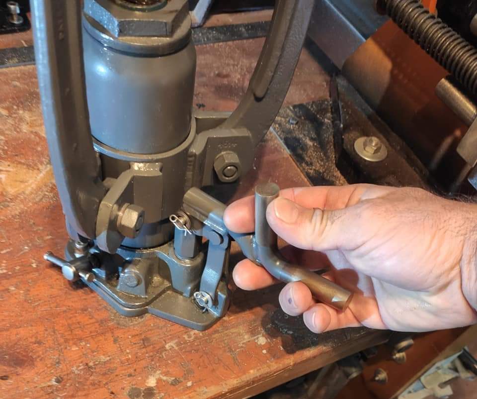

    Handle for the valve, and for the pump.
    Diy hydraulic puller / pusher-28.jpgDiy hydraulic puller / pusher-29.jpgDiy hydraulic puller / pusher-30.jpgDiy hydraulic puller / pusher-31.jpg

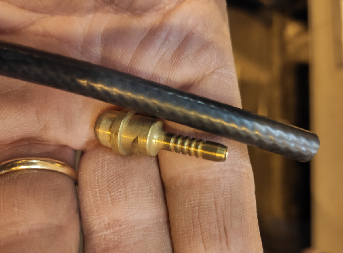

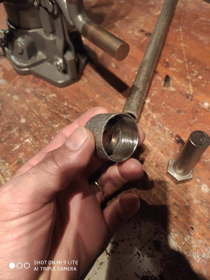

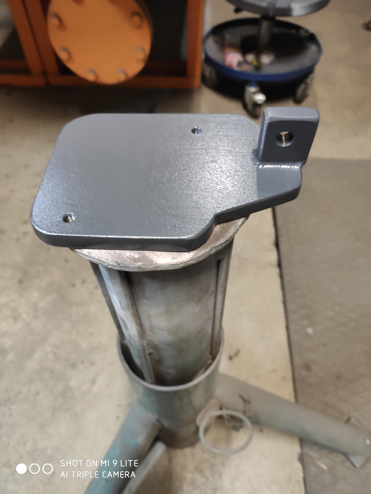

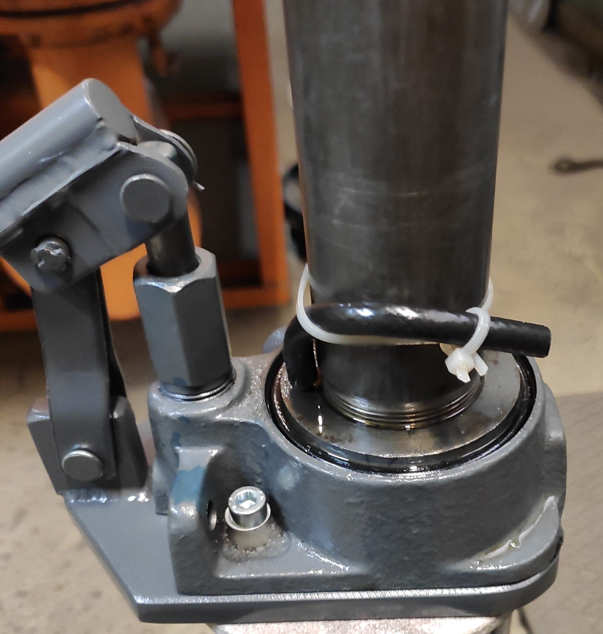

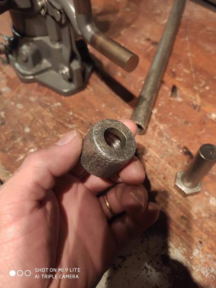

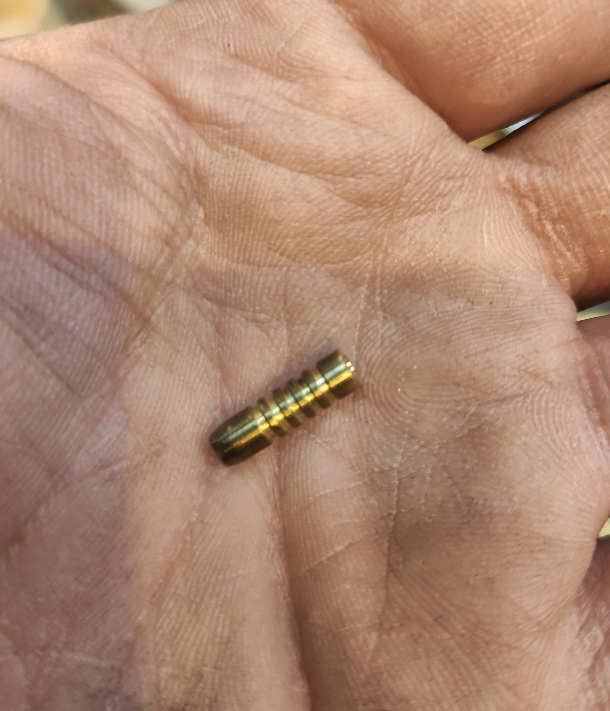

    Brass pipe fitting and a piece tube, are used to get jack to work sideways too. ( or upside down, if wanted )
    Fitting is hammered to its place. Brass is softer than cast steel, so it doesn't crack it easily. But gives tight connection
    Diy hydraulic puller / pusher-32.jpgDiy hydraulic puller / pusher-33.jpgDiy hydraulic puller / pusher-34.jpgDiy hydraulic puller / pusher-35.jpgDiy hydraulic puller / pusher-36.jpg

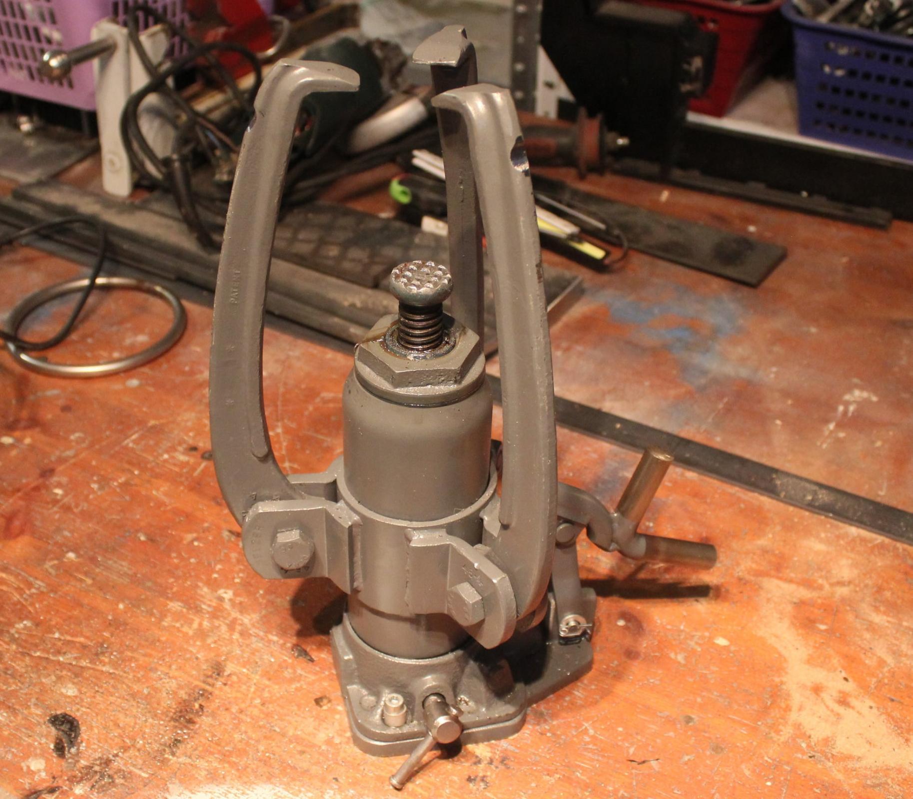

    Finished
    Because you can't actually know.
    How tight those bearings we're.
    I also decided to demonstrate the use, with a task that you can know that it requires some force.

    Finished puller / pusher
    Diy hydraulic puller / pusher-fb_img_1600672795416.jpg
    Diy hydraulic puller / pusher-fb_img_1600672785685.jpg
    Diy hydraulic puller / pusher-fb_img_1600672780553.jpg
    Diy hydraulic puller / pusher-fb_img_1600672776245.jpg

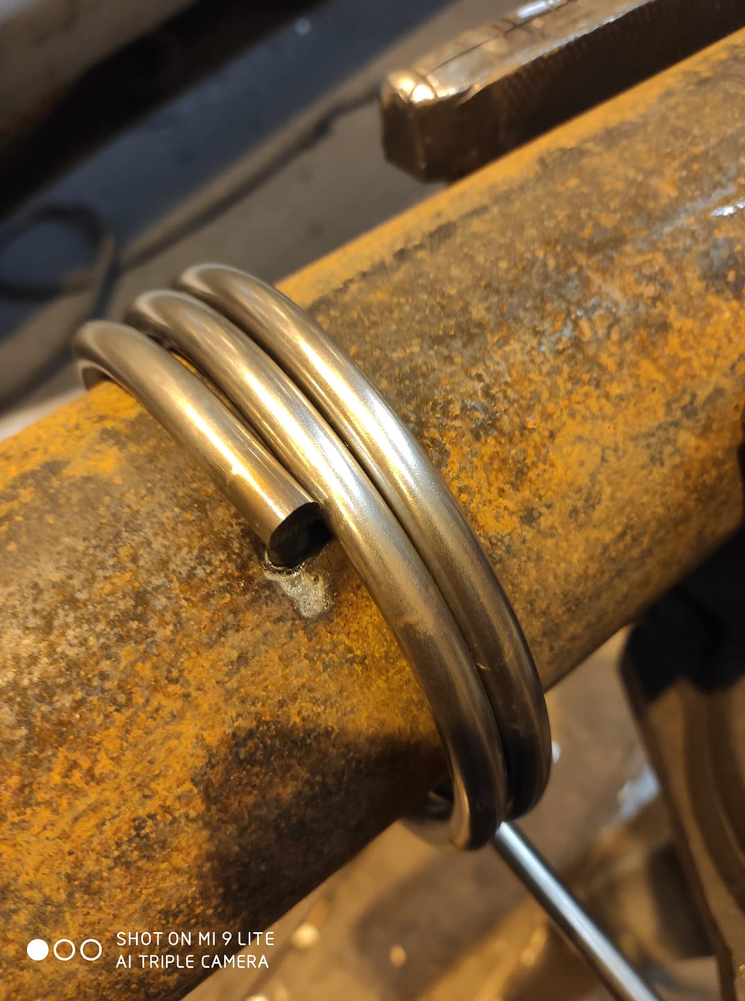

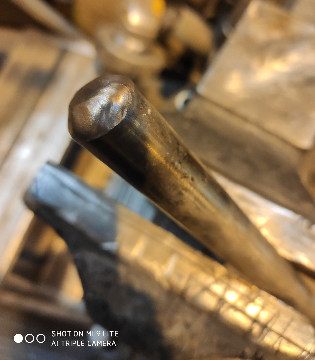

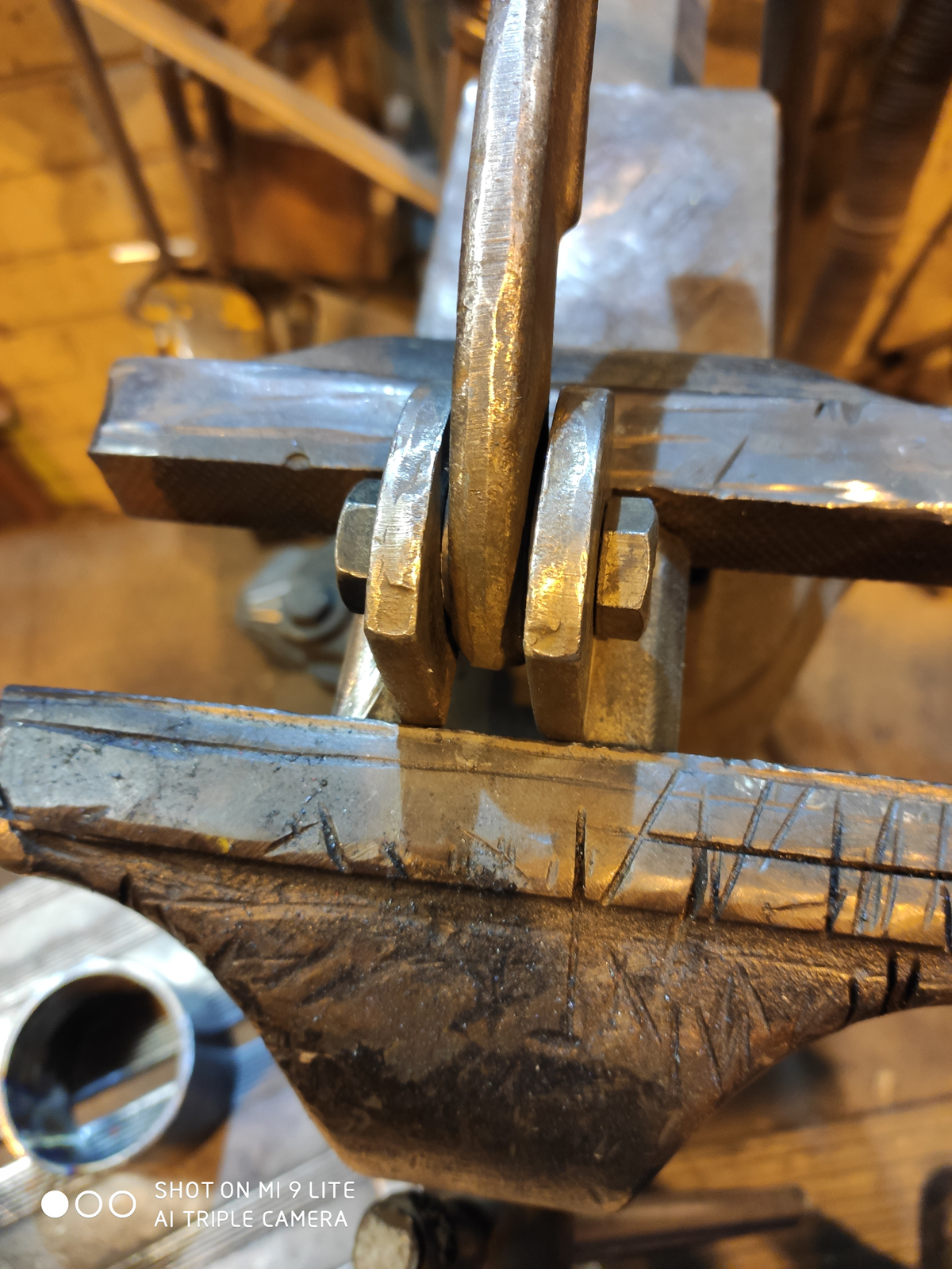

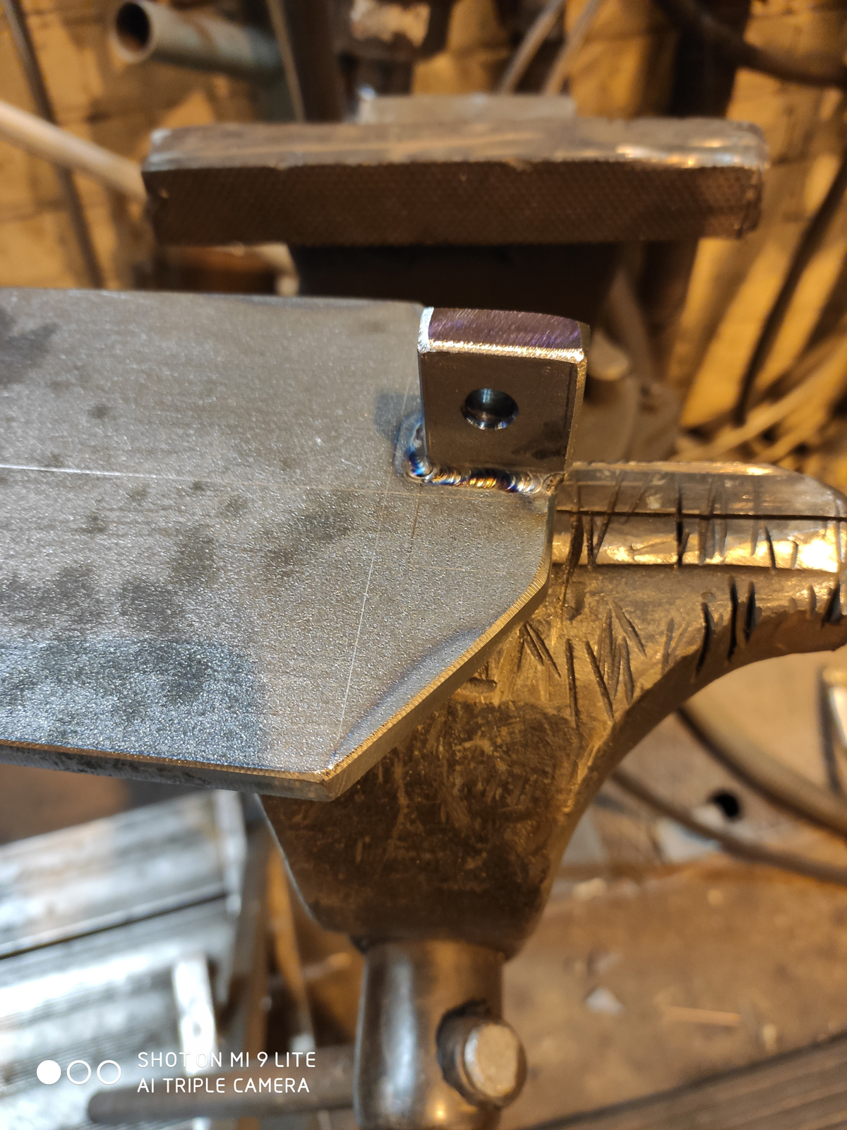

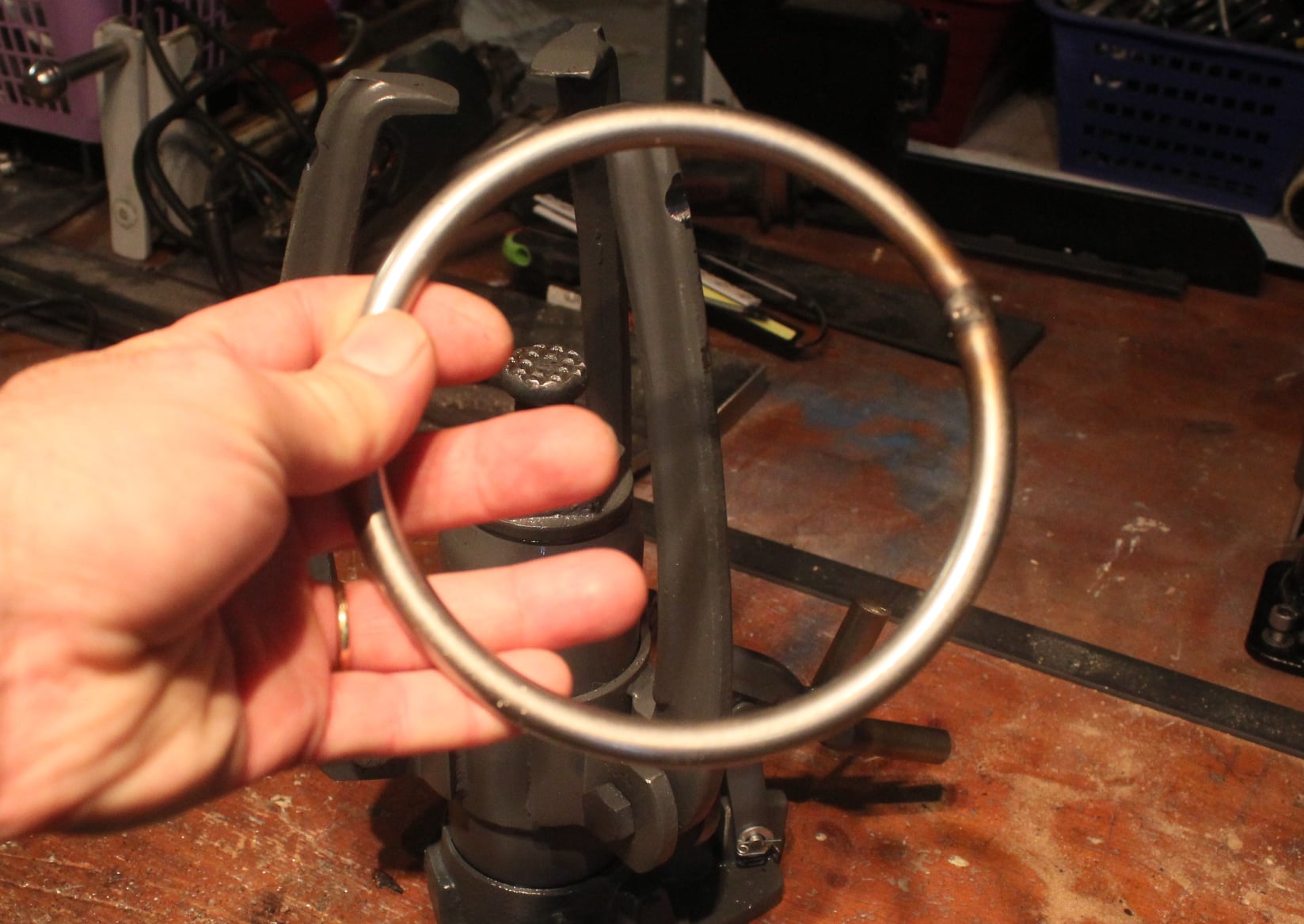

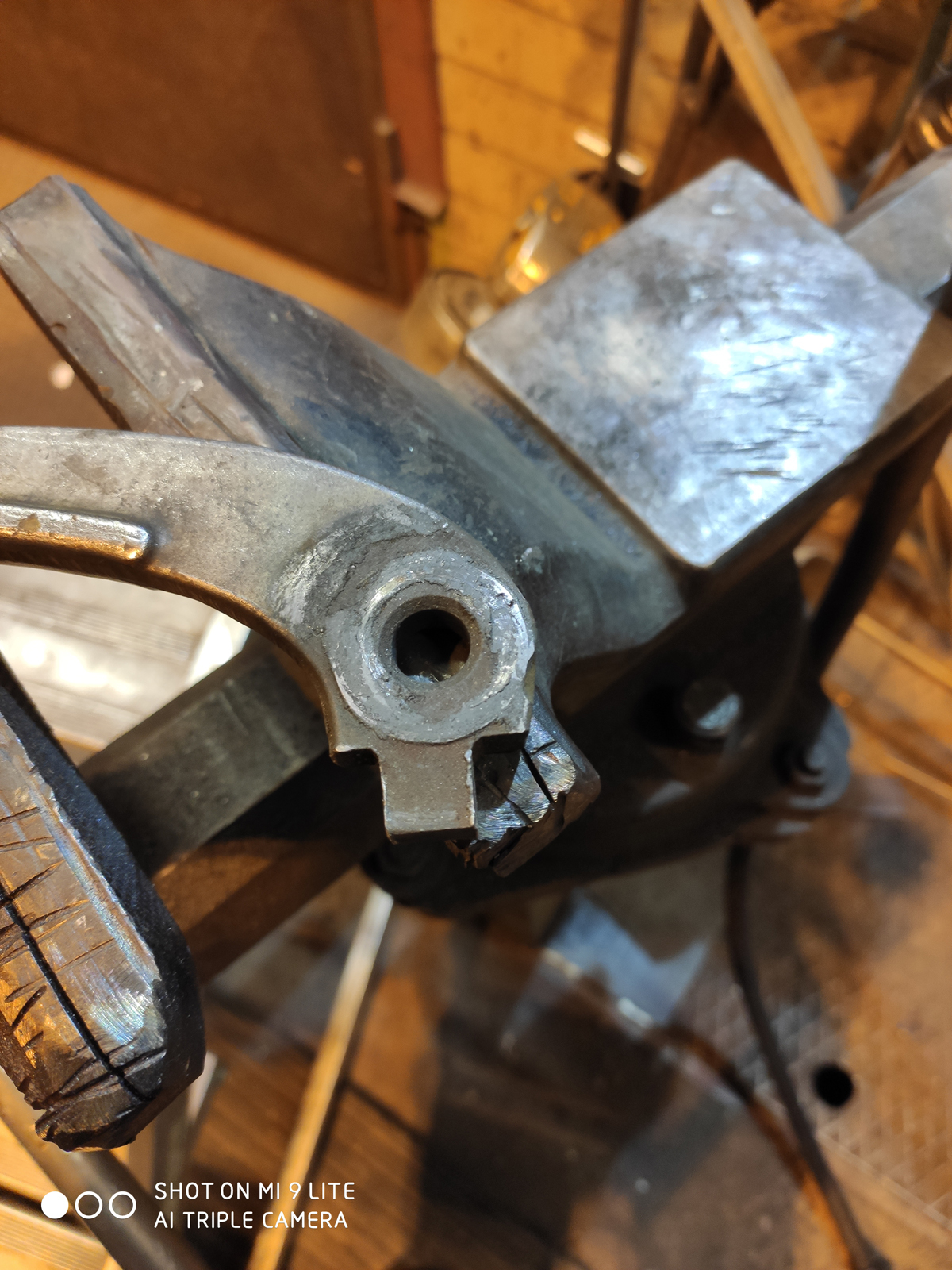

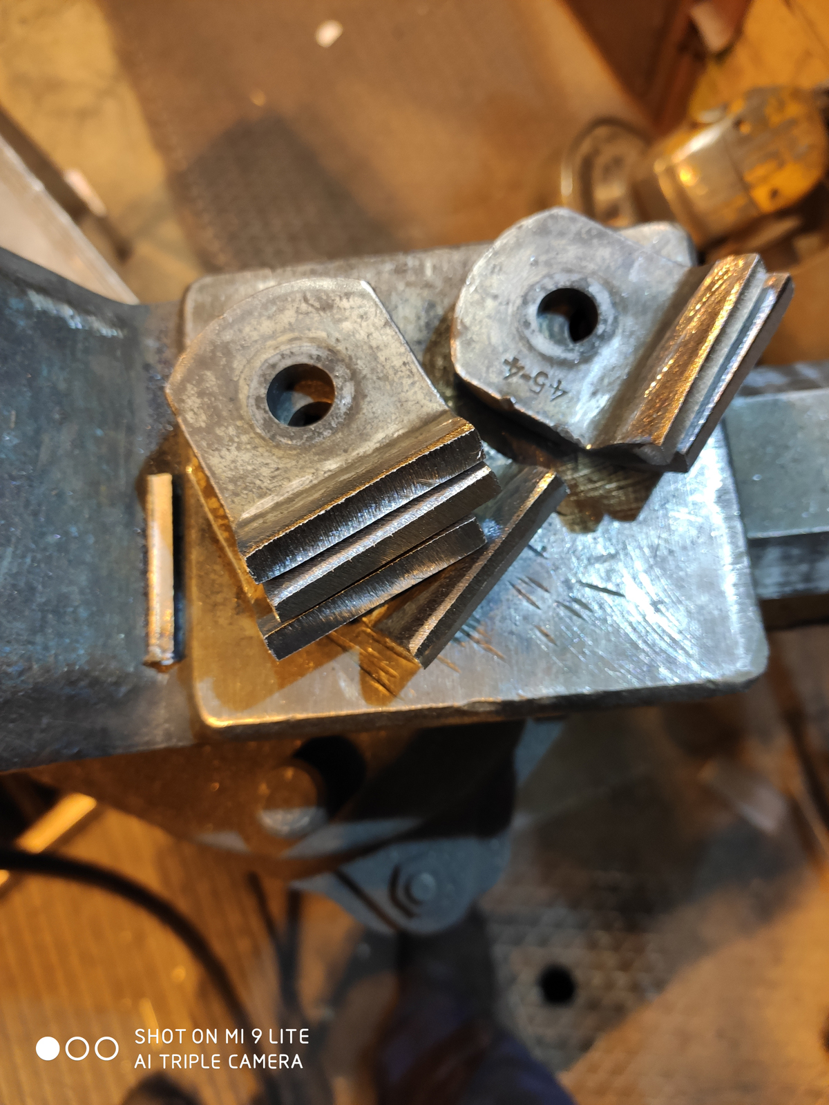

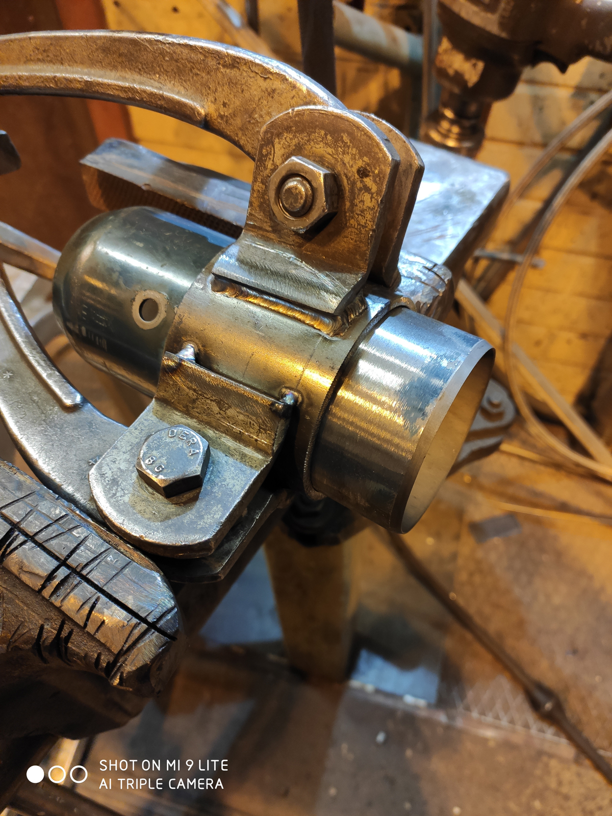

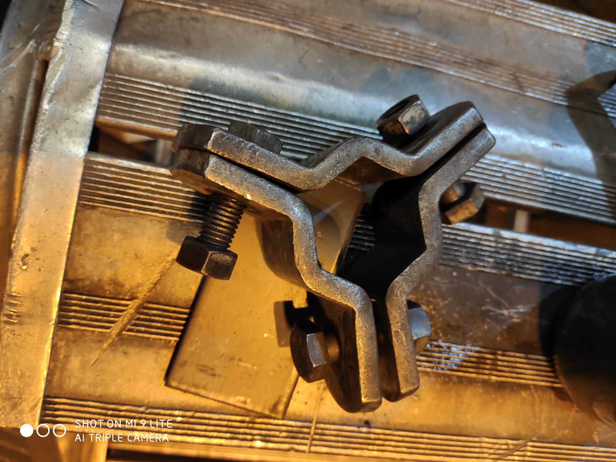

    Here is my simple claw support solution, for removing smaller bearings etc..
    This is made for bigger bearings. So in my use linked joints kind of solutions, would be something that i most likely remove quite fast. ( those prevent some uses )
    Diy hydraulic puller / pusher-37.jpg
    Diy hydraulic puller / pusher-120038036_816180659153577_5306107679476351705_o.jpg
    Small grooves on the claws.
    Diy hydraulic puller / pusher-119989603_816180725820237_1334890680798337862_o.jpg
    Diy hydraulic puller / pusher-120016953_816180645820245_3342963981412455507_o.jpg

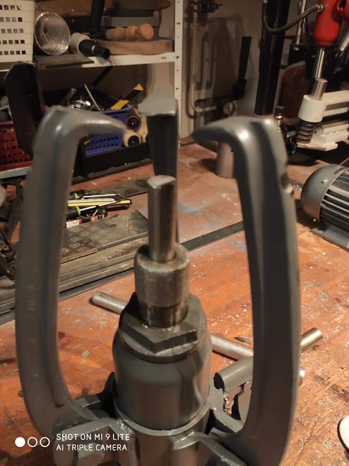

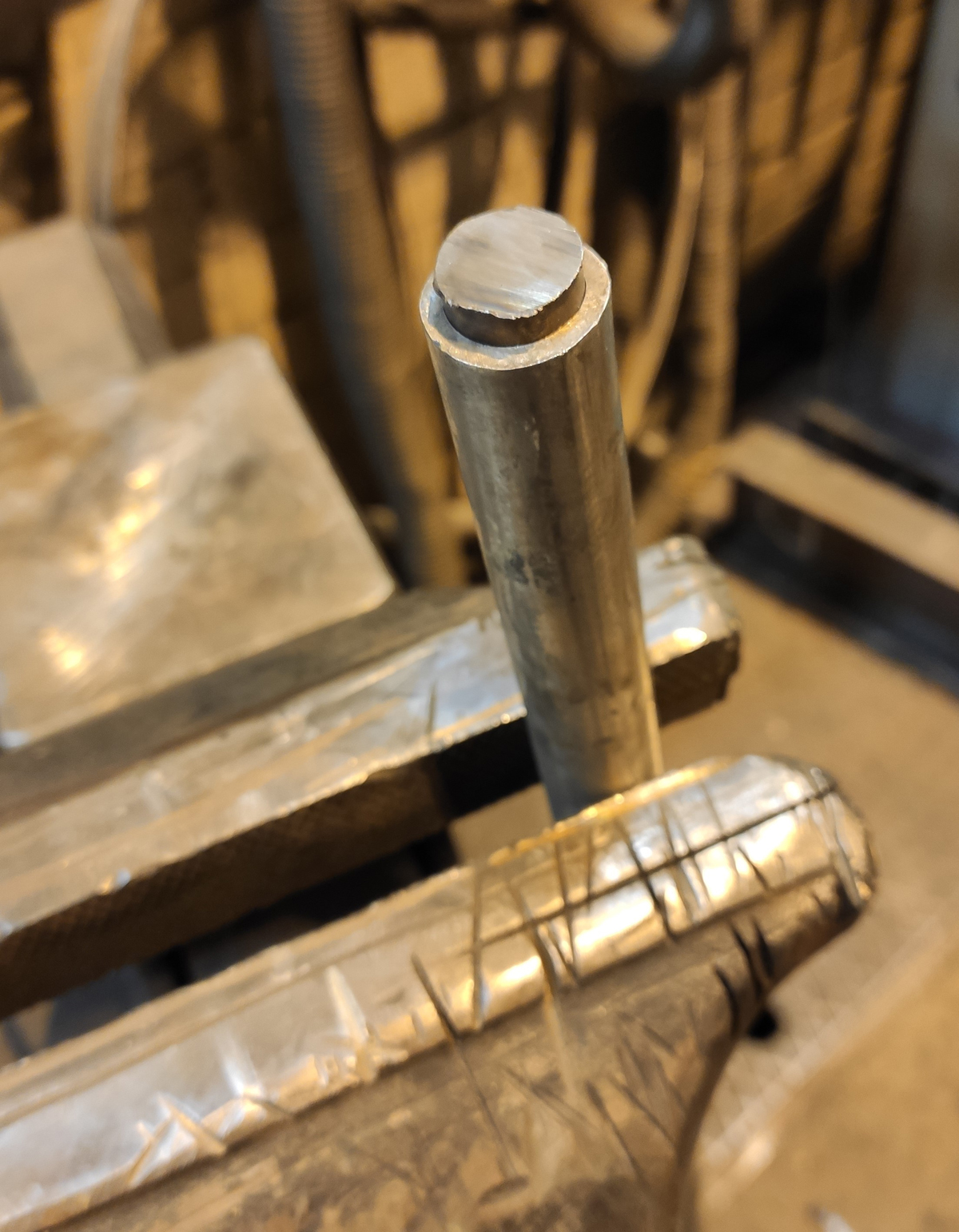

    Simple add for the smaller axles. Pictures from it comes later today.
  13. #10
    Jun 2016
    Jyväskylä Finland
    832
    558
    Thanked 1,877 Times in 508 Posts
    Tuomas's Tools

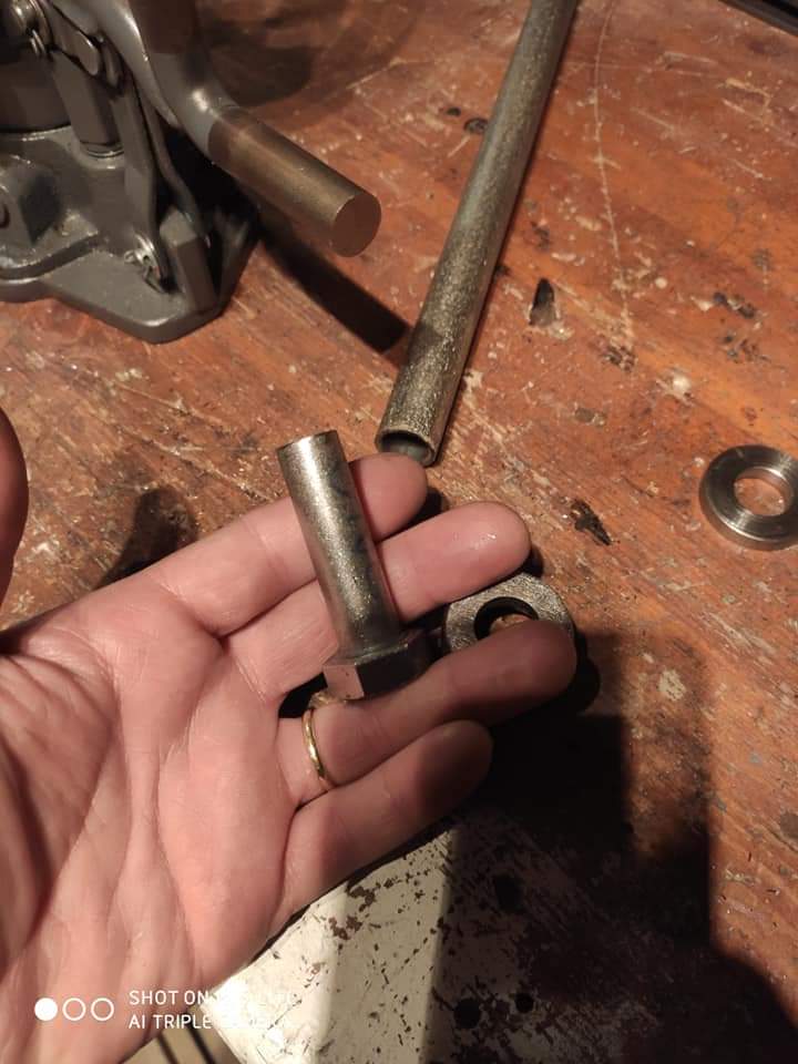

    And here is my solution for pushing smaller axles.
    Diy hydraulic puller / pusher-fb_img_1601009474360.jpg
    Diy hydraulic puller / pusher-fb_img_1601009478997.jpg
    Diy hydraulic puller / pusher-fb_img_1601009483380.jpg
    Diy hydraulic puller / pusher-fb_img_1601009489129.jpgDiy hydraulic puller / pusher-fb_img_1601009493900.jpg
