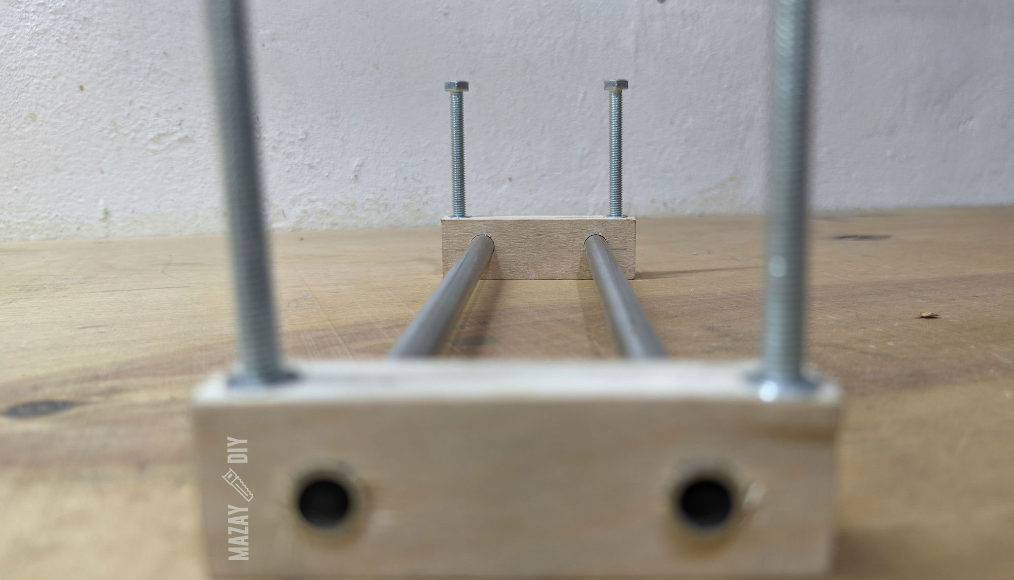

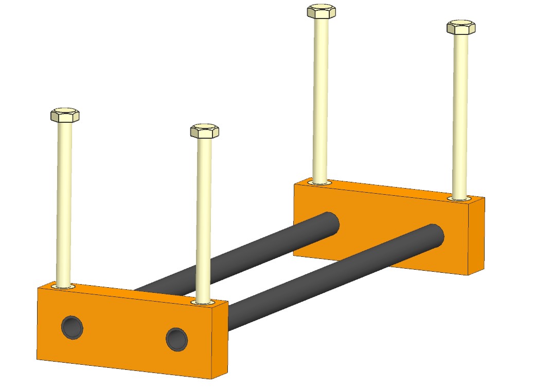

    Easy to make Grinding Wheel Balancing System
    Download Free plans
    DIY grinding wheel balancing jig-homemade-grinding-wheel-balancer.jpg DIY grinding wheel balancing jig-grinding-wheel-balancer.jpg
    3D CAD model
    Download plans for bench grinders.

    Drilling (or any modification) to a grinding wheel is unwise. Balance should be corrected with a weight balancing washer. Example, drill holes in a steel washer to get the needed offset weight.

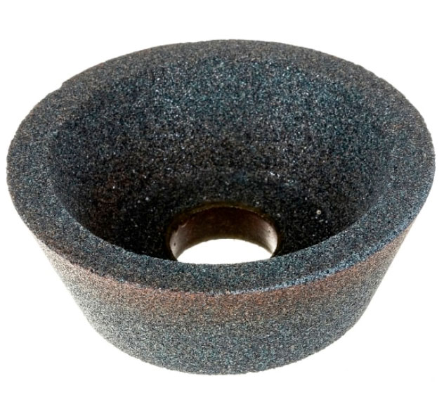

    That being said, I would like to point out a few reasons why I initially considered this method acceptable:
    - Cup Grinding Wheels are produced;

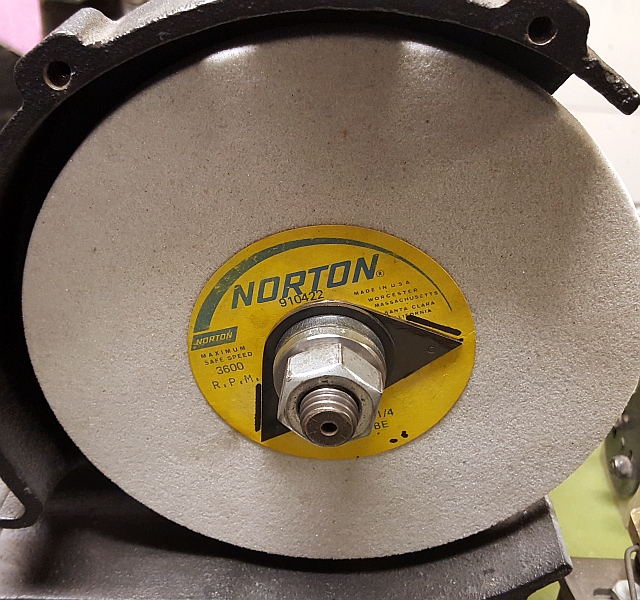

    I like this method - it's not as simple as the one I demonstrated, but it is 100% safer:
    DIY grinding wheel balancing jig-nortonwheelbalanced.jpg.
    Source - http://www.nwnative.us/Grant/shop%20...ble/balancing/.

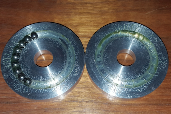

    I like this concept from the above post. Only thing is, it would take up too much space on most grinder arbors.
    They used to make a "ring" partially filled with round steel balls. (Think Hula-Hoop with some ball bearings in it) You would attach them inside the wheels on your car. Then they automatically balance your wheels. Front loading washing machines have fluid filled rings around the tub to balance during the spin cycle.

    You posted a picture of a cup wheel I can relate to what could have been a disaster to something that happened with one of those on a grinder one time. A young apprentice I won't mention any names for reasons of self-incrimination, yes I will. I couldn't have been much more than 13 or 14 when I needed to sharpen a batch of drill bits at the blacksmith shop where I worked we had a huge belt driven arbor grinder, on 1 side is had a 3" wide 20" wheel on the other end of the shaft was a much smaller cupped wheel of about 12" in diameter with a 1-1/2" face. the face had a deep groove cut in it, very possibly caused by me. so instead to taking the time to dress it like I knew I should have I started grinding the bits on the tapered side of the cupped wheel, fortunately, I was stopped before I had done too much damage tot eh side of the wheel and it was explained to me what I could cause to happen. Guess what no more side wheel grinding from me to this day
