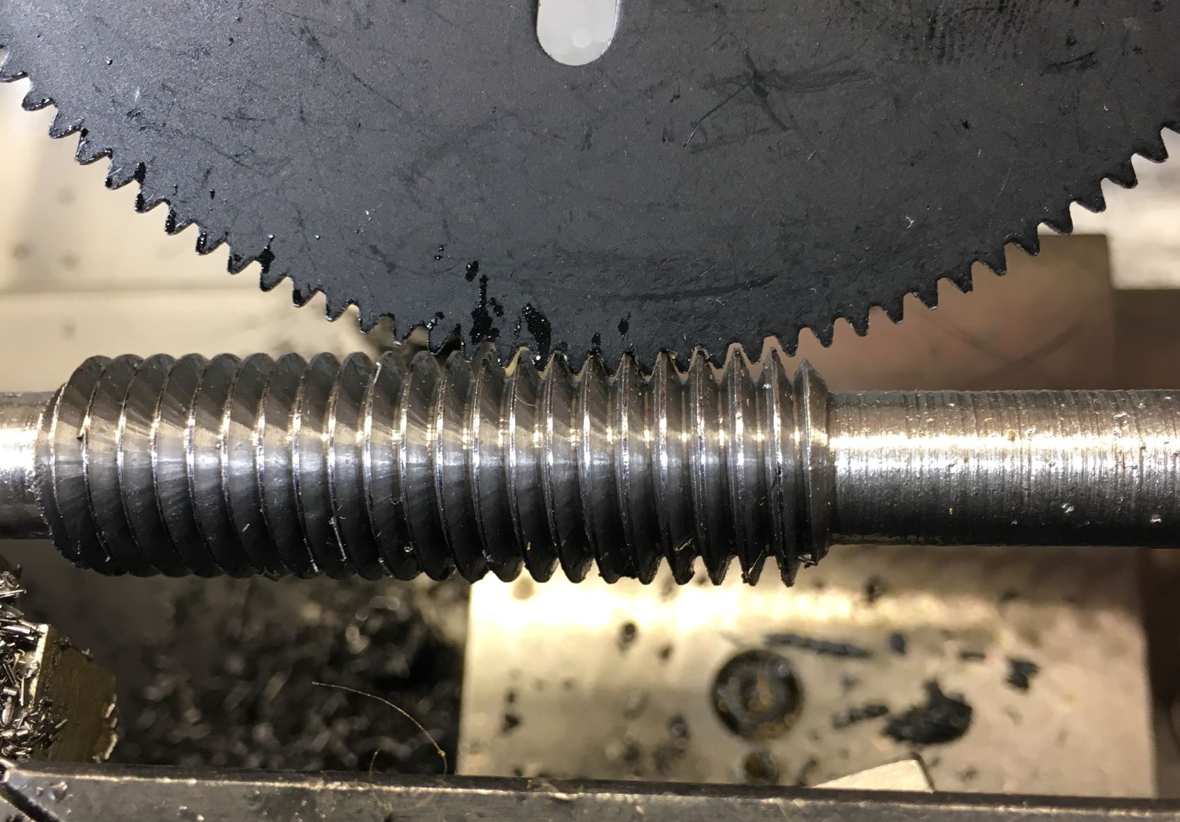

    Thanks, Bob for your tips and encouragement. As you say, mill relieving the hob blank's teeth is usually "good enuff", but...
    I'm thinking along the following lines:
    Relieving the rear of the hob's tooth, you (merely) mill away the teeth TOPS,
    while at the root, the flanks will still cut/ rub the top of the gear-to-be, right?
    The Eureka tool jabs the form tool into the blank - relieving the top ONLY by deepening the bottom flanks.
    Here I might be barking up the wrong tree - as the eventual rubs would be of only marginal importance?
    Now, a Eureka for hob making (though in my small scale mini lathe) would be quite a cumbersome project for my "closet shop", SO:
    I'm thinking in perhaps trying to have my rigid tool-post grinder setup with a 40 deg rotary HSS file, AND
    making a quick-and-dirty cross slide infeed eccentric synchronized w the spindle,
    so as to make this infeed 4 times per spindle rev - thus relieving ONLY the hob's bottom flanks.
    Then it would be easy to relieve the tops by merely filing axially.
    Any thought on this would be much appreciated. Johan

    Johan...making a hob is quite quick and easy...the plunge cuts are the only cuts that need to be right on the mark and any plunge cut on a small lathe can be a bit trying but is doable once you get a hang on it with your lathe...how you relieve the back of the teeth can be how you want to do it...I set up my hob with a tail-stock center now and form the relief with a slitting saw...I've stopped using an end mill...it does not make a better hob it just is a better set up for me...get your plunge cuts right and how you relieve the cutting edge is what works best for you...a small patch of material behind the cutting edge will rub but I've never had any problem with this...I've made several hobs and all worked very well...also the multi-tooth cutters I use for clocks have the cutting edge relieved the same way with no problems......bob

    Thanks Bob - I guess you were absolutely right:
    DIY Gear Cutter: The Eureka Tool-38-dp-20-pa-14-mm-od-mild-steel-hob-test.jpg
    Proof of concept in making and checking an operational hob from a piece of BMS-
    half an hour for setup the homegrown & 3D printed 12 TPI change gears, the 20 deg compound angle and 40 deg tool,
    and another half hour in cutting, by feeding in the compound 95 thou (2,42 mm).
    Worked consistently throughout, with only minor chatter problems.
    Guess the traveling steady will help against that when all-treading the 250 mm x 14 mm drill rod, parting, relieving etc.
    Thanks for your encouragement!
    Johan
