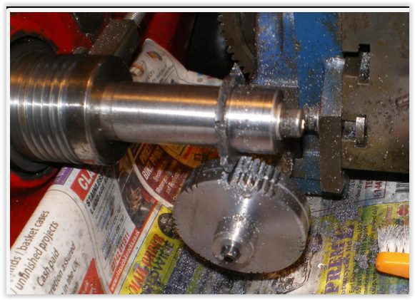

    A very nicely made example of this tool, I enjoyed your video and explanation of the workings of it. I have the Ivan Law book but have not yet made the Eureka tool, I have been using the 4 tooth offset method you mention at around 15 mins and have made many usable cutters with that system the last ones were for my milling attachment.DIY Gear Cutter: The Eureka Tool-screen-shot-01-30-19-05.02-pm.png

    Thanks tmoore4748...Ivan Law's book Gears and Gear Making has a set of plans on the last 3 or so pages of the book. I used these drawing to build the tool. There are no building details there though. The project is pretty straight forward. I am putting a construction video together right now as I took lots of video while I was building. It will be a "show and tell" video as there are lots of approaches to this build. Then I am going back to my grasshopper clock build for a bit (see my U Tube Channel) but will then make a 3rd video on the Eureka tool where I'll make an involute gear cutter with a button tool and the Eureka tool. Thanks again for your interest...bob
