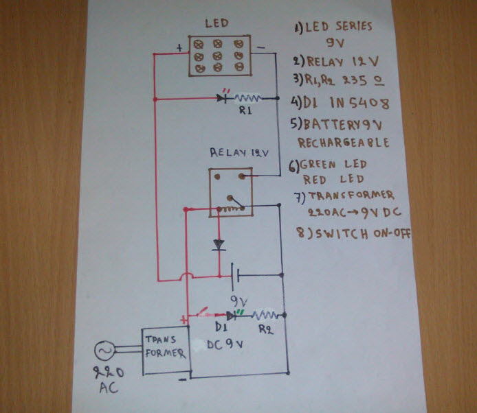

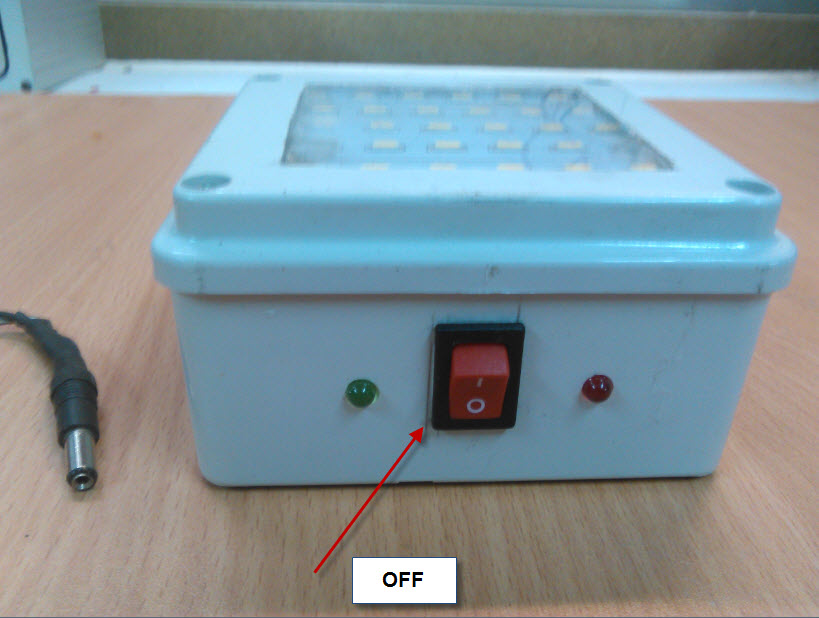

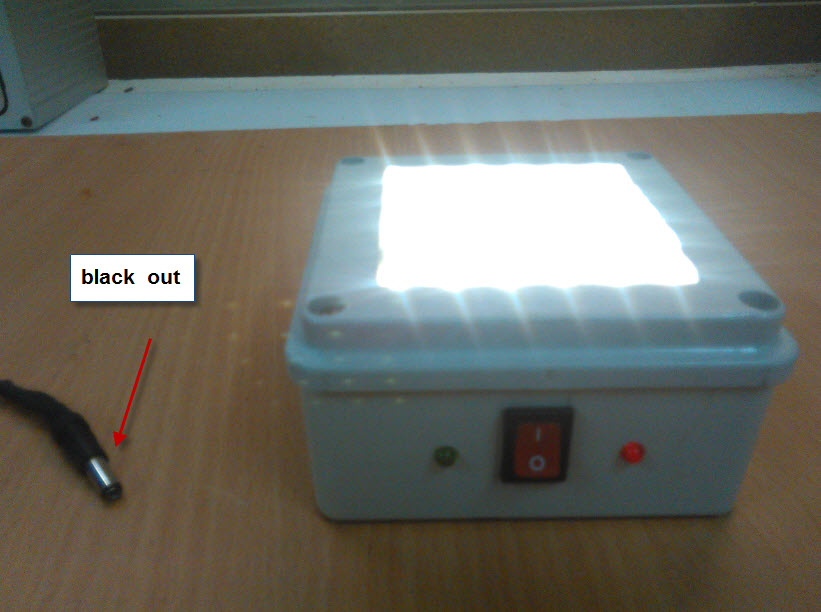

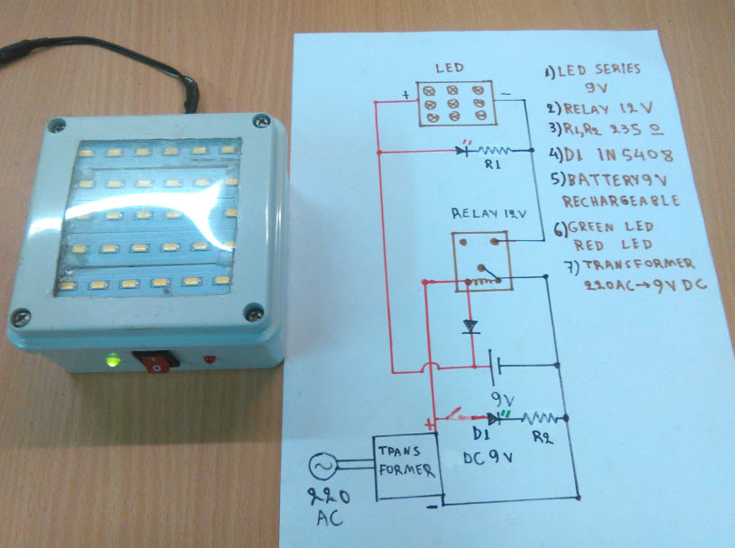

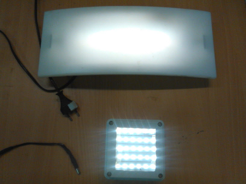

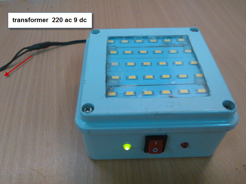

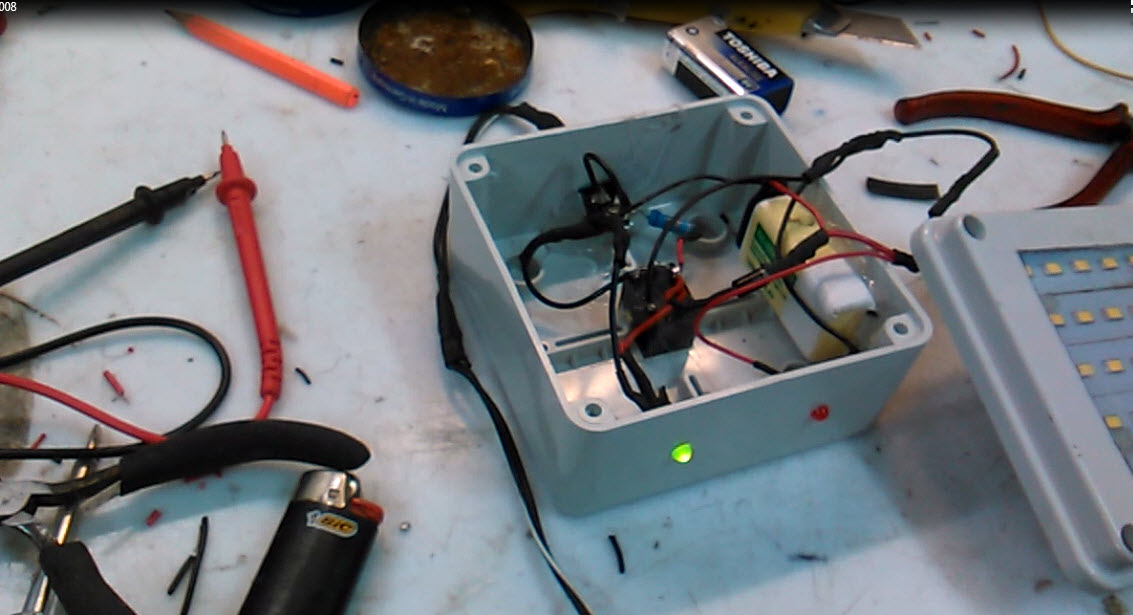

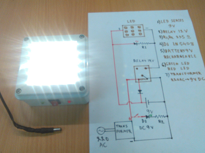

    In this video I tried to make the more simple emergency lighting.It is something useful in case there is a black out.
    You can watch the construction and the use here:
    Attached Thumbnails Attached Thumbnails DIY  EMERGENCY  LIGHTING-f1.jpg   DIY  EMERGENCY  LIGHTING-f2.jpg   DIY  EMERGENCY  LIGHTING-f3.jpg   DIY  EMERGENCY  LIGHTING-f4.jpg   DIY  EMERGENCY  LIGHTING-f5.jpg
