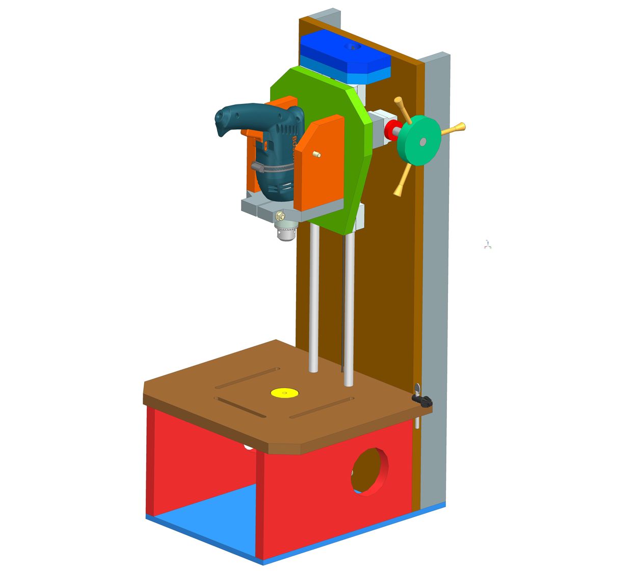

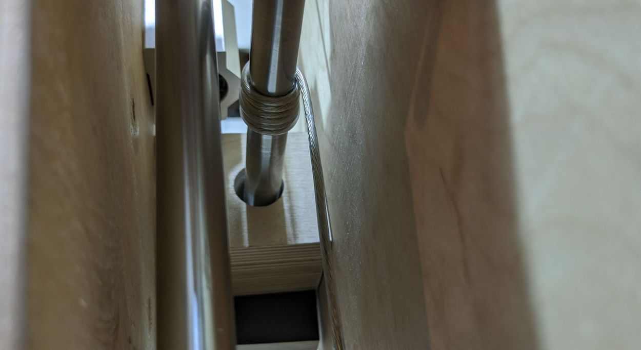

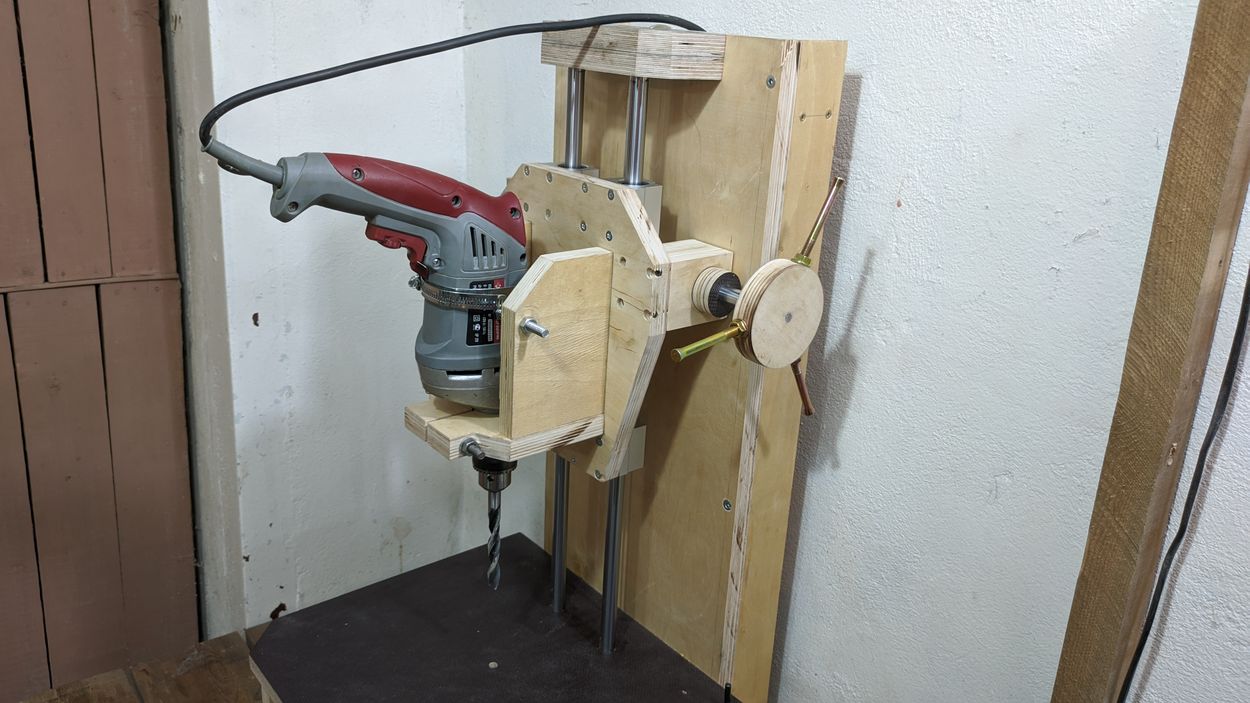

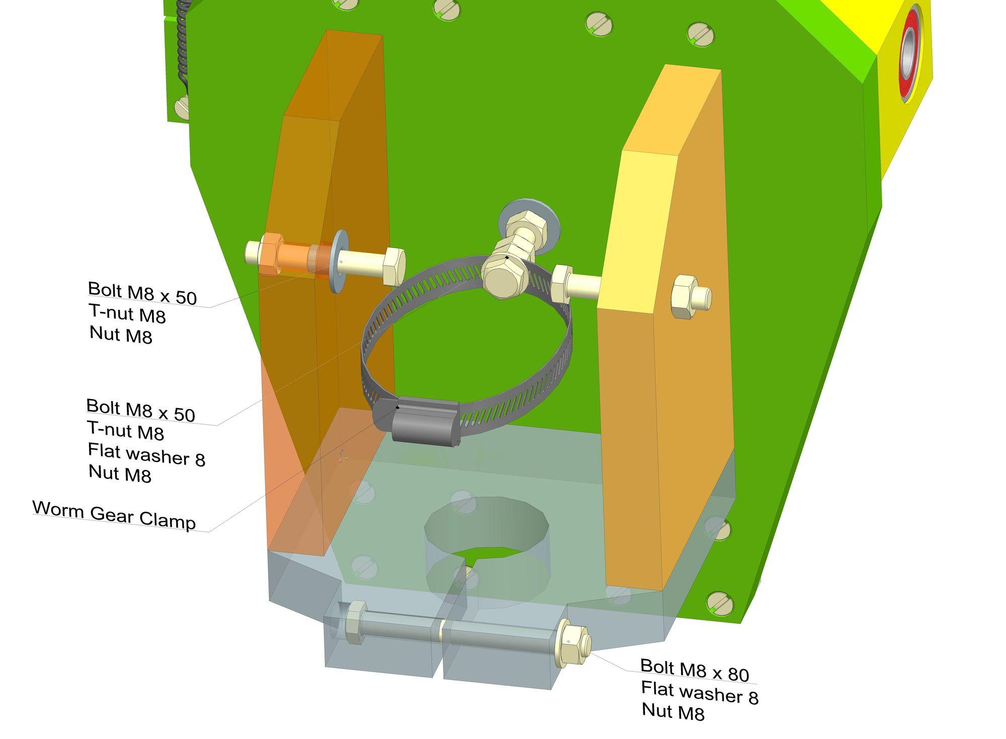

    In my new video I will show you How to build a Homemade Drill Press Stand
