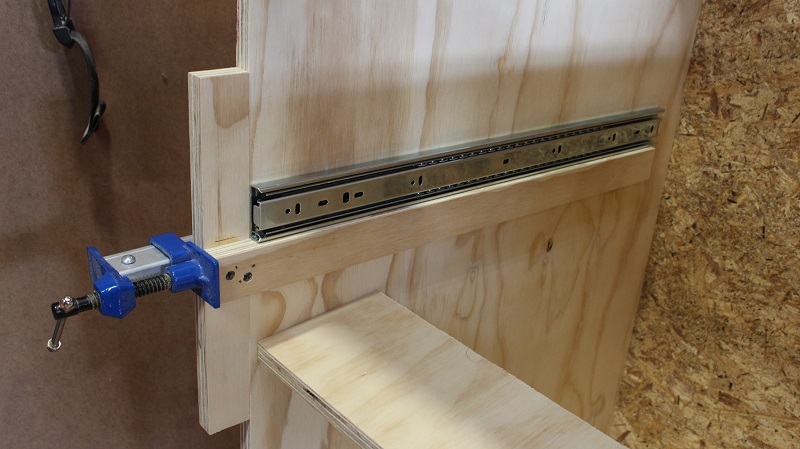

    DIY Drawer Slide Jig (FREE PLANS)
    FREE PLANS IN BOTH IMPERIAL & METRIC DIMENSIONS!!!
    Here’s a very simple, fast, cheap, and easy jig you can make to help locate and hold drawer slides in position while you screw them into place.
    Link to FREE PLANS download here:
