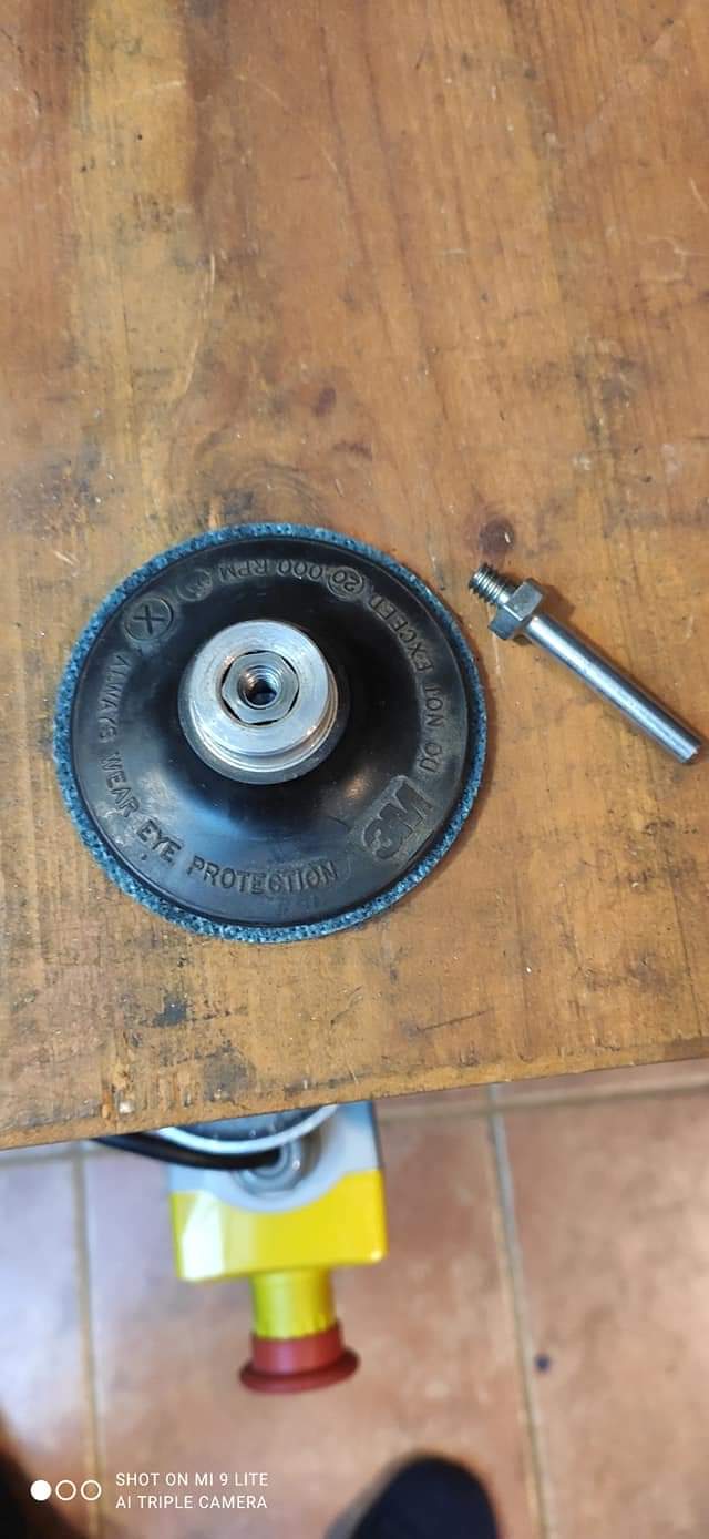

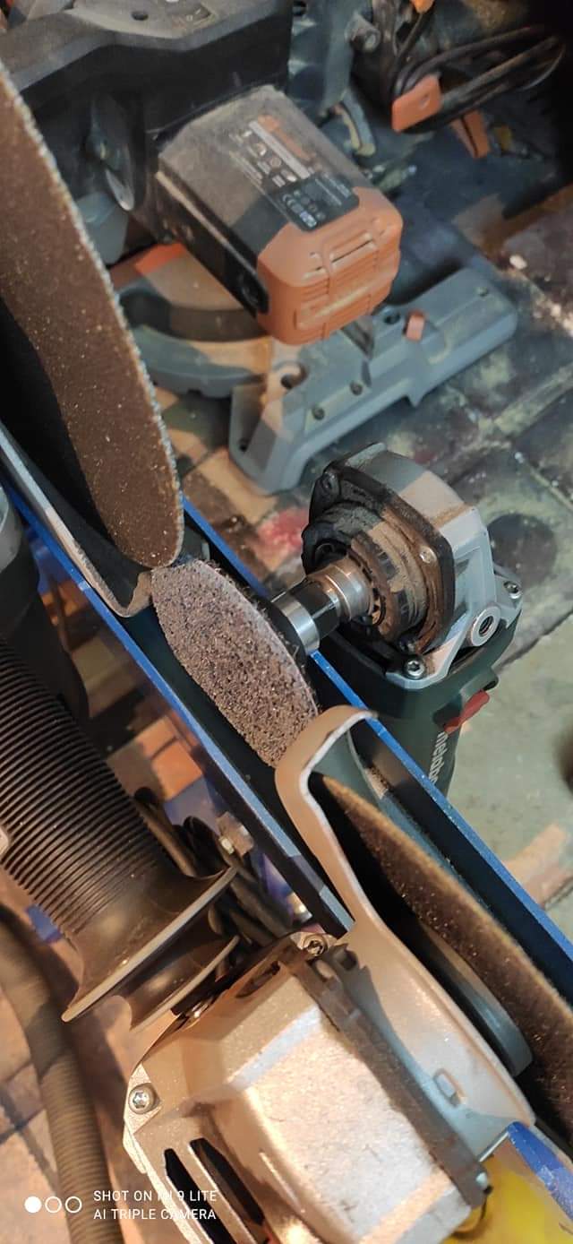

    Btw. Here roloc pads has an insert. When its removed, there's M14 thread and it fits to 125mm angle grinder. Also to my bench grinder.
    I use it with 750w Metabo. Its very small grinder and handy with roloc pads.

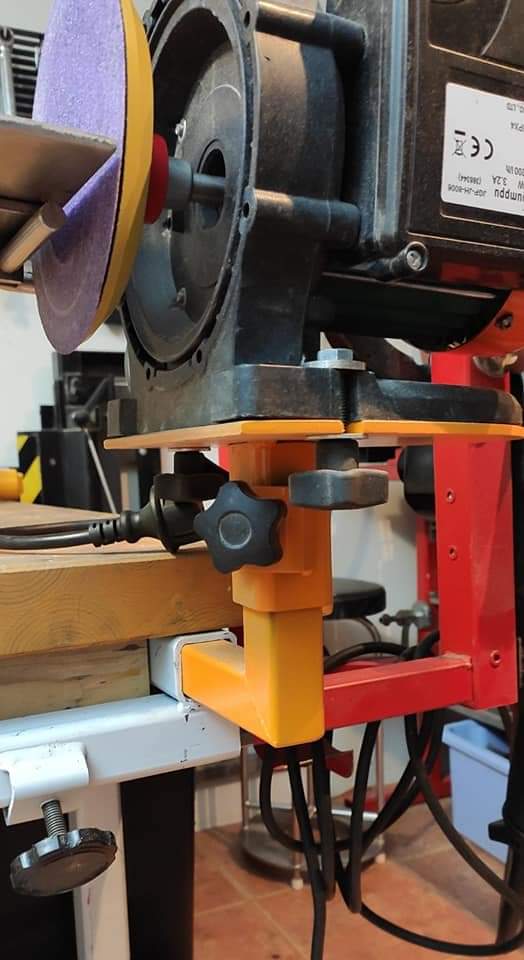

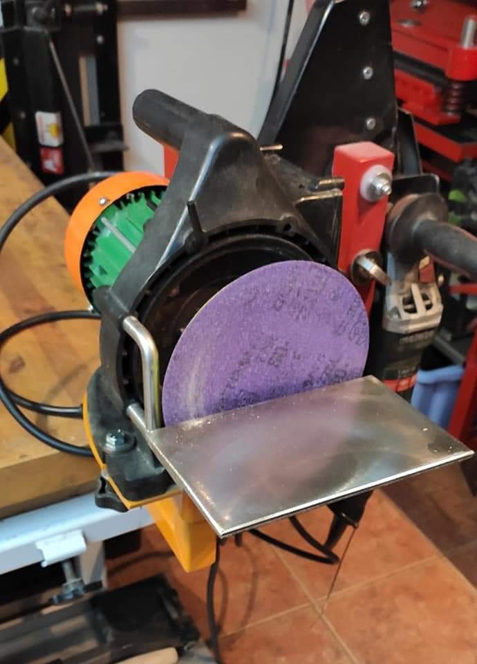

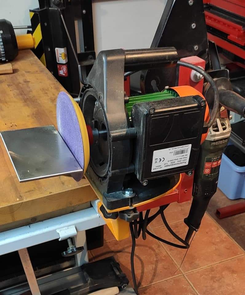

    I made a stand for my diy disc sander. Mounting allows to turn sander to point different directions in 90 degree steps.
    I also made workpiece support plate little bigger.
    Its mounted with thumpscrews, so its still portable.
