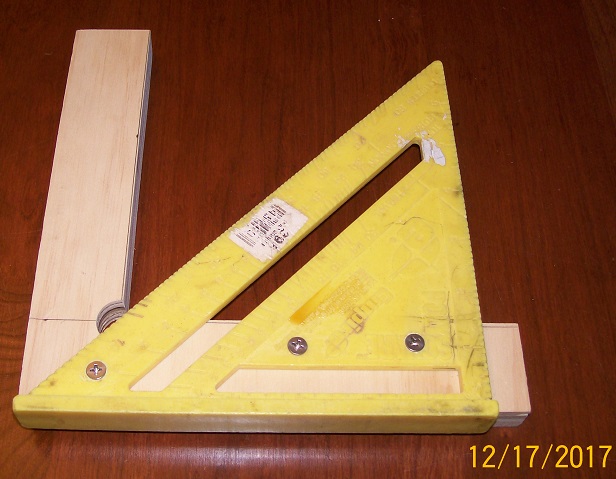

    DIY Circle Center Finder
    FREE Drawing! Details below.
    The DIY homemade circle center finder tool shown in this video only took a few minutes to make and cost me nothing in terms of out-of-pocket funds.
    I have several of the small plastic speed squares around the shop, so I sacrificed one of them for this project. I had some scrap ¾” birch plywood, and plenty of #8 x ¾” stainless steel, flathead, screws on hand. This handy tool would still be quite inexpensive if I had to buy the materials though, and well worth it!
    Materials:
    (1) 8” x 8” square piece of ¾” birch plywood
    (1) small plastic speed square
    (3) #8 x ¾” stainless steel flathead sheet metal screws
    Actual time to make: About 20 minutes.
    Link to Free Drawing (pdf Format): http://www.downeastthunder.com/wp-co...ter-Finder.pdf
    Here's the video:
