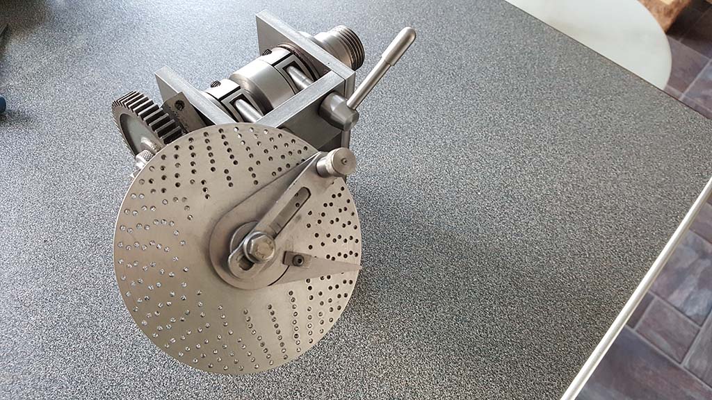

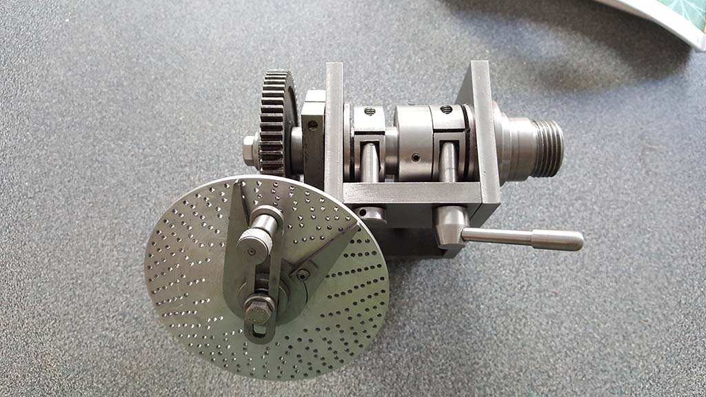

    Hi ,
    I just finished making my dividing head to Harold Halls Design amd I am quite
    pleased with how it turned out as it allows me several ways to do division
    Firstly I can do direct division using a gear wheel

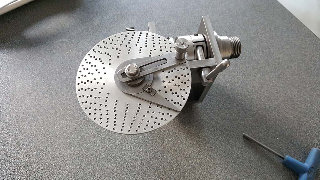

    or I can do direct division using a dividing plate
    and of course I can do compound division using the gear and worm with a dividing plate

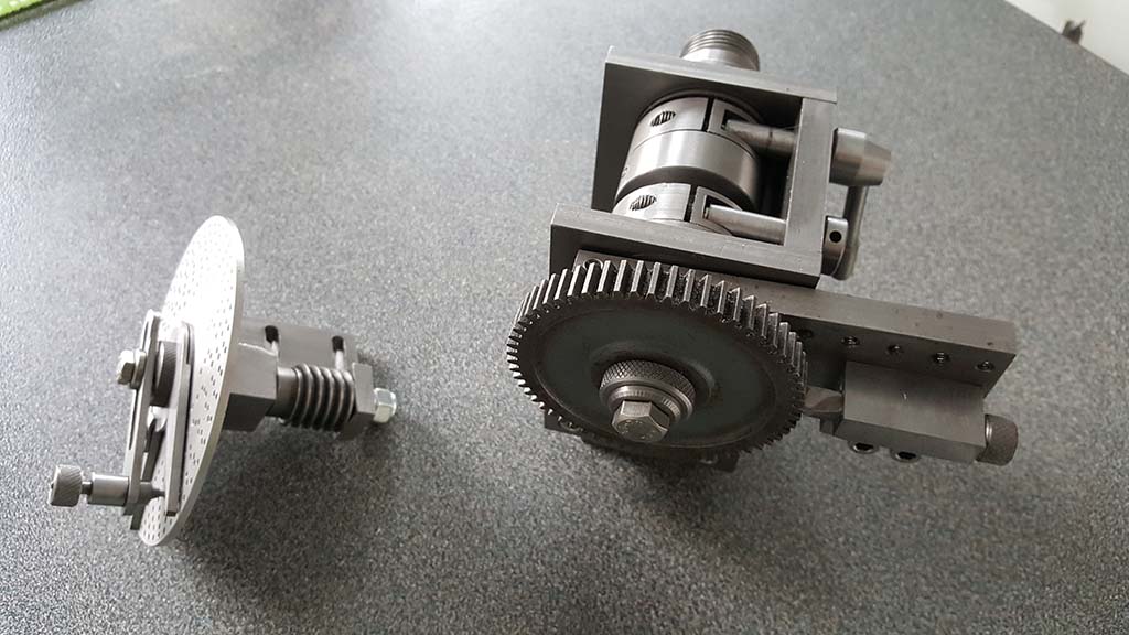

    Unlike a normal dividing head that has a fixed 40:1 , 60:1 or 90:1 ratio I can simply chage the gear wheel
    and have any ratio I want which then gives me more choices for divisions

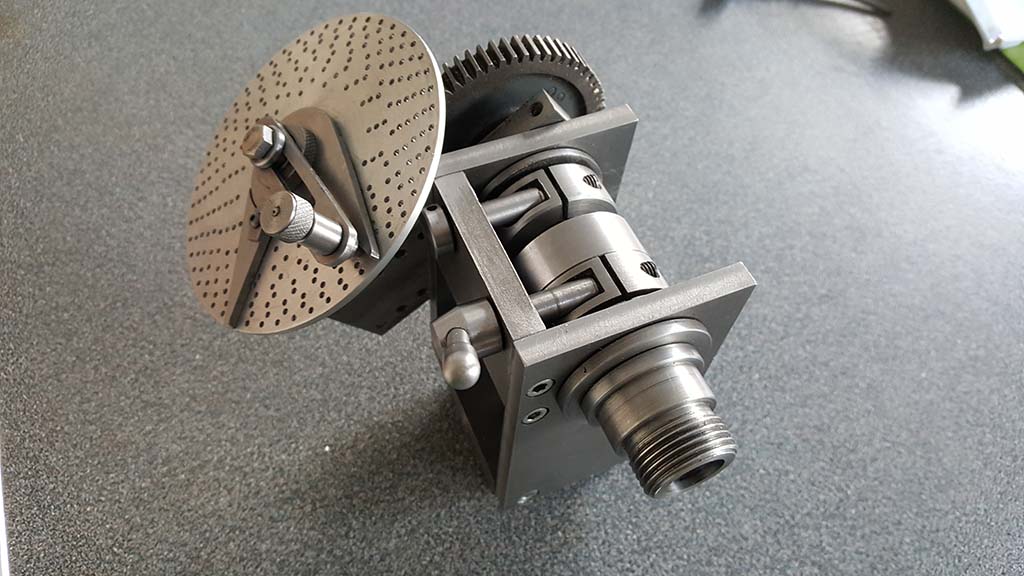

    The nose is made to fit Myford 3 or 4 jaw chucks, . My ER32 collet chuck holder and also has an internal
    morse 2 taper so I can fit morse taper tooling

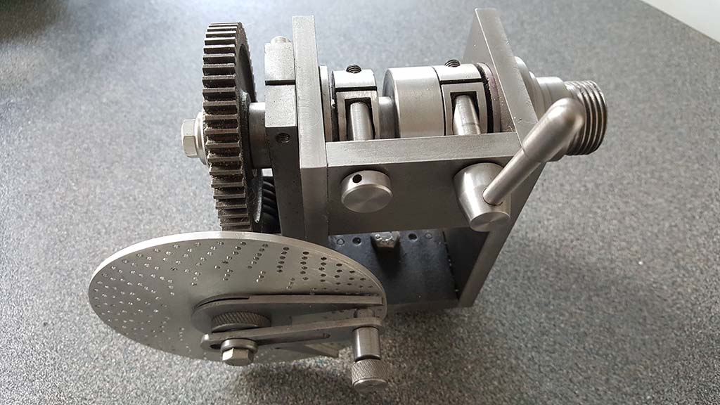

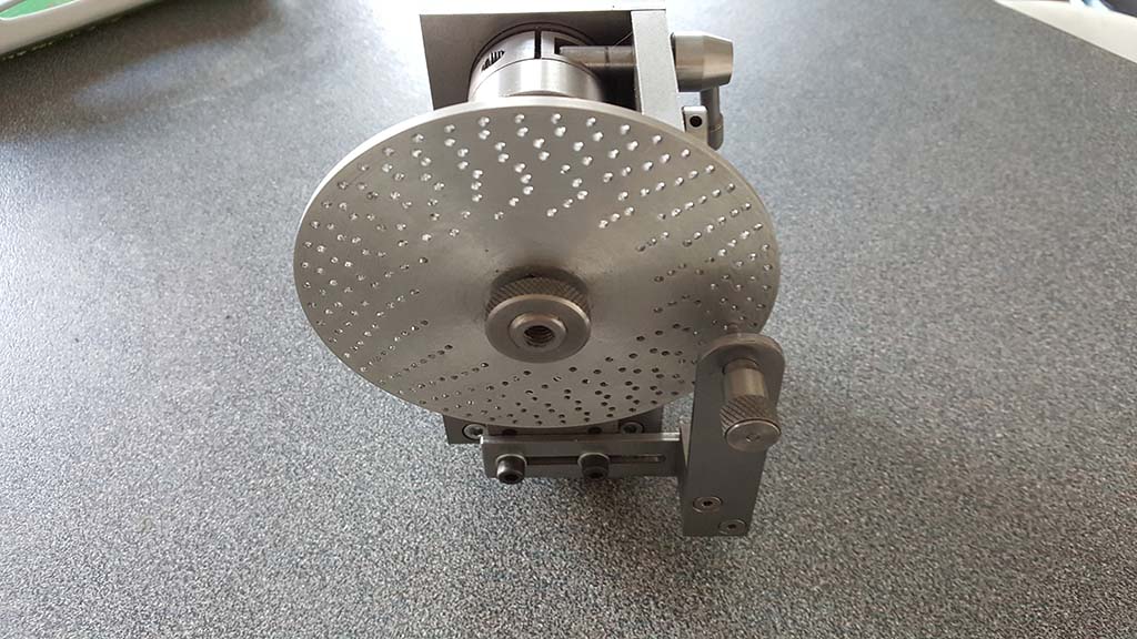

    The didviding end can be swung around to any convenient angle

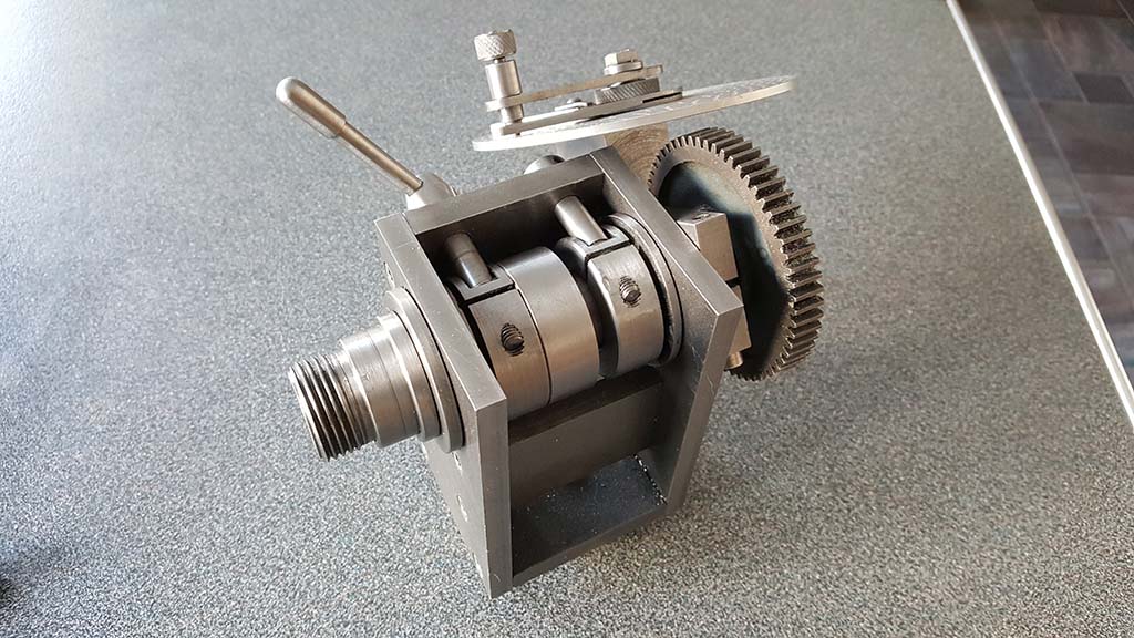

    Here is a view of the other side
    The plans are available in the Workshop Practice Series book number 37 " Dividing "
    I really Like Harolds Designs and have made several , I intend to make his tapping stand next
    Don

    Don,
    Very nice craftsmanship and a versatile design with being able to change ratio the gearing. Thank you for posting your work and providing excellent photos.
    Paul

    Well Done Don, looks like you have made a better job than the original. For me it is encouraging to see it being made, as I consider it to be one of my best, maybe even the best, designs, though I have only been aware of a very small number being made. Having made the video of it there are signs of more taking up the design.
    Should anyone reading this thread be interested the video of it is at this page http://www.homemadetools.net/forum/d...0776#post73113 on the forum.
    Harold Hall
