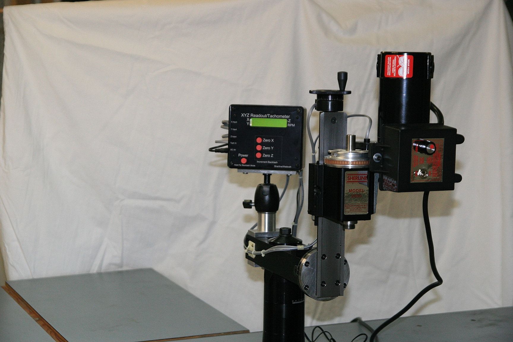

    On the small table was this model 2000 Sherline mill. Well it is what I call my Mini Bridgeport and Radial Arm Drill Press.
    Of course I had to have the digital readouts.

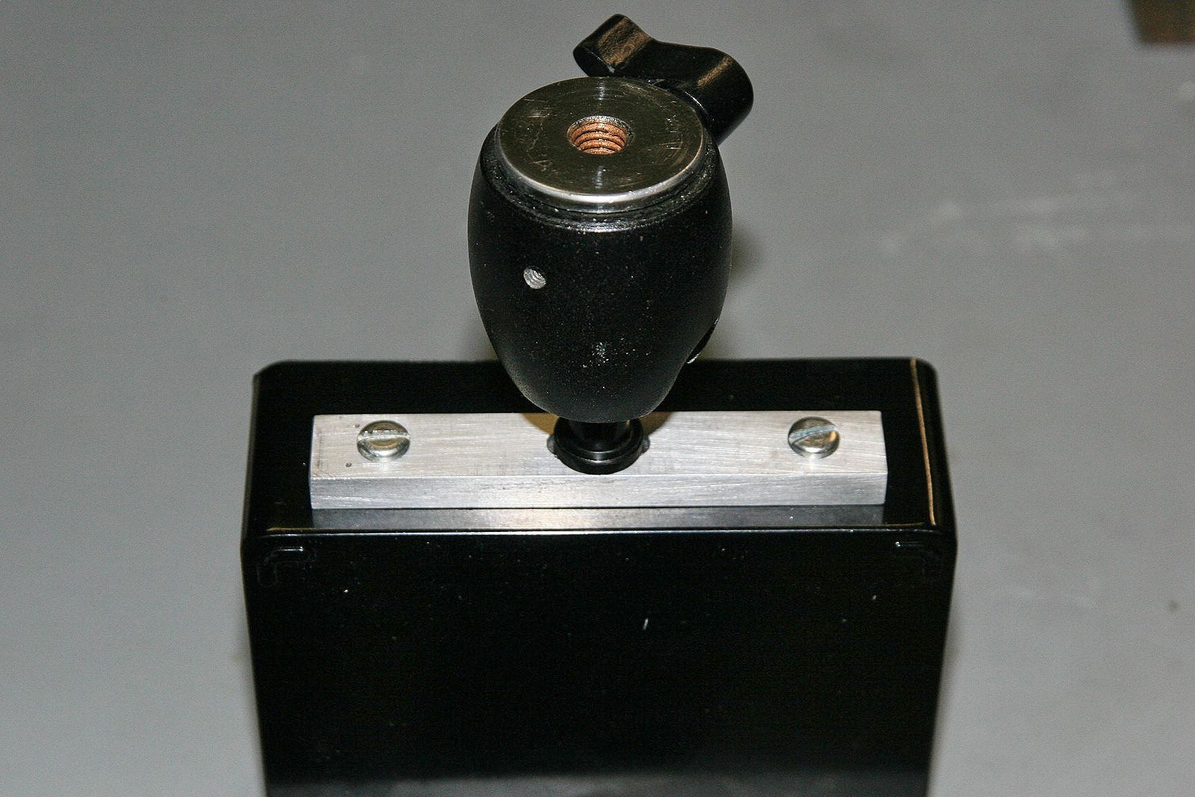

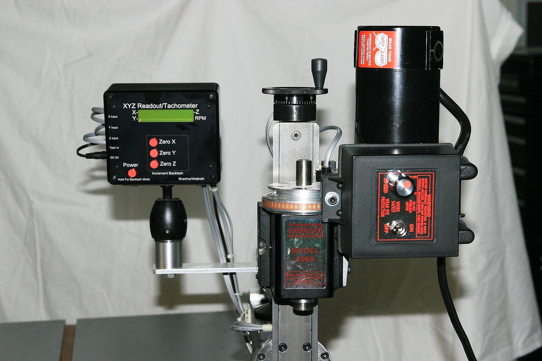

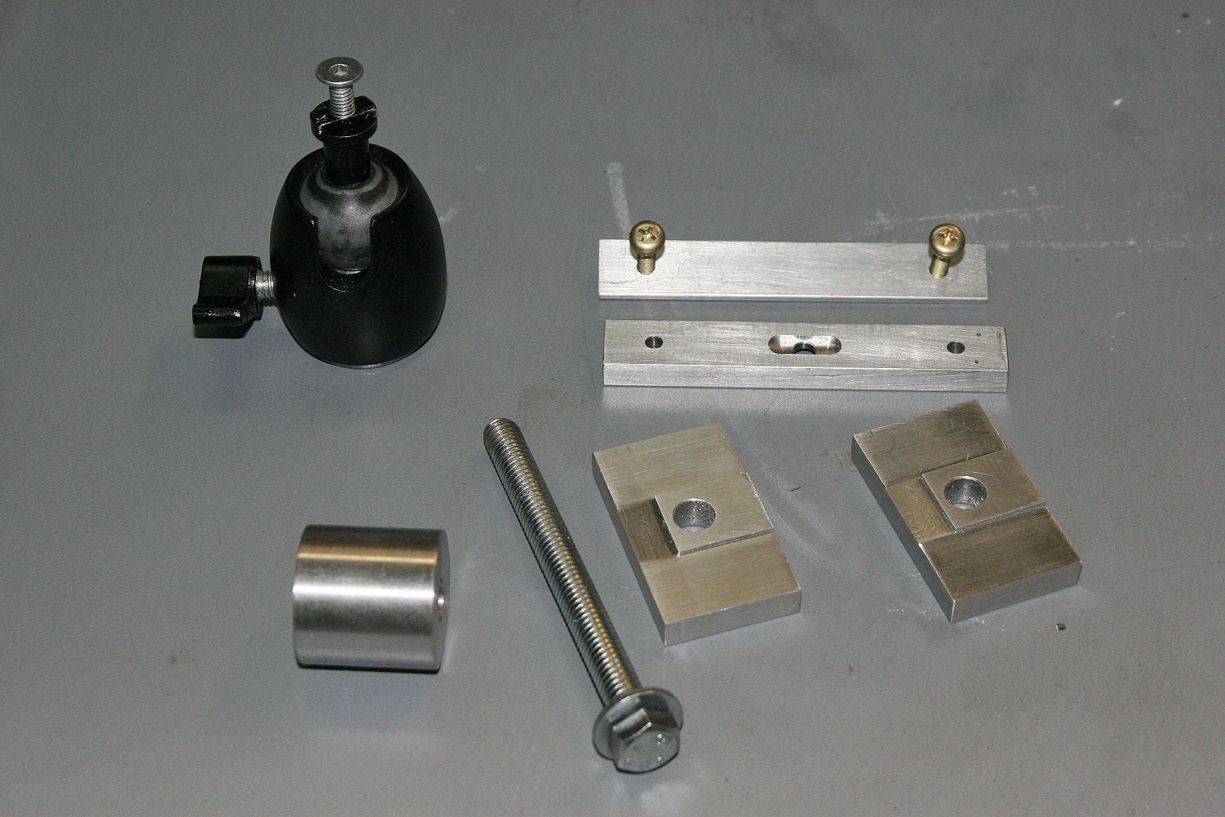

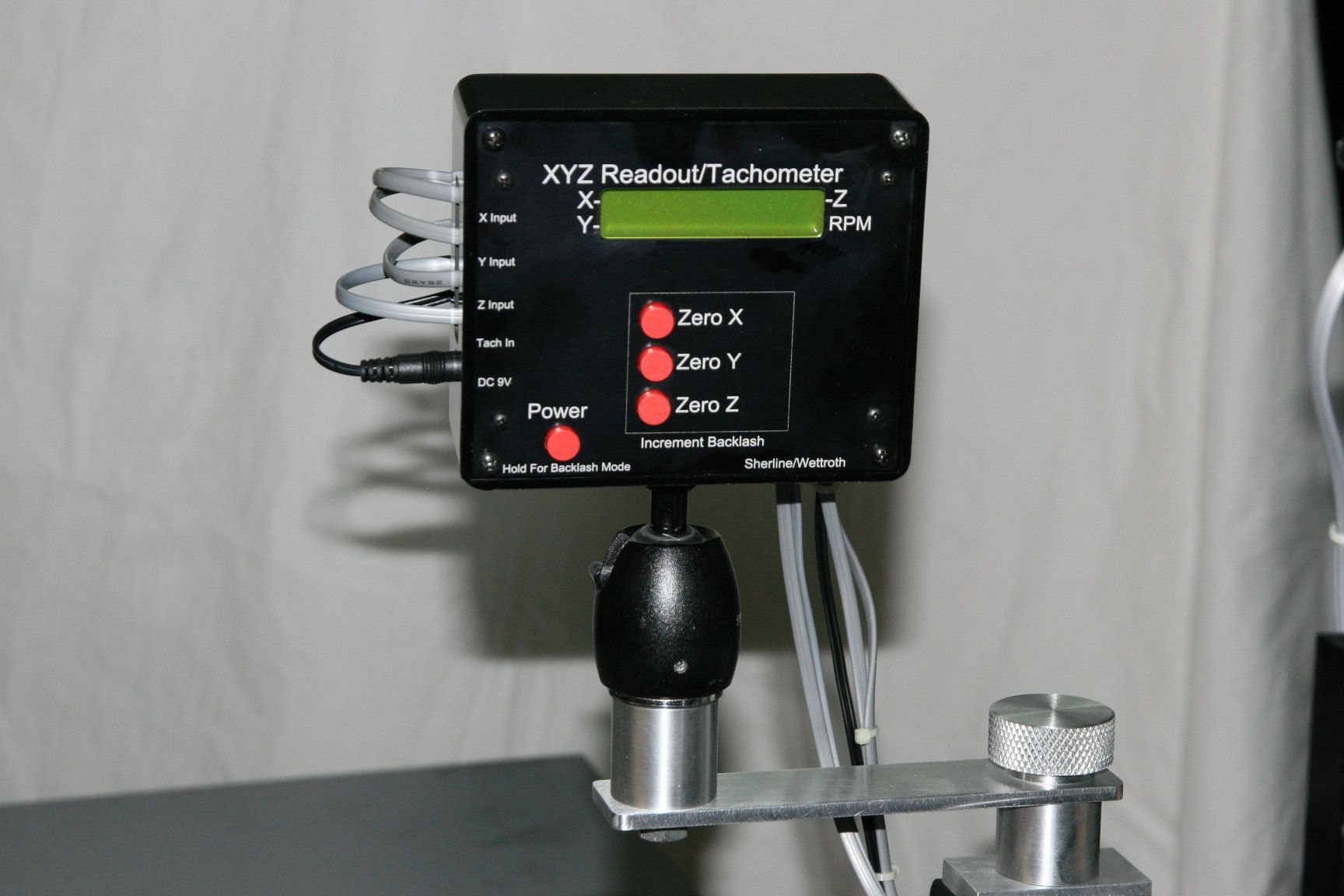

    That makes for a project. Need a way to mount the digital readout display so I can see it no matter where the spindle happens to be
    and however it may be articulated. Number two requirement was to keep the cables contained and safe.
    I think this project attains both goals.

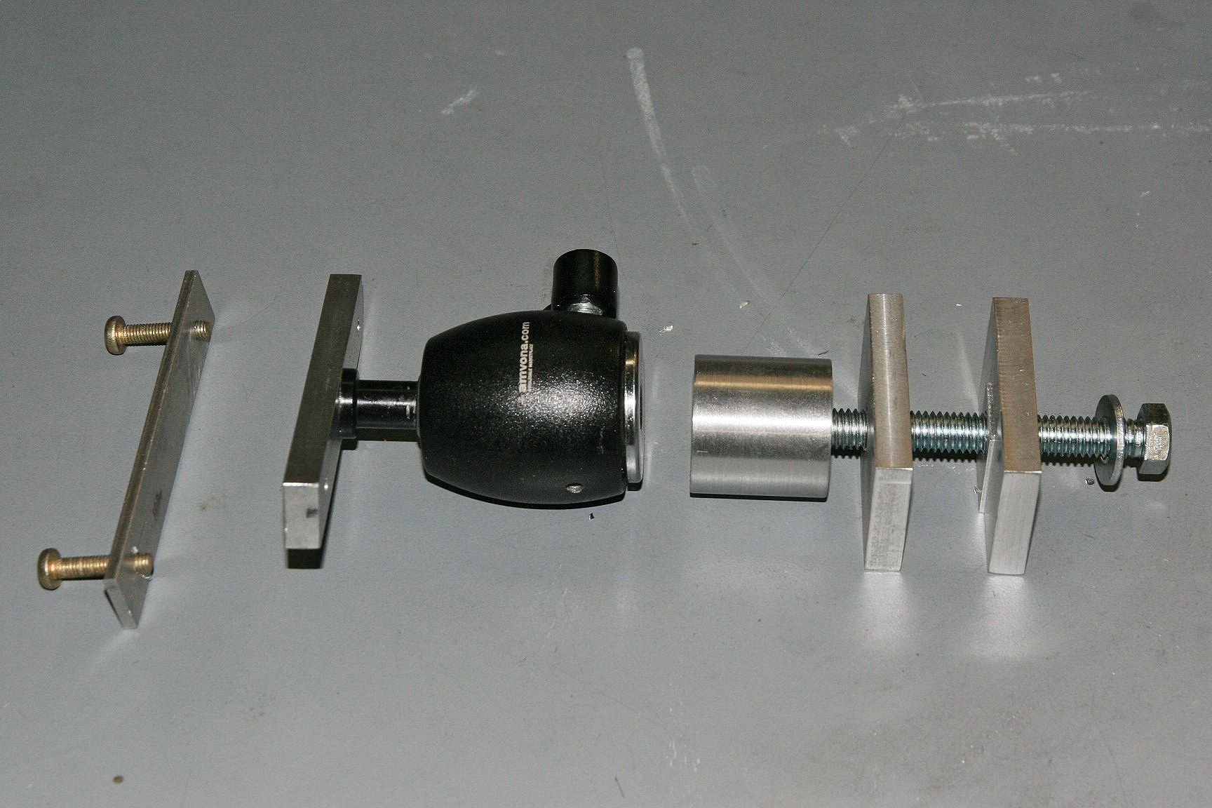

    I used a camera tripod ball head that I was not using. Just stored in one of the many drawers full of stuff.
    The ball heads have a "standard" 3/8-16" thread so a good ole hex bolt would work for the shaft.
    The Sherline 2000 has a wonderful arm supported by the column. I used this arm by adding a top plate and
    bottom plate that was milled down .050" to give the plates an alignment boss. Each had a 3/8 hole drilled through.
    Make a small spacer to raise it up a bit and the main mount is done.

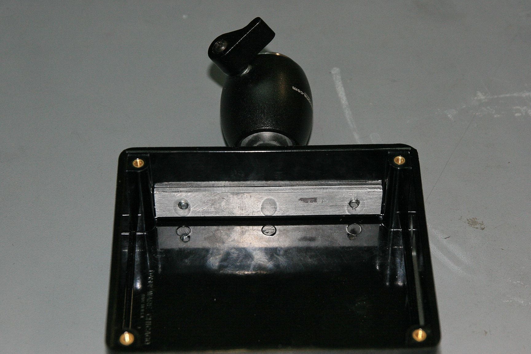

    Machined a piece of aluminum to fit the top of the ball head and then drilled two clearance holes for 10-32 screws to hold the display box.
    Made a small "nut plate" for inside the box making sure there would be enough space for it to clear all electronics.
    The result:
    Attached Thumbnails Attached Thumbnails Digital Readout Display Stand...Sherline 2000 mill-img_1575b-copy.jpg   Digital Readout Display Stand...Sherline 2000 mill-img_1576b-copy.jpg   Digital Readout Display Stand...Sherline 2000 mill-img_1577b-copy.jpg   Digital Readout Display Stand...Sherline 2000 mill-img_1578b-copy.jpg   Digital Readout Display Stand...Sherline 2000 mill-img_1582b-copy.jpg
    Digital Readout Display Stand...Sherline 2000 mill-img_1584b-copy.jpg   Digital Readout Display Stand...Sherline 2000 mill-img_1585b-copy.jpg   Digital Readout Display Stand...Sherline 2000 mill-img_1587b-copy.jpg   Digital Readout Display Stand...Sherline 2000 mill-img_1593b-copy.jpg   Digital Readout Display Stand...Sherline 2000 mill-img_1594b-copy.jpg

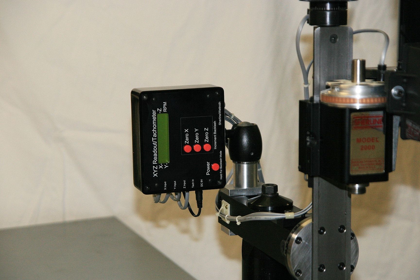

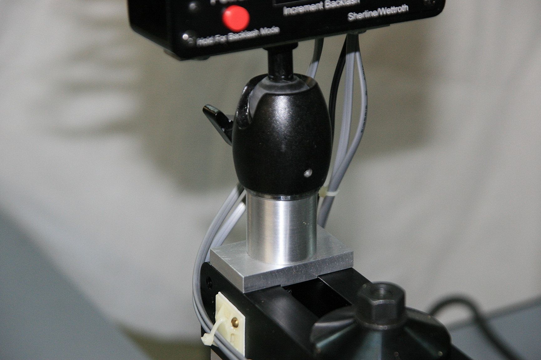

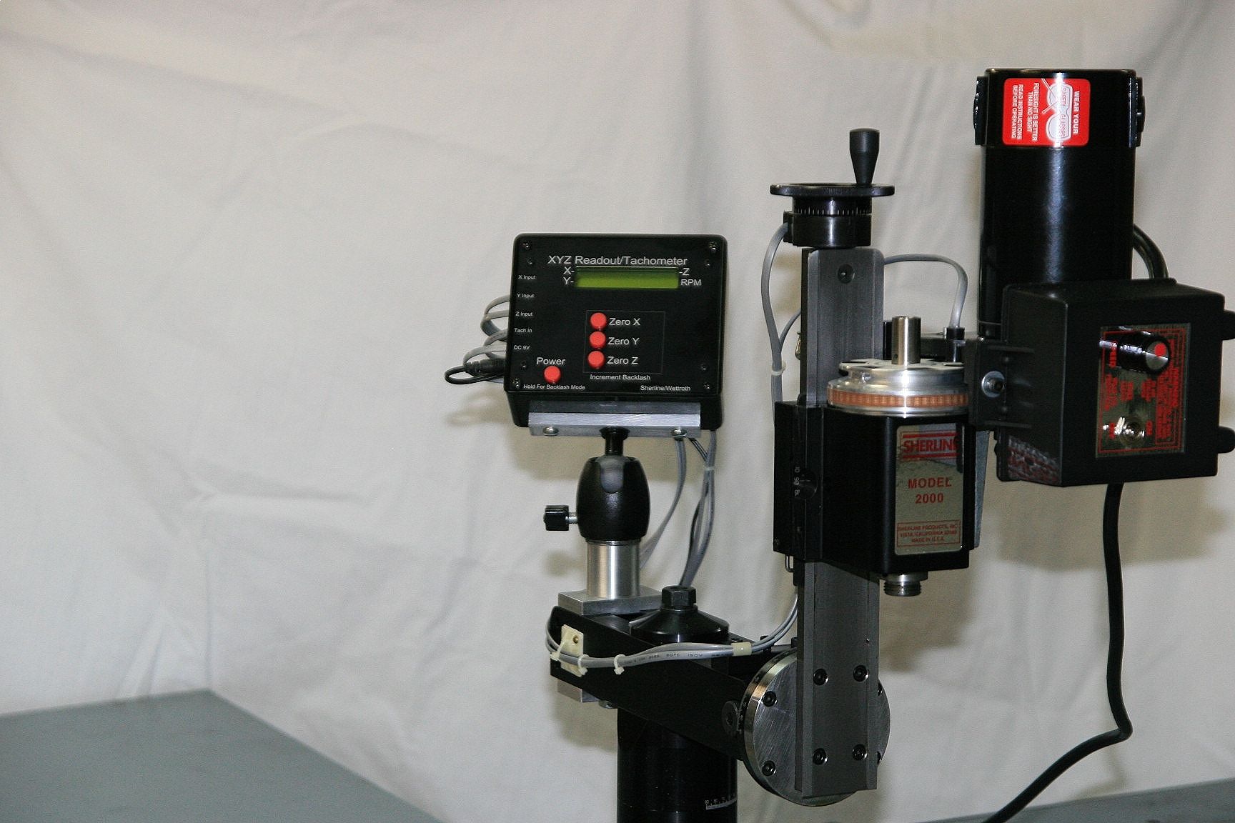

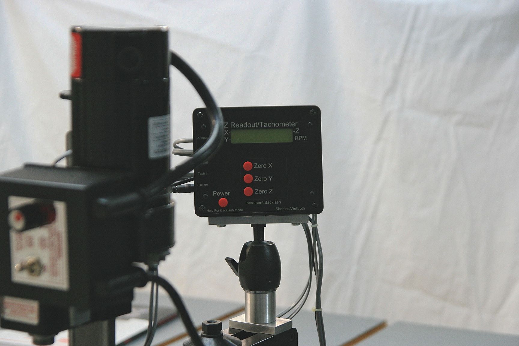

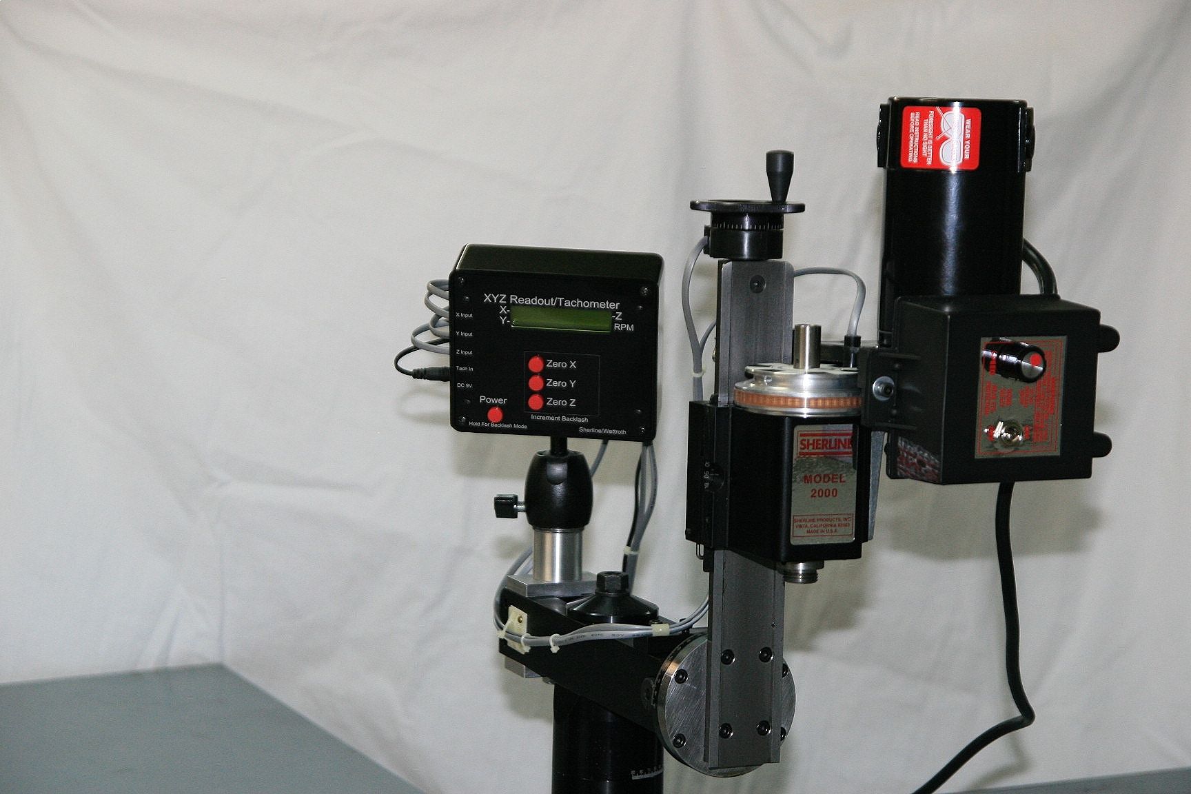

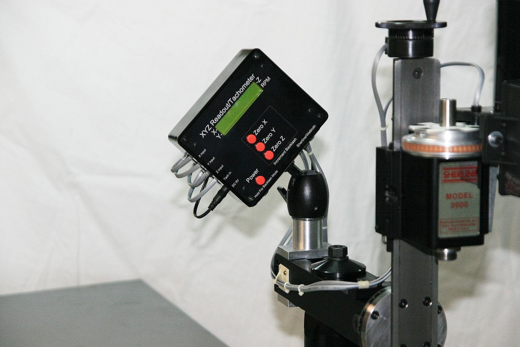

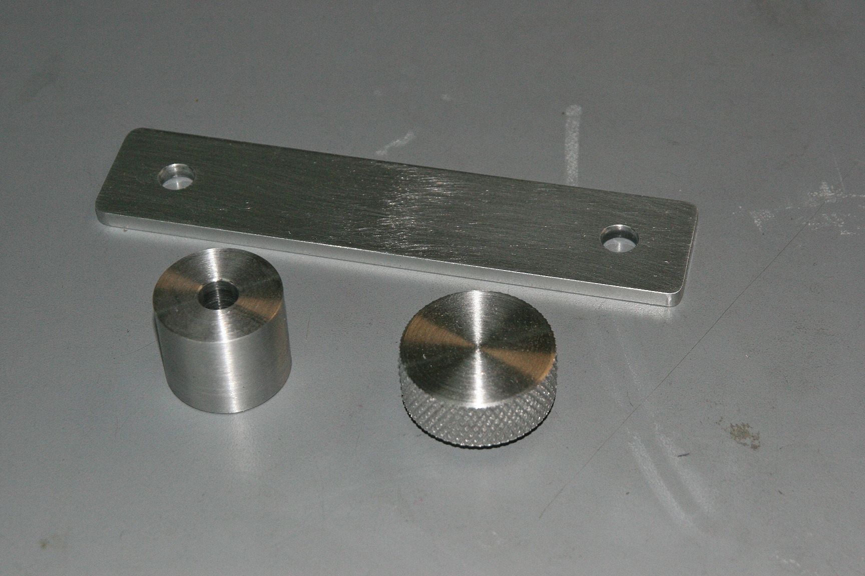

    After I finished that I could see that it would be an advantage to be able to have a few modes.
    Left side mounted.
    Right side mounted.
    Both must maintain articulation.
    I only had to make an extra spacer, support bar, and one knurled knob and one additional 3/8-16" bolt and washer.
    Spacers can be optional but right now they seem about right.
    Cheers, JR
    Attached Thumbnails Attached Thumbnails Digital Readout Display Stand...Sherline 2000 mill-img_1598b-copy.jpg   Digital Readout Display Stand...Sherline 2000 mill-img_1600b-copy.jpg   Digital Readout Display Stand...Sherline 2000 mill-img_1601b-copy.jpg
