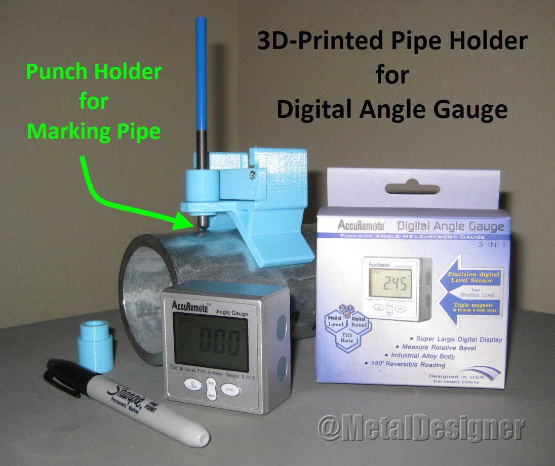

    Digital Angle Pipe Marker 3D-Printed Mount
    3D-Printed 'DIGITAL' Angle Marker for Pipe
    Website Link:
    https://ctmprojectsblog.wordpress.co...rker-for-pipe/
    Digital Angle Pipe Marker 3D-Printed Mount-magnetic-steel-insert-version.jpg

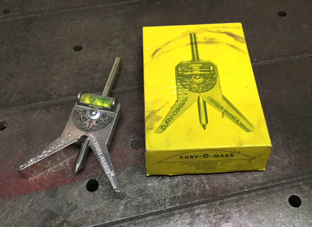

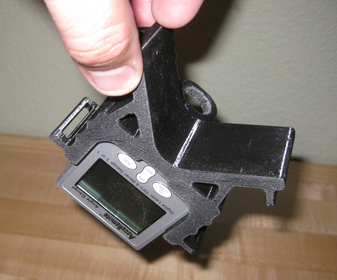

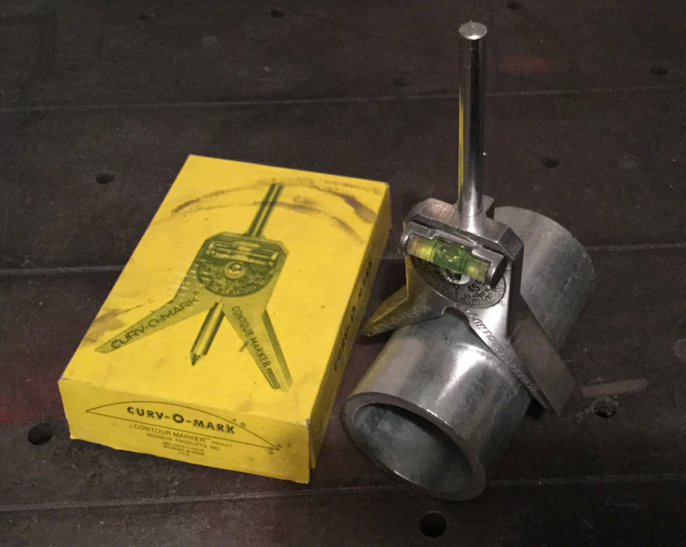

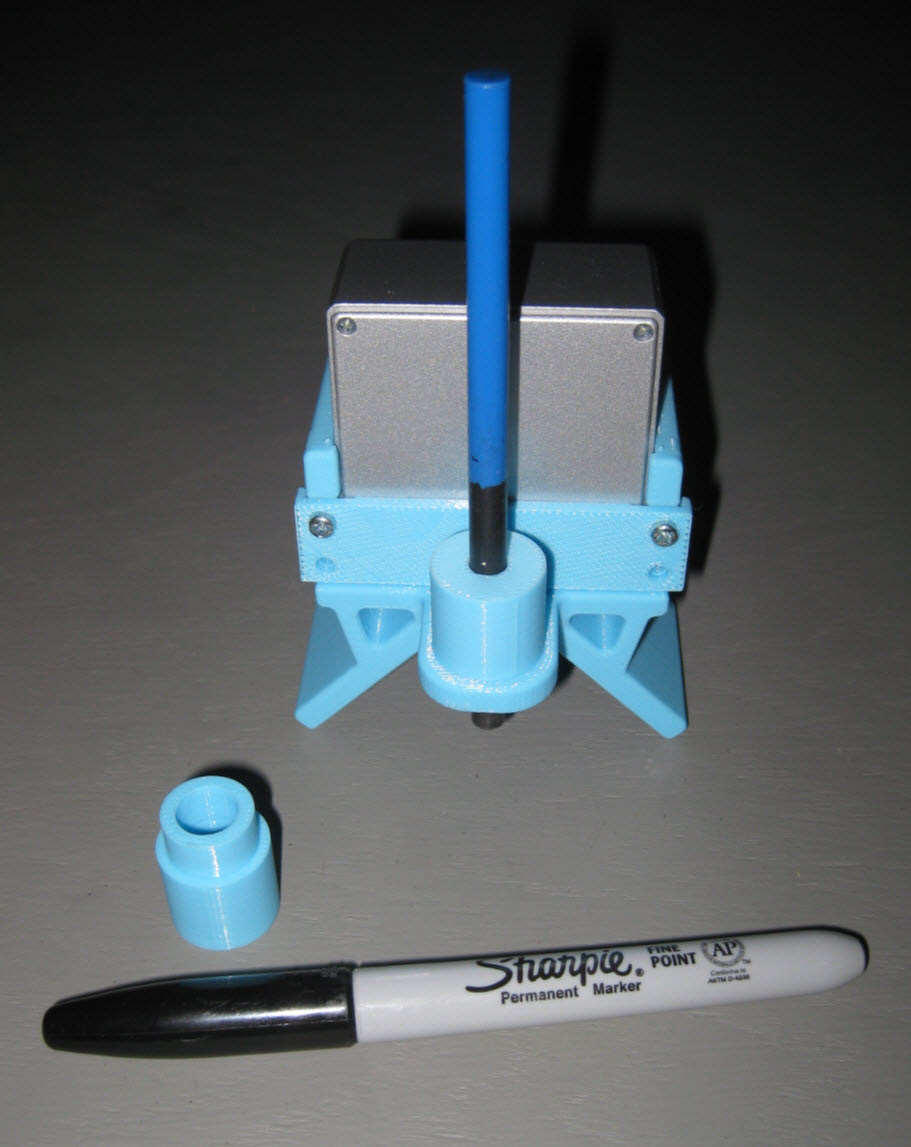

    For over 25 years I have used the CURV-O-MARK ‘Bubble’ Type Angle Pipe Markers … They work great; however, I wanted to be able to use a more accurate 'Digital' Angle Pipe Marker.

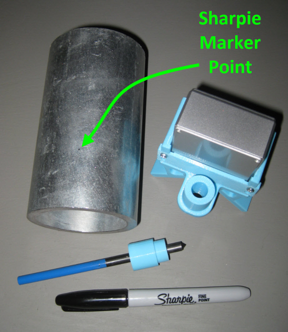

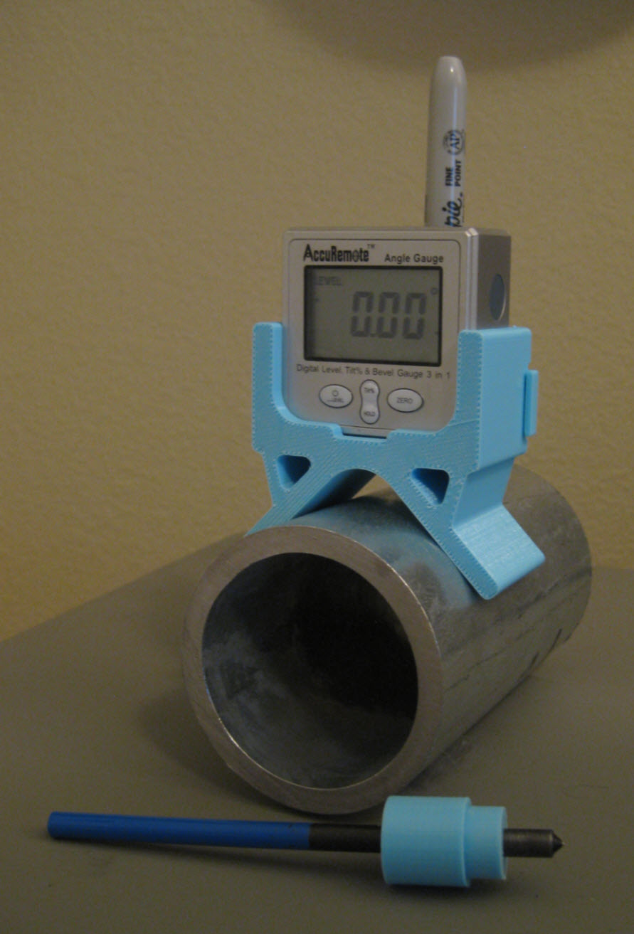

    Sometimes I don't want to punch indentation marks in the pipe; instead, wish to create a group of accurate dots on the pipe with a Sharpie Marker to check my initial set-up ...

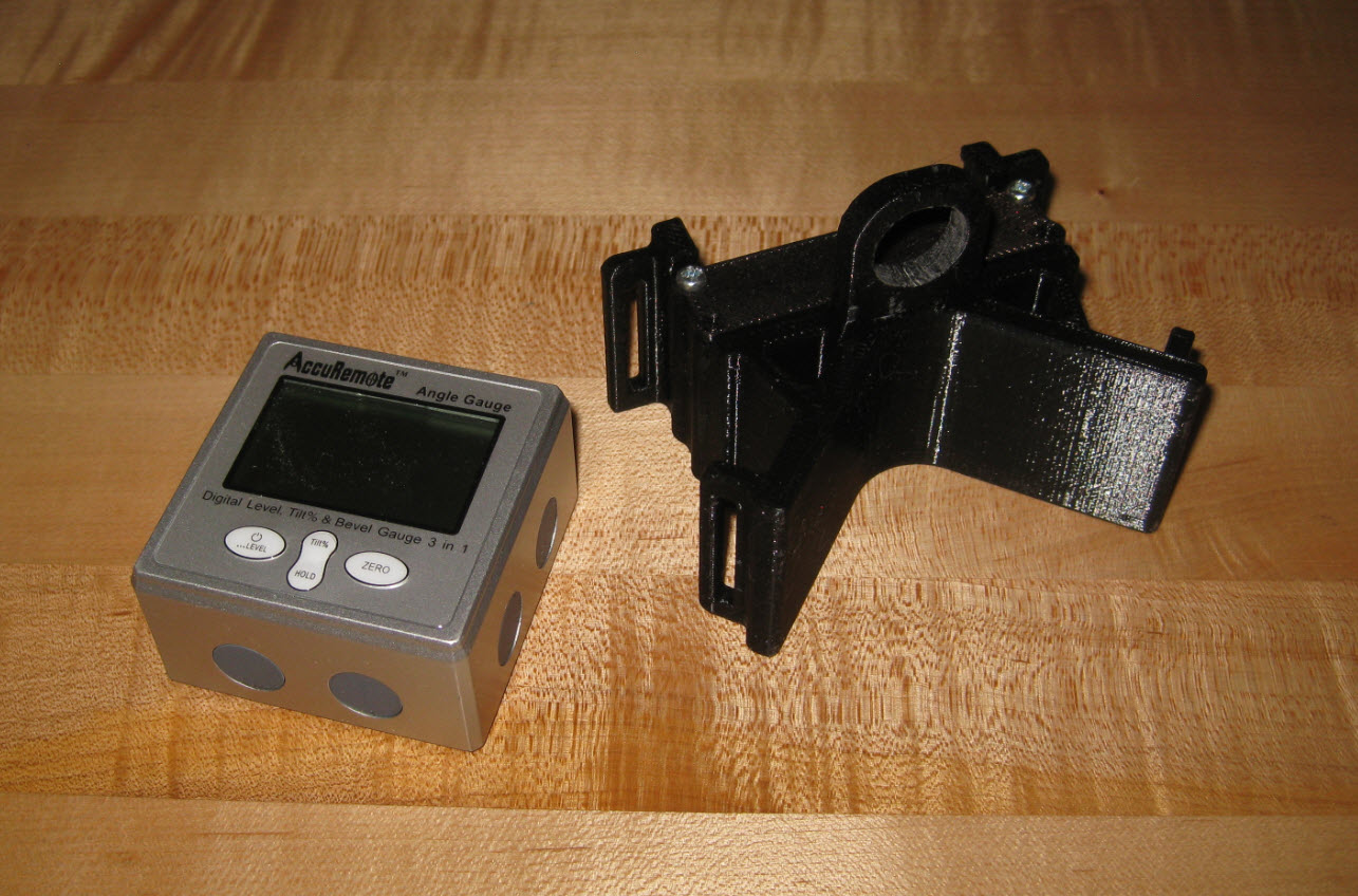

    About a year ago I purchased an AccuRemote Digital Electronic Magnetic Angle Gage Level / Protractor / Bevel Gauge

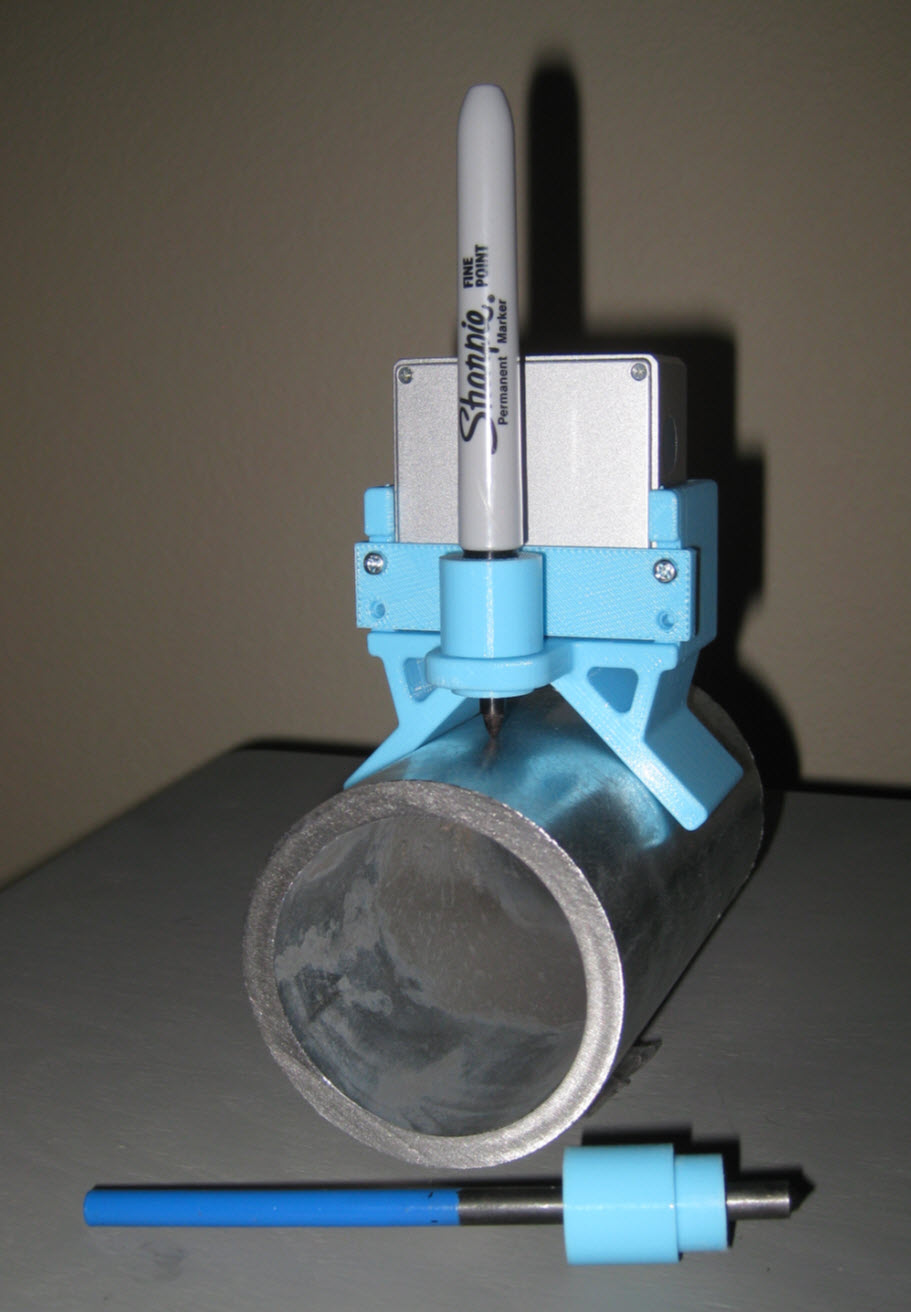

    Found it to be very accurate and decided to find a way to use it on pipe with a Sharpie & punch …
    Had a project whereby I needed to mark out several areas on a pre-insulated pipe with a Sharpie Marker because didn't want to mess up the insulation with a punch during the set-up process.
    Designed a metal version out of Flat-bar Steel & Angle Iron but wasn't at home able to get out and weld it together, so designed a 3D-Printed version on my Laptop at the airport using SolidWorks CAD Software.
    When I got home late at night, I pressed a button on the 3D-Printer before going to sleep and had the mount in the morning when woke up ~ Bonus 'Sleep-Working'

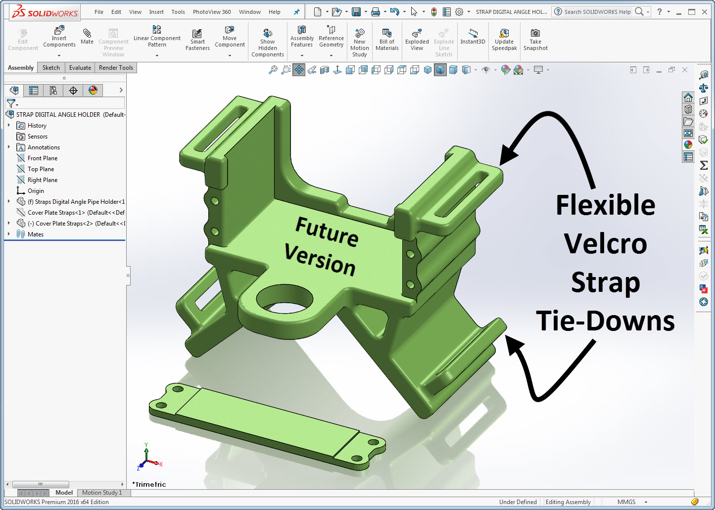

    I'm still going to use my CURV-O-MARK ... but this 'Digital' version is an option when need better accuracy for unusual angles.

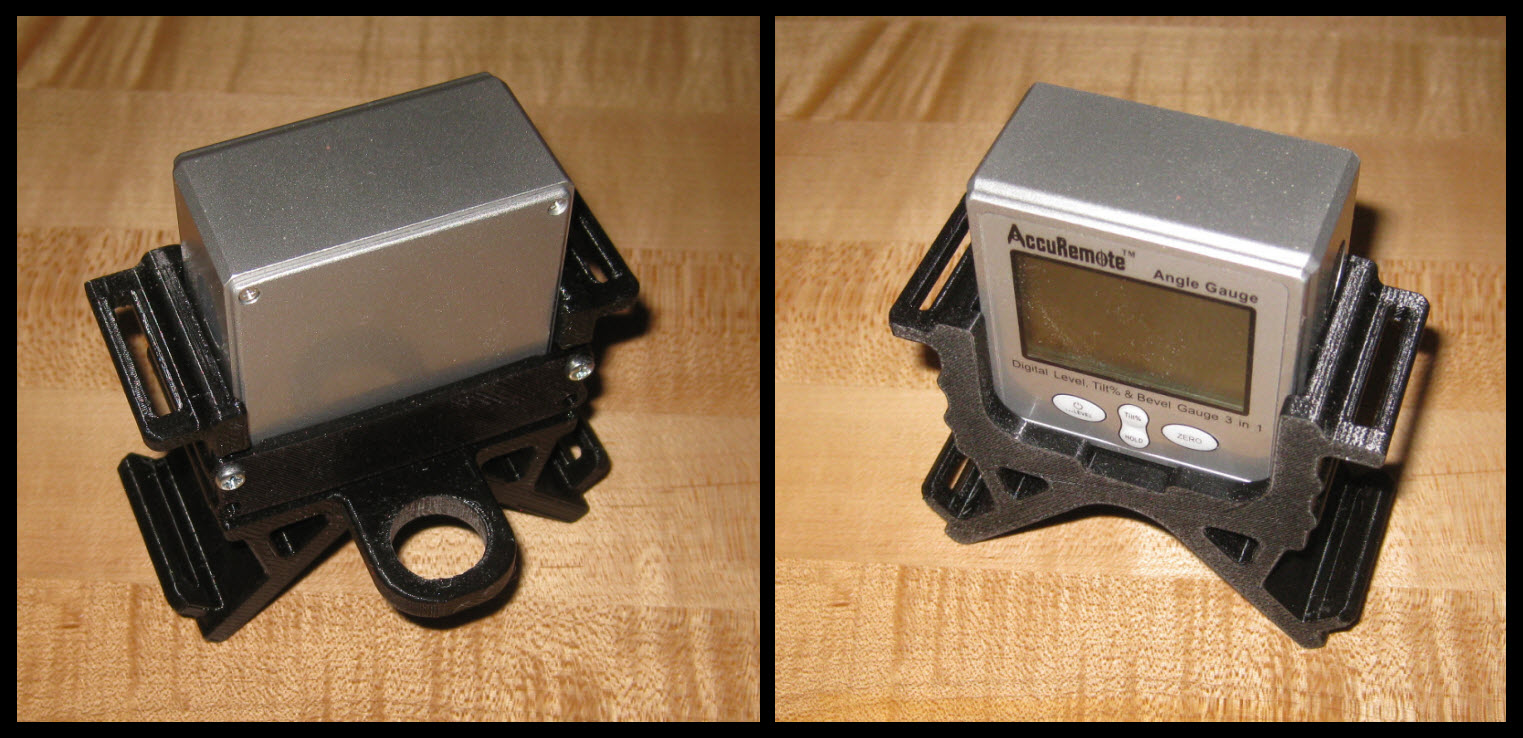

    Updated Version with Flexible Velcro Strap Tie-Downs ... Although not sure I need the top straps because it is a nice tight fit-up.
    Digital Angle Pipe Marker 3D-Printed Mount-updated-version-velcro-strap-tie-downs.jpg

    Thanks to a note from C-Bag View Profile: C-Bag - Homemade Tools Forum
    ... I am going to see if I can machine a very accurate mounting area directly on the Curv-O-Matic's body to mount a piece of steel for the Digital Angle Gauge to magnetically attach directly to the Curv-O-Matic for when I need to double-check accurate angles prior to using the punch.
    CHEERS!!

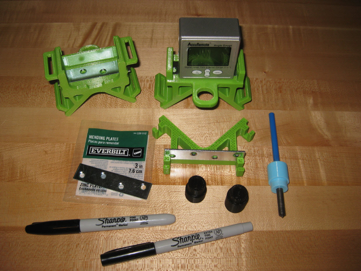

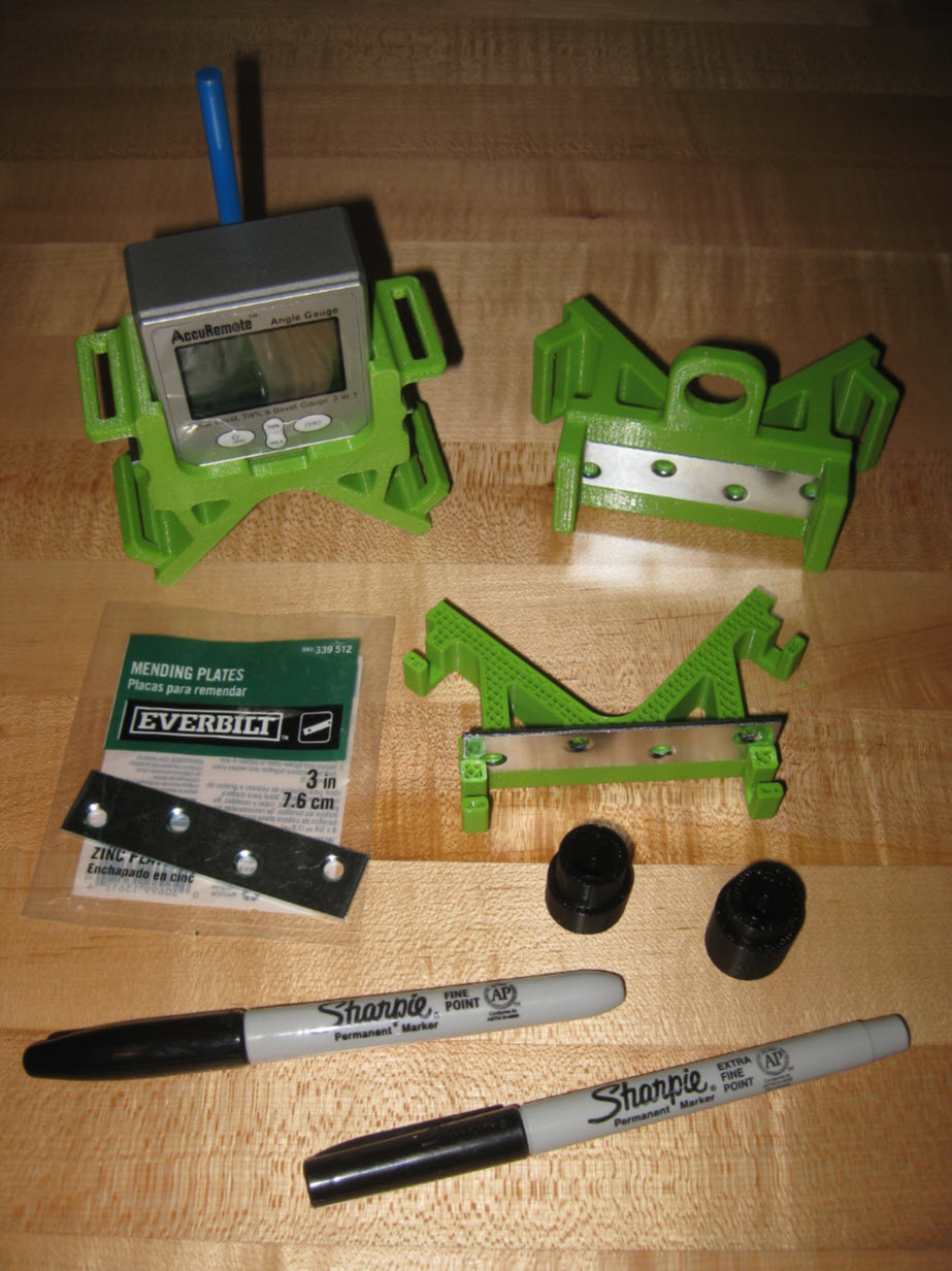

    I waited to respond to this because I had made a 'Magnetic' Wixey Version as a gift and wanted to make sure the person got to see it first before putting it on here.
    It works, but I still prefer the AccuRemote 3D-Printed mount with the sides on it because I know the exact dimensions; therefore was able to create a tight fit.
    ... But did add a slide in piece of metal in the final version so it is also held by magnets.

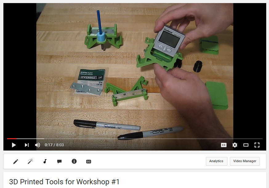

    Added a YouTube Video to the Original Post that shows all the finished items (3D-Printed in Green)
    It is nothing fancy, designed it beefy to last, and just made the Mount for my workshop AccuRemote
    ... and maybe a few for gifts to give to other individuals.
    Once I have the exact dimensions from someone for the Wixey Digital Angle Gauge I will make a better mount for the Wixey and send them one.

    Here is an Additional Video Showing the final 1 minute of 3D-Printing
    You can see all the support material that just pulls off when done.
