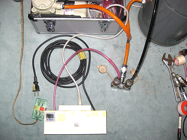

    Showing below is a set up for a Laser displacement detector at the back, but not seen here though.
    Digital Air Pressure Controller (e.g. like the one for airbrush paint)-img_0040.jpg
    White rectangle box at the center bottom is the controller. A grey cylinder in the right upper is an air buffer tank.

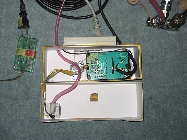

    Case was made of card board, black cord leads power to an AC-DC converter that makes 24 DC volts. This converter was from a tad troublesome set up of Fluke handy oscilloscope, which needed some repair.
    Digital Air Pressure Controller (e.g. like the one for airbrush paint)-img_0041.jpg
    A white small box sitting in the lower box(which is a lid) in the left is a positive pressure sensor, this works in 24 DC volts and is connected to a relay.

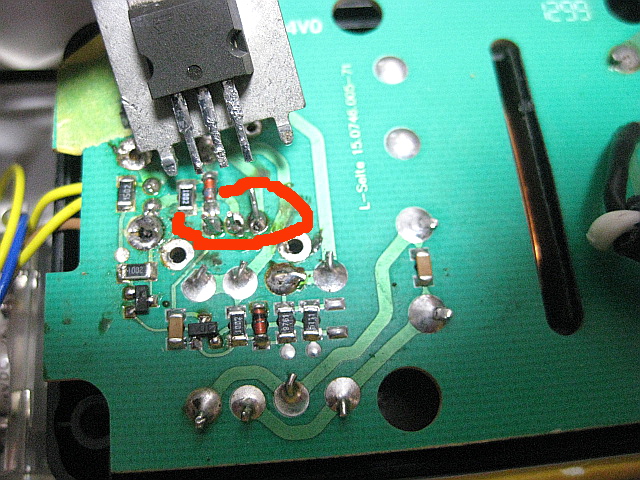

    The trouble about this AC-DC converter was that its MOS-FET transistor, it was gone.
    Digital Air Pressure Controller (e.g. like the one for airbrush paint)-img_0042.jpg
    Replaced it with a new one.

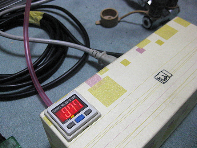

    The setting on the sensor is so called Normally Close, with which the pump starts when you plug the line in.
    Now the pump is moving and this indicator shows pressure in red.

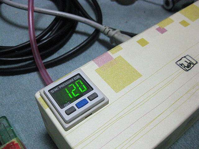

    It stops when the pressure goes to any set value, e.g. 0.120 M pascals in this case, and the indicator turns to green.
    Digital Air Pressure Controller (e.g. like the one for airbrush paint)-img_0044.jpg
    This unit can be used for other small home-use air compressors. If you need higher pressure you only need to give a couple of alterlations to the setting. The maximum serviceable pressure is 1.5 M pascals.

    Correction to my post:
    I wrote; the previous MOSFET has been broken, but the truth was the Gate voltage seems to be coming down to nearly 2.0 volts. Yet do not know this reason.
    The original MOSFET was a BUZ71 made by Fairchild with a 'Gate to Threshold Voltage' is 2.1V(min) to 4.0V(max).
    I replaced this with a 2sk2232 which has smaller 'Gate threshold voltage' from 0.8V to 2.0V.
    This does good job.
