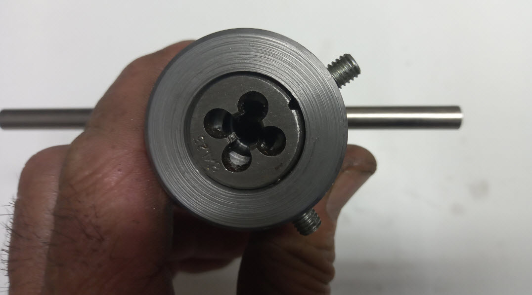

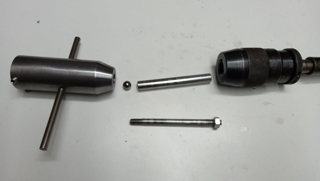

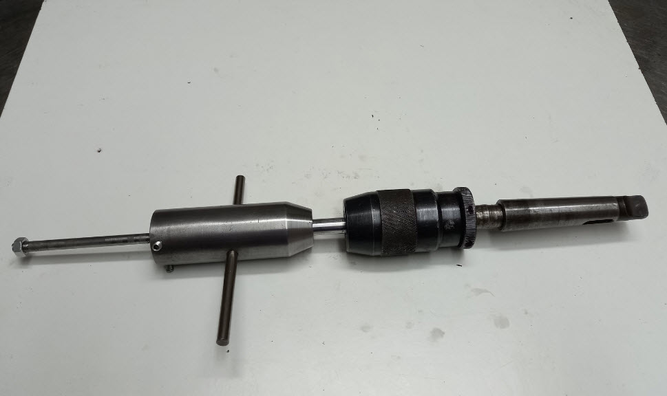

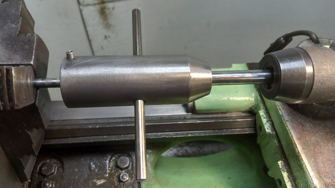

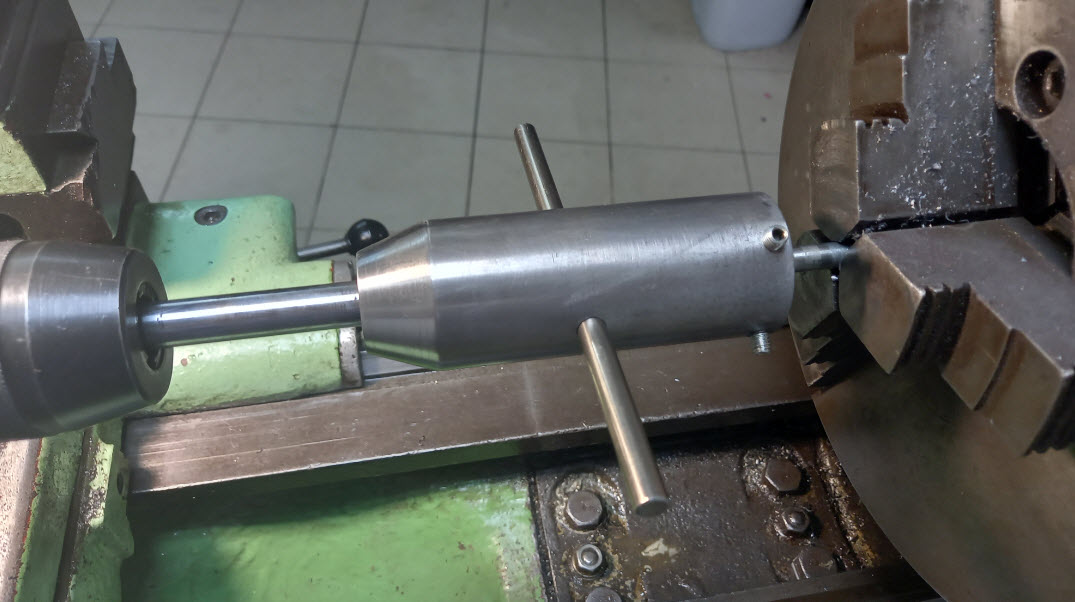

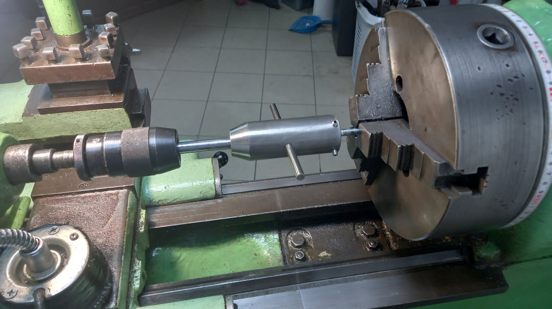

    In this video you can watch how I made a simple tool to cut a straight external thread on my lathe.
    Attached Thumbnails Attached Thumbnails DIE HOLDER  ON THE LATHE-f1.jpg   DIE HOLDER  ON THE LATHE-f2.jpg   DIE HOLDER  ON THE LATHE-f3.jpg   DIE HOLDER  ON THE LATHE-f4.jpg   DIE HOLDER  ON THE LATHE-f5.jpg
