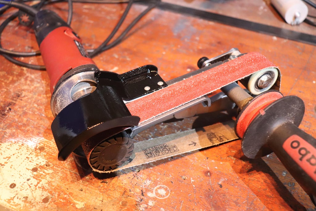

    Made a belt guard too.
    Its fastened to the belt sander body with two m3 screws.

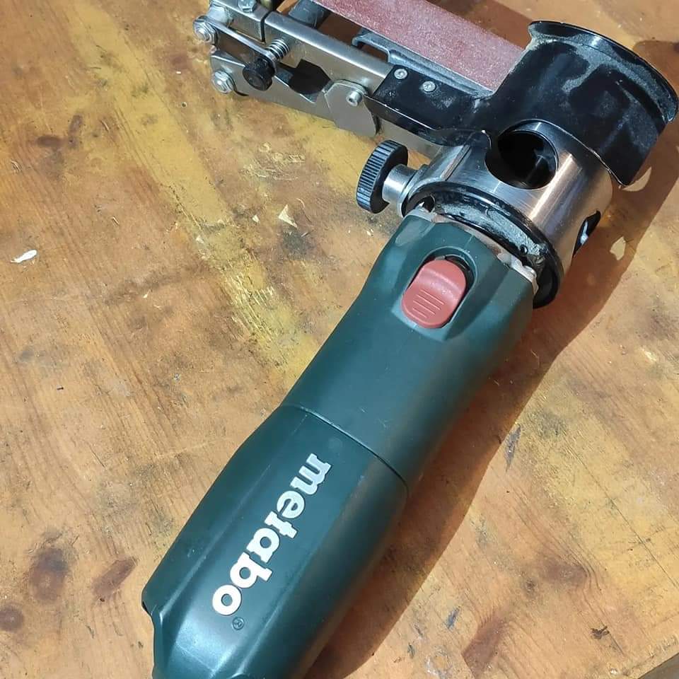

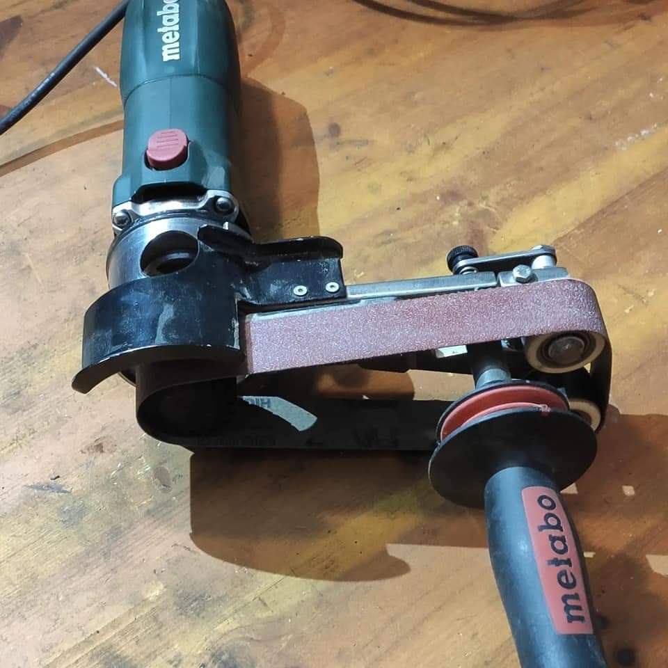

    Modified it to fit 710w Metabo. More power makes it more useful.

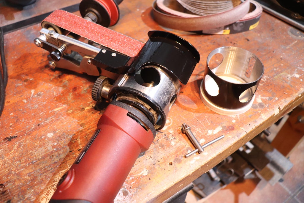

    Yes. Its very easy & fast to assemble. That Metabo has groove in the neck. Locking screw is located to that groove.
    It takes less than ten seconds to attach or deattach attachment.
