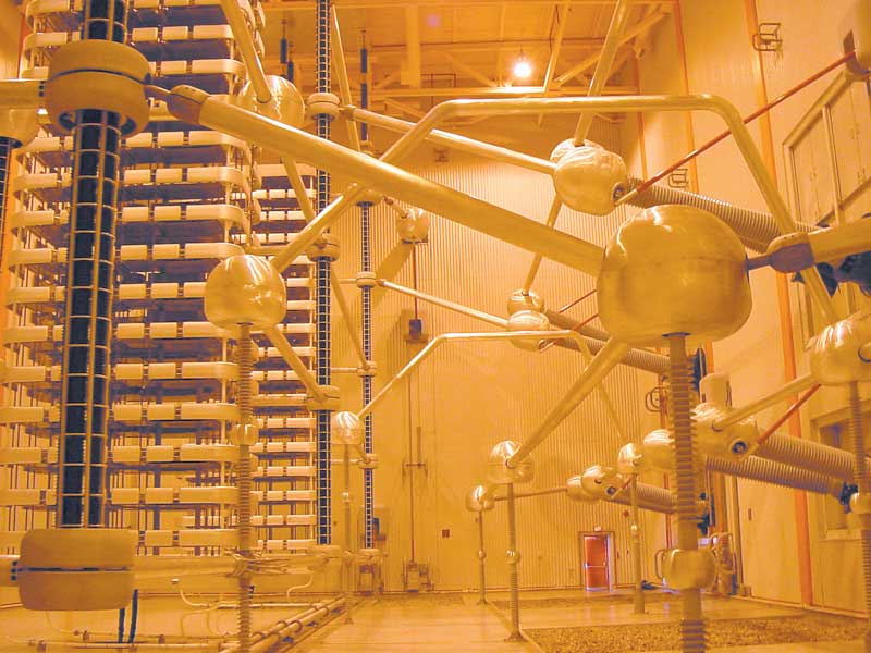

    So much to unpack - here goes.
    This facility looks like a High Voltage facility. The building is a big space, there are lots of insulating paths and lots of insulators. I did an image search and this indeed is what I thought, though it is more. The image below is from
    Detecting leaking current with a torch - GIF-converter-transforms-alternating-current-into-direct-current-radisson-substation.jpg
    "Converter that transforms alternating current into direct current at Radisson substation"
    which you can read about on:
    Extra-High-Voltage Transmission | 735 kV | Hydro-Qu?bec
    Quebec Hydro has 735kV power transmission lines. On that page they state that one of those lines is equal to four 315kV lines, which they call out as reducing the number of towers required. Why is that? Ohm's law. The power lost on the transmission line is I*I*R (square of the current) Power transmitted is V*I, so if you double the voltage and keep the current the same, you have the same lost power.

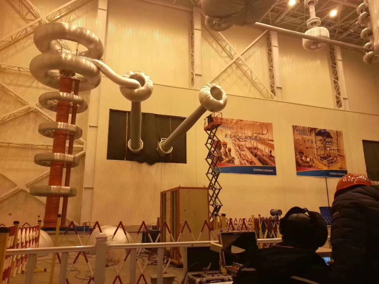

    Another image that was found was from
    https://www.electric-test.com/news/1...-60688515.html
    which talks about a 1100kV Converter Transformer Valve ...
    Detecting leaking current with a torch - GIF-20220901162256a45ab459501e459bb98fdfa96cd7a6c8.jpg
    That is a testing facility and looks very similar to the video, could be the same place (look at the walls, both the exterior on left and interior on right).
    These folks test high voltage stuff.
