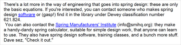

    Are any of you able to connect to the various links embedded in the document, particularly earthlink? Mine all seem to come up dead
    I can manipulate those equations into Excel but was hoping for some simple online calculators. Again, that link seems to go nowhere. Some of the spring manufacturers calculations I've found on my own are not bad, but after inputting the usual parameters (OD, wire size, coils, length...) they seem more orientated to direct you to their (sales) offerings, more like a database lookup system.

    In a situation like that, search for an old archived version of the page. At Archive.org, enter in the url in the top "Wayback Machine" search box, to see all of the times it's been archived. Then check the archived versions, maybe one per year, until you find one from before that url disappeared. The calendar will show an orange circle if the archive attempt ended in a 404 error ("resource not found"). So keep going back until you find a blue circle date. The most recent one of those is generally your best bet.
    So, in this case, it will lead you to something like this: https://web.archive.org/web/20121017...resources.html
    For earlier disappeared stuff, try the Google Cache.
    And if you want to create a web archive of a page that you think might go offline, just enter the url at Archive.is. Obviously, you can always just save a webpage to your computer, but Archive.is provides a third-party easily-accessed copy.
