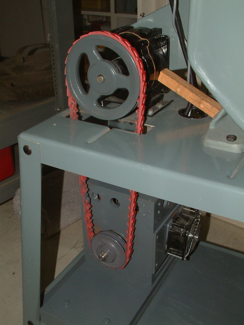

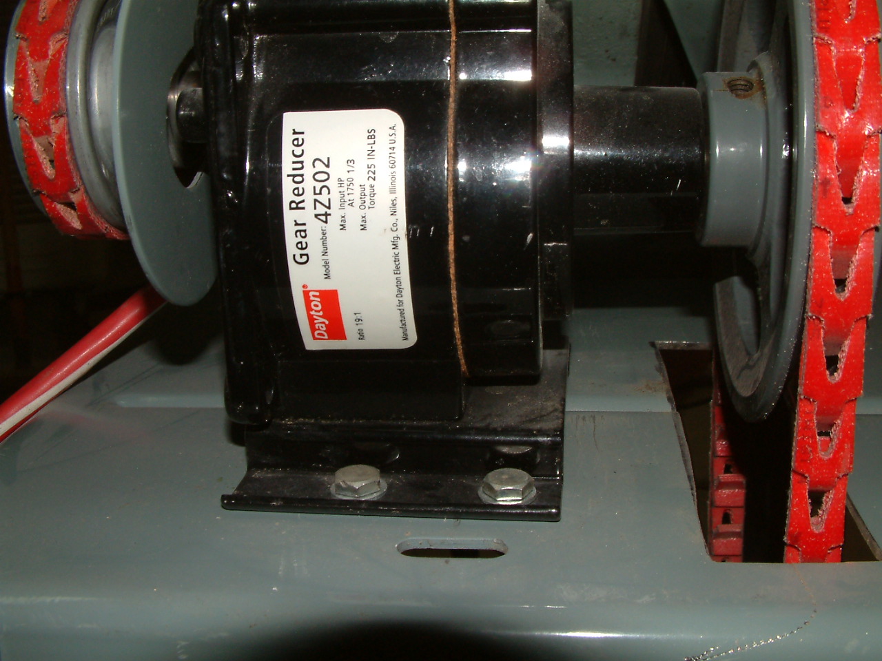

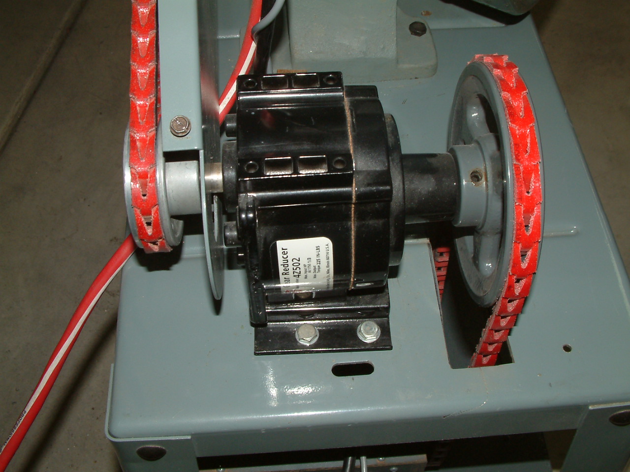

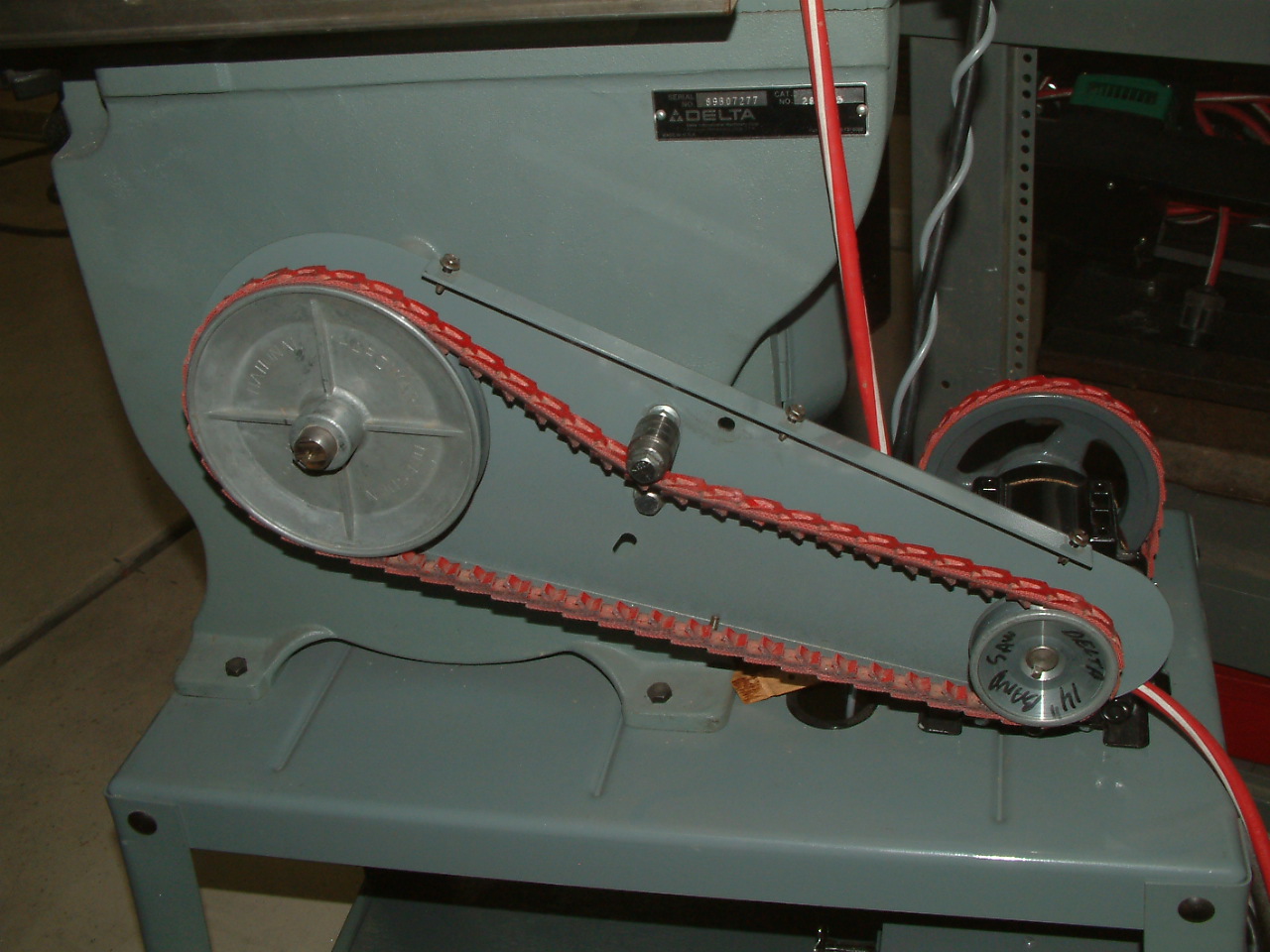

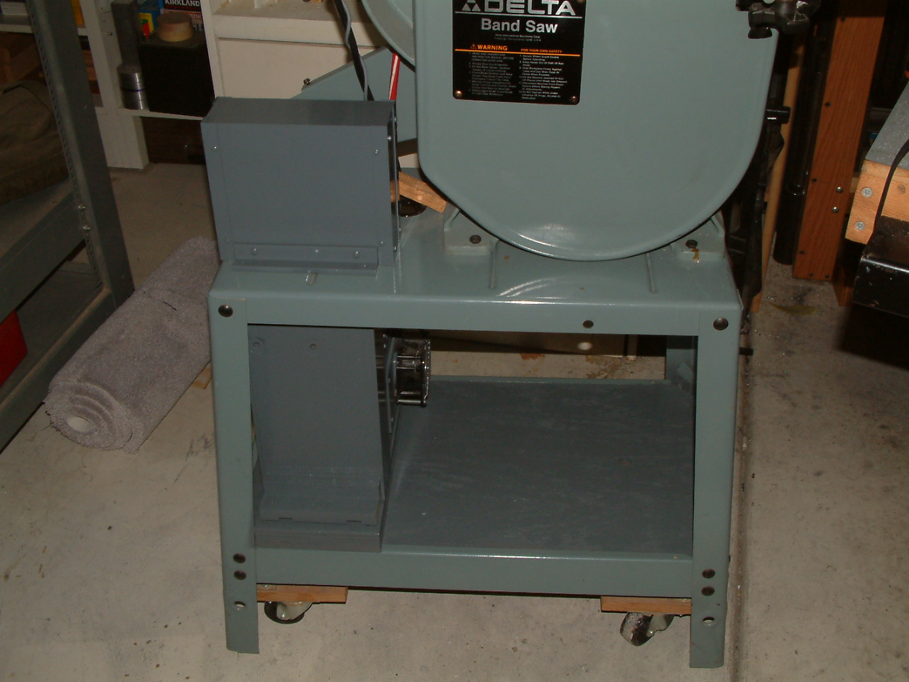

    I needed a way to cut steel, aluminum, brass, and wood with my band saw which is an older tool I have had for 30 years. The Delta is a good saw but to fast for steel. I added a 19:1 gear reducer and a 2:1 pulley setup to match up with my 6000 rpm variable speed tread mill motor. So now I have a saw that cuts just about anything you can get a blade for at just about any speed you require.
    My first attempt was to use the tread mill motor with just the smallest pulley I could fit on it and use the existing drive pulley on the lower band saw wheel. The rpm reduction was not enough. I actually "threw" a tire due to over speed. The other thing was the lack of torque using the tread mill motor.
    This new setup with the 19:1 ratio gear box solved both problems.

    Thanks Paul,
    I purchased the gear reducer on eBay a few years back. The prices on these really have a wide range. This one was new and I think it was only $50 but I have seen used ones for much more. The Power twist V-belts are my favorite. I have them on my table saw as well and should put them on my drill press. I think I see another small project in the wings!

    The controls for this one are very simple. The motor and speed controller were a match set sold surplus. I think it is rated at 2.5 hp and runs up to 6000 rpm. No digital controls at all. This must have been from an early and simple tread mill. I think the motor shaft is 5/8" in diameter. The motor required a custom "motor mount" that I made for the motor and electronic control board. I added a fan to that for cooling the motor and circuit board.
    There are only two controls. A pot for speed control and a switch for on/off. The pot must be brought to zero with the switch in the off position before the motor will start. Once the switch is placed to on, then you simply advance the speed control pot and she ramps up to full speed in about 15 seconds. You can adjust the pot to any speed you need. The motor does not have a lot of torque but with my gear reduction it powers through steel without bogging down.
