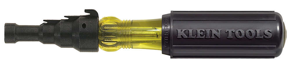

    I use one of these:
    https://www.kleintools.com/catalog/c...ng-screwdriver

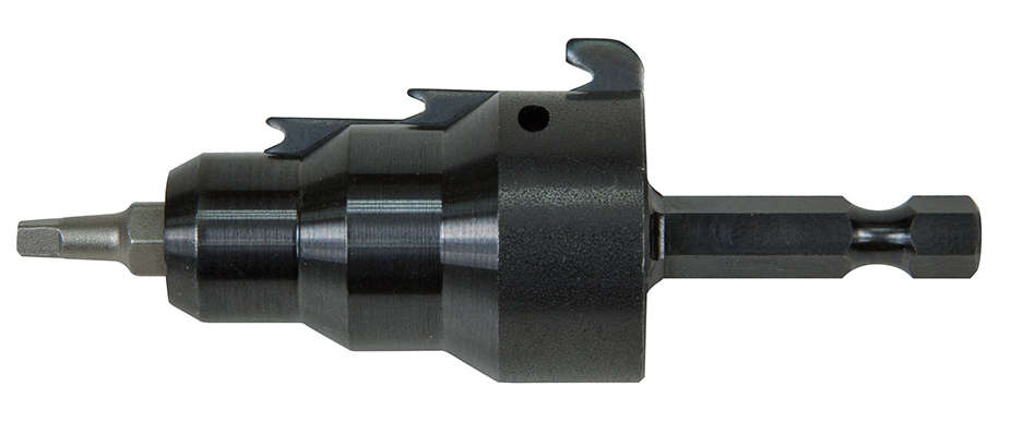

    There is also this:
    https://www.kleintools.com/catalog/p...conduit-reamer
    which I think I will have to pick for when I have to a bunch of ends.
    What I like about these is that it gets the inside and outside at the same time, I can do multiple sizes of EMT, and I don't have to think about drill sizes.
