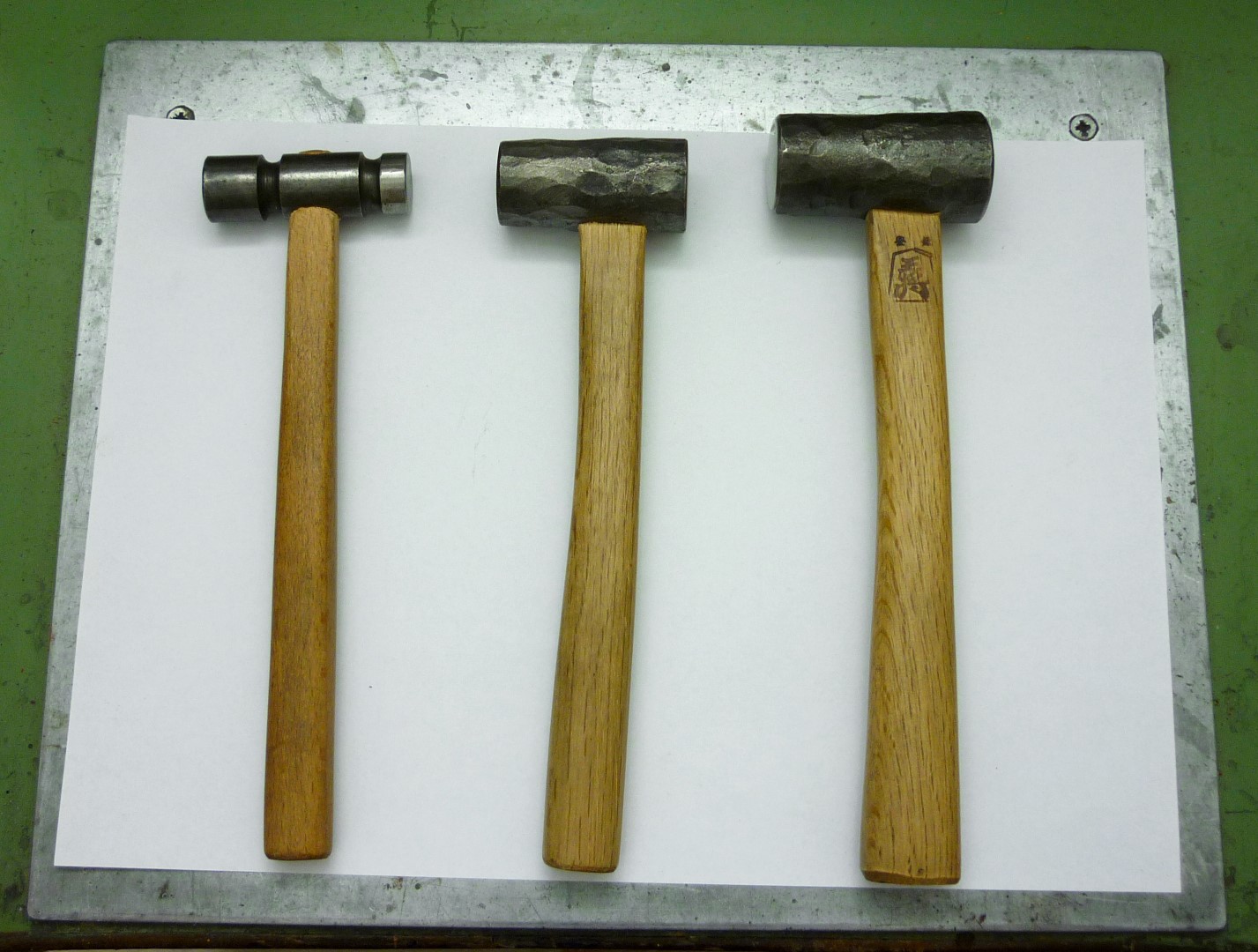

    For many years now I've been using these hammers for repoussé and chasing work.
    The two on the right are relatively heavy (6.5 and 10oz.) with short and stiff handles; the smaller hammer on the left is 3oz. but has an equally short-stiff handle with the other two. Although these hammers are not made for this kind of work, they have served me well till now.

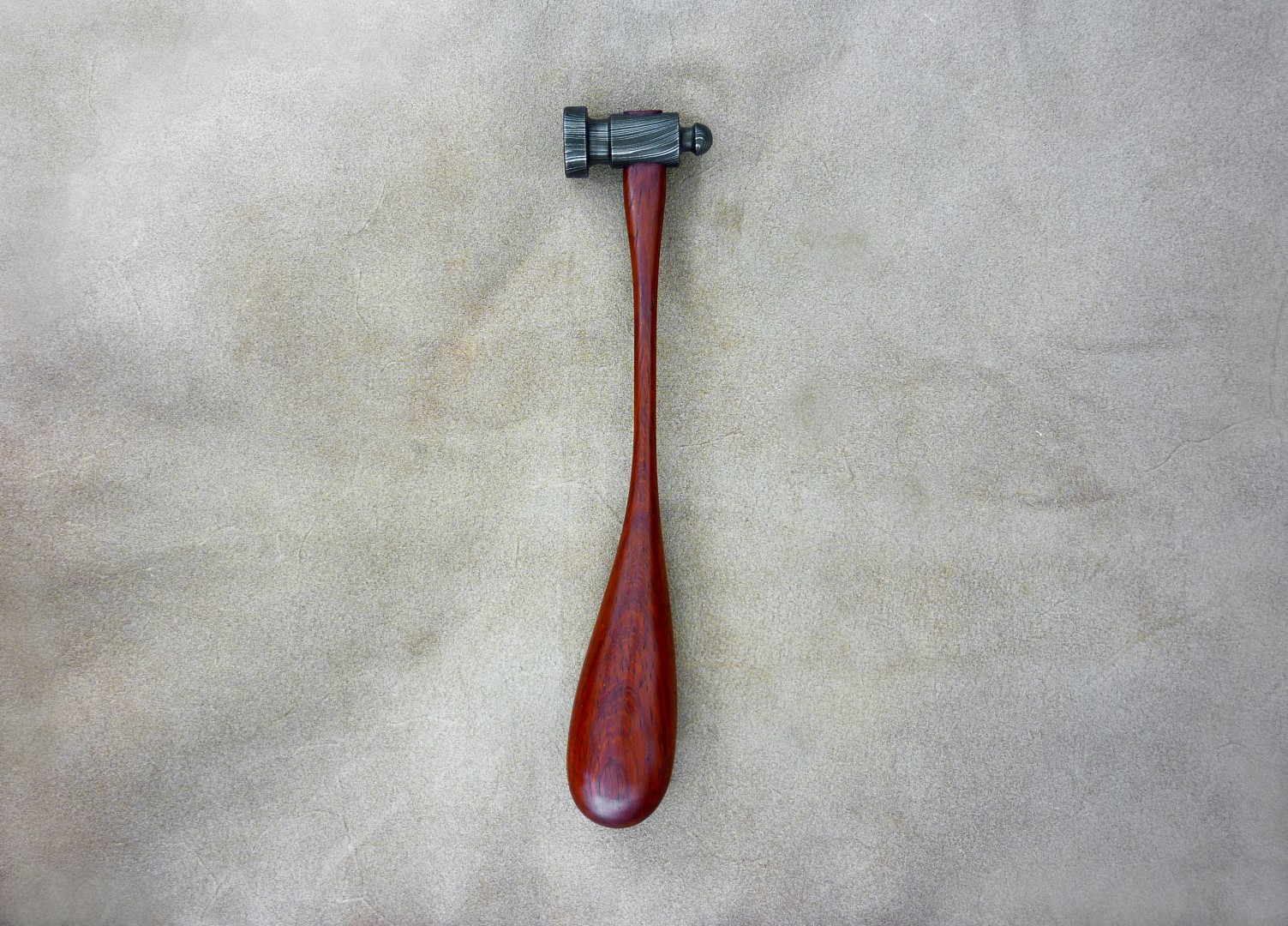

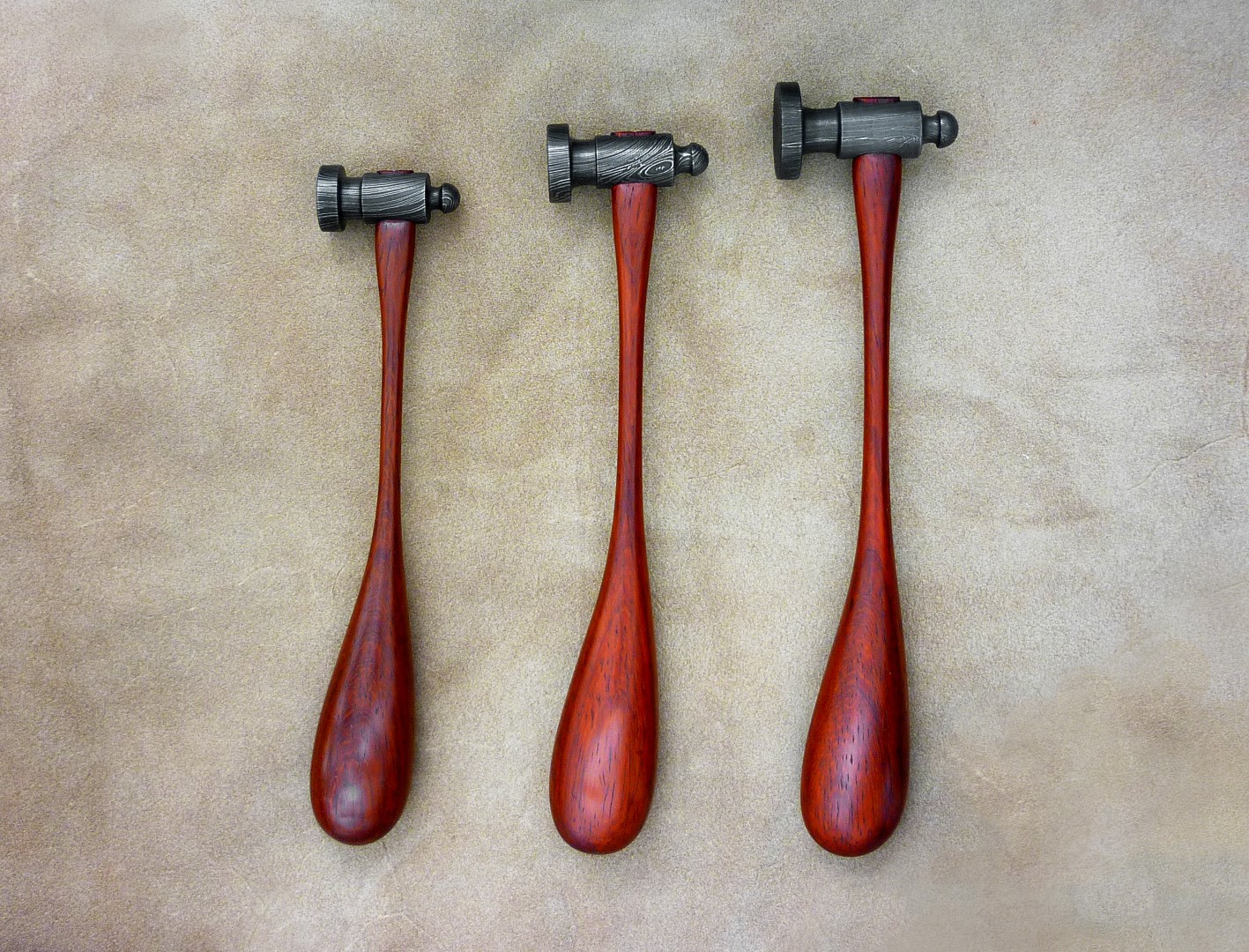

    Making a chasing hammer was something I really wanted for quite some time now. I remember when I joined this forum Jon welcome me and asked what would be my next project and I said a chasing hammer.
    I wanted to make something special, but not just one hammer; I wanted a set of 3 hammers, 2, 3 and 4ounces.
    Damascus chasing hammer-p1140277-large-.jpg Damascus chasing hammer-p1140306-large-.jpg
    Anyway, I hope you enjoy the video.
    All the best
    Dimitris

    A display case would be nice, not only for these but for some other tools as well; at the moment I’m trying to make a roll fabric case for storing these hammers, because the space on the wall infront of my bench is very small.
    The handle must be thin and flexible; it may seem odd but the handle is the most important thing in a chasing hammer. Chasing hammers work differently than other hammers, instead of relying on slow powerful blows, chasing depends on fast light blows. With every blow the handle flexes forming a spring that stores energy, this energy accelerates the hammer head torwards the chasing punch. Here is a very nice article which explains the subject in more detail: Picking a Chasing Hammer
