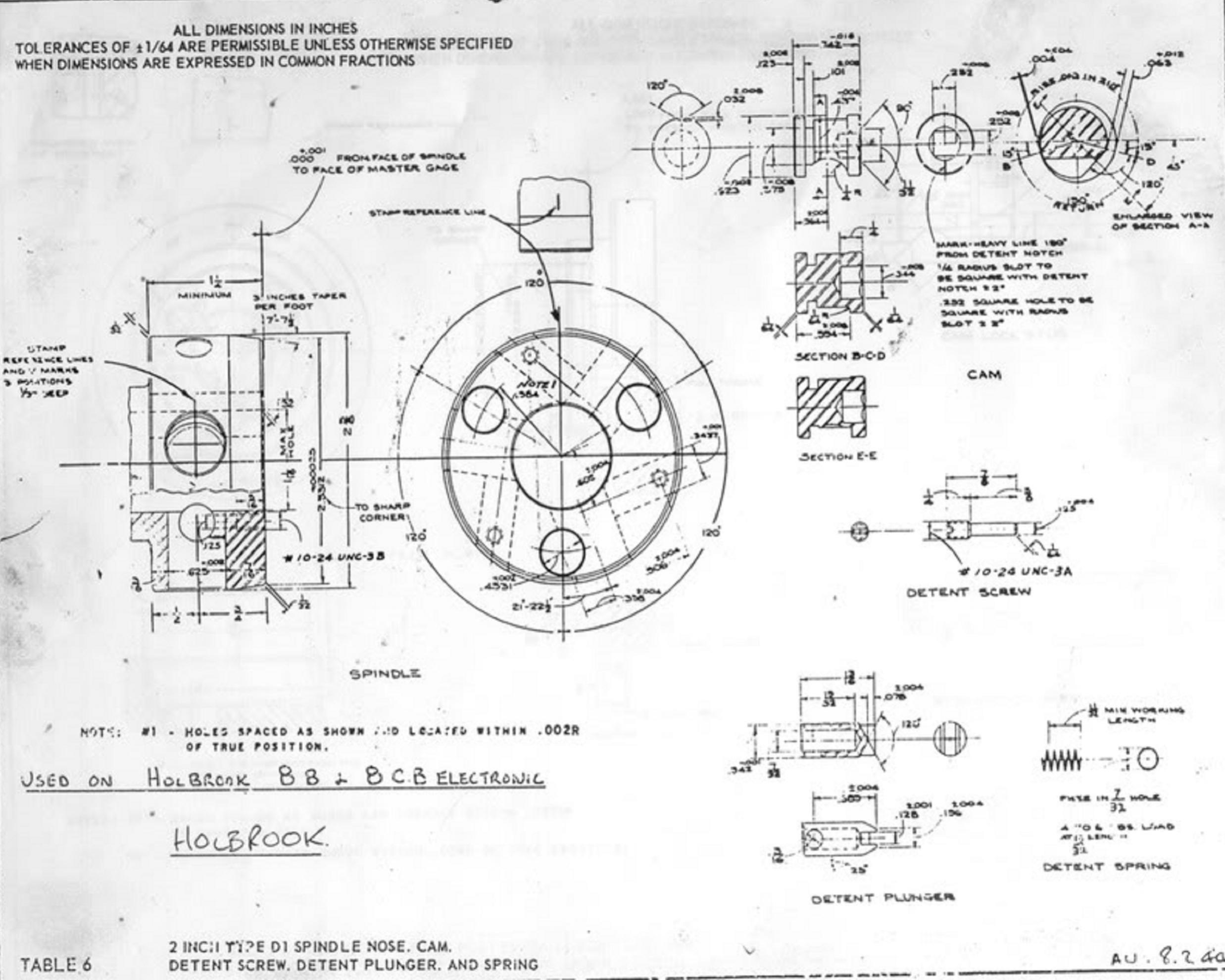

    Hi, would you have an CAD or technical drawing of the tool ?
    on mij schaublin 102VM I have an D1/4 camlock nose so i have already the chuck and so
    thanks in advance

    Thank you for your interest. I have an original D1-4 drawing somewhere but it is a very poor copy. For the nosepiece, I used the main dimensions and had to adapt some to suit my needs. I will see if I can find the original drawing and post on here over the weekend.

    lodola235's Tools
    thankyou very much

    Hi Bart
    This is the drawing I used not very easy to read but I managed to make out most of what I needed and made up the rest. Found it on the internet. If you need further help, do not hesitate to get in touch again.
