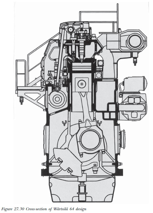

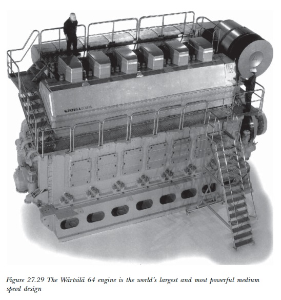

    For a bigger cylindrical square, you'ld have to go to the repair shipyards, perhaps finding a wrist pin from a Wärtsilä 64 or similar:
    That beast cranks out just over 2 MW (@ 333 rpm) per cylinder, which has 640 mm bore and 900 mm stroke.
    Guess that pin would land in the ~210 mm Ø x ~500 mm OAL range,
    which is a tad too big a bite for my mini lathe, and would cover about 30% of my surface plate.
