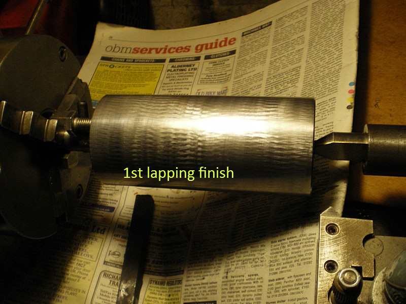

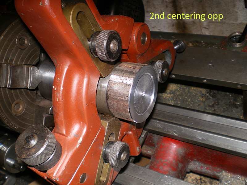

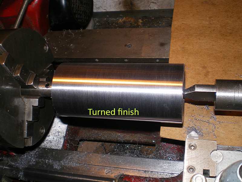

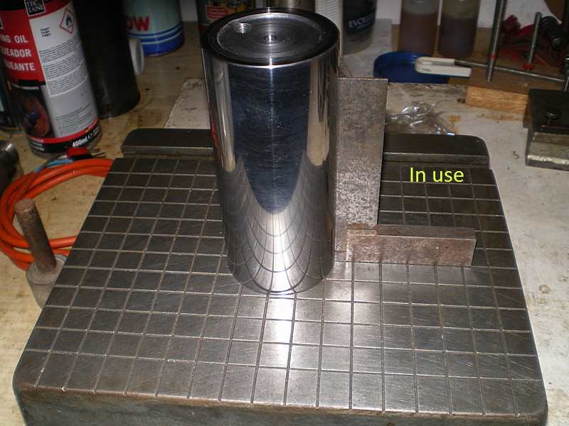

    I have never owned a cylinder square and at the price of commercial ones I decided to have a go at making one, at work we used to make our own for the shop table although they were case hardened and ground and strangely rarely used, when the factory closed I could have had one for the asking.
    I have a number of old squares which I have been having doubts with and so need need checking apart from its use for machined items.
    It is not that difficult to make your own cylinder square for home use say 2" x 5", accurate turning and facing between dead centres with a lapped & polished finish would suffice. With careful use and a descent steel (mine is some pre hardened mystery steel) this is not a high wear item, just a reference point. The only wear would be on the faces which could be refaced if need be.
    I had to step back from the chrome like finish I had produced as the reflective effect made it difficult to use. With a 2-3 mike it is within 2 tenths on dia end for end, good enough for me.
    Well after checking all my squares they are NBG so they will go to my carpentry box and I will buy a couple of good quality ones, at least I now know for sure.

    Olderdan, what is the process to lapp a cylinder held between centers? I see a rectangular bar in the photo on the protective newspaper.
    You are talking about my new secret weapon for lapping and polishing, I will show it in a new post. BTW what looks like a rectangular bar is just a strip of impregnated leather for final polishing.

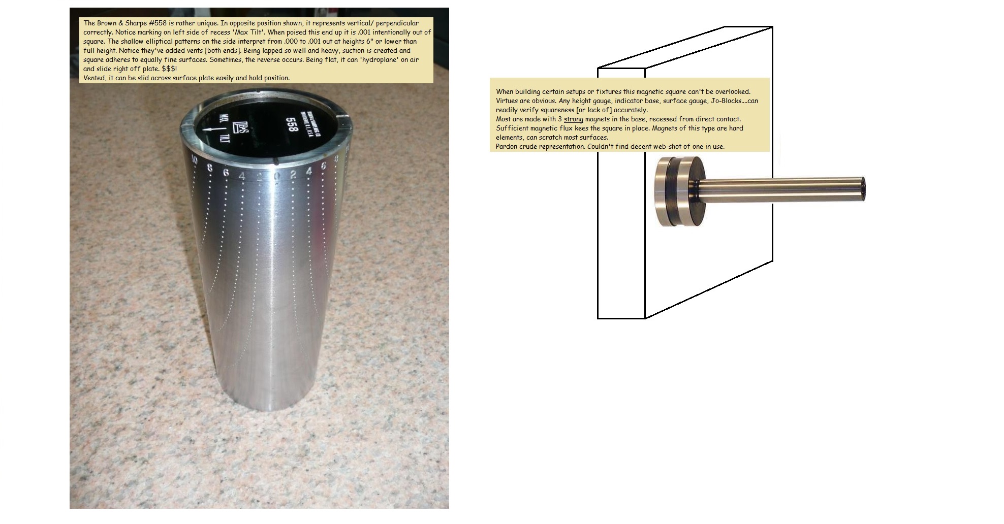

    Cylinder squares are a convenience, occasional necessity. I'll shamefully admit mine are commercial. But here are a couple unfamiliar to some HMT readers. And best of all, one's not difficult DIY project.
    Other materials can be used, for a basic cylinder square. Heavy wall tubing, one end recessed with a plug welded shut can be re-faced on a lathe. Handled with care, it's not hardened state is not too much handicap.
    Engine piston wrist pins; typical in diesel engines, are dimensionally stable material. Even used can be in good condition. If you are so equipped, regrinding is possible.
    Just consider squareness and as true a cylinder possible are the requirements.

    I'm curious how you got that mirror finish.
    As you indicated the leather strap is charged, you're probably using it like a strip of emery cloth sand paper.
    So I'm interested in your describing this process, and what lapping grit is needed to get that mirror finish.
